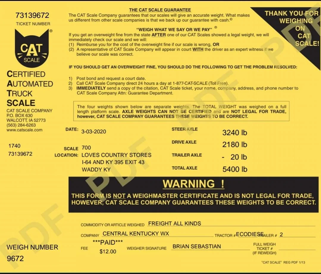

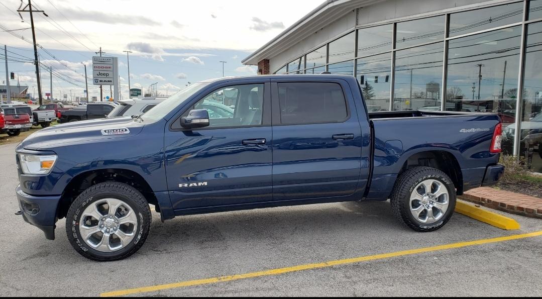

Here's what's wild:
I took a well optioned Ram EcoDiesel crew cab 4x4 across the scales today. It was 5,420 lbs. with no occupants and only a small amount of personal items inside.
With the JT Rubicon clocking in at 5,100 lbs. already, that would seem to indicate that FCA's midsize diesel truck will weigh more than their full size with the same engine.
Weird.
The lift kits will be stiff I'm guessing. How will a diesel Jeep be as flexible offroad?

Here's what's wild:
Weird.
Nice truck BTW. That`s one reason the Gladiator diesel will have a low tow rating.
