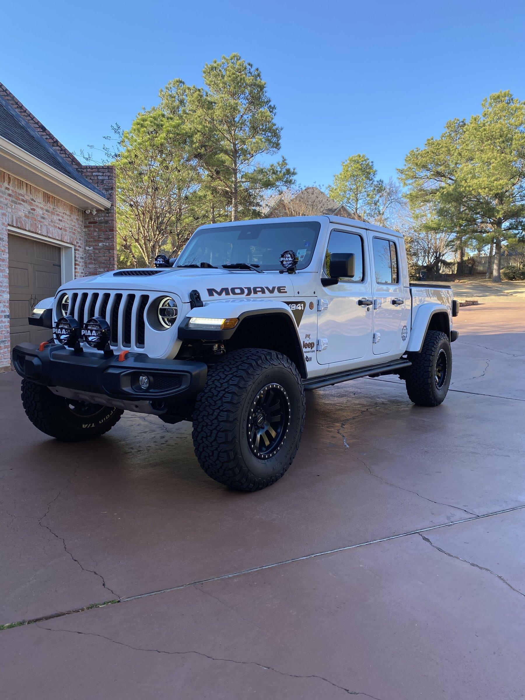

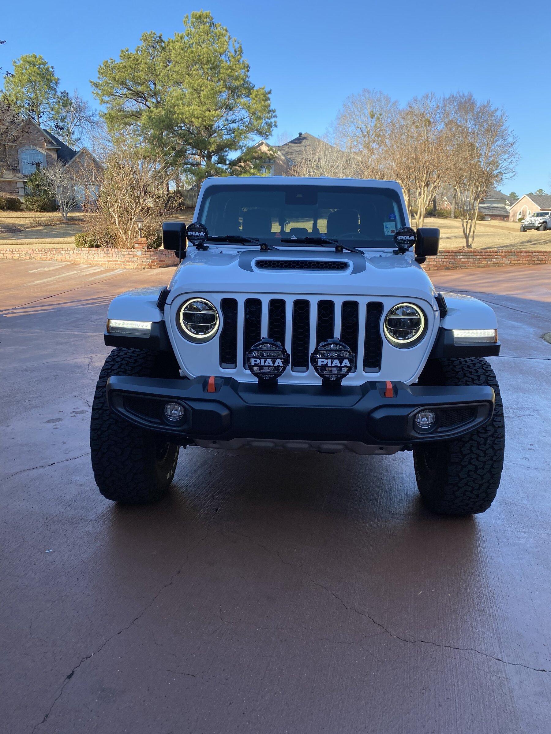

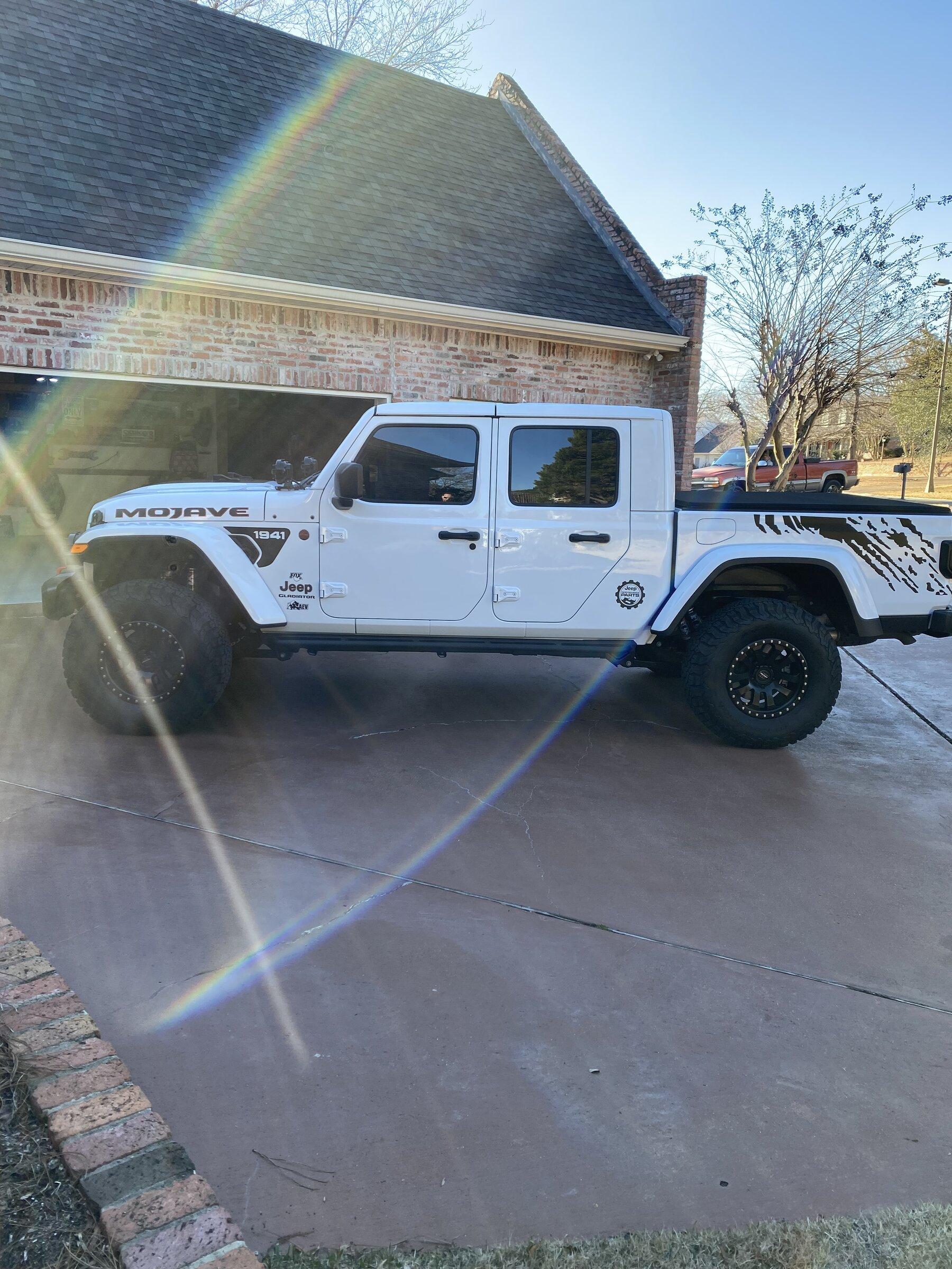

I have a 2021 Mojave and just installed the AEV lift a week ago. I love it! The ride did not change any, just as smooth. The look was exactly what I was after.
How did you find one? Lol. They’re always sold out!

I bought it on Amazon. It was the last one and it was shipped from AEV. I did the correction brackets also.
35’s? Looks great! If that’s 35’s what’s your height to the top of your roof? Curious because my garage.
