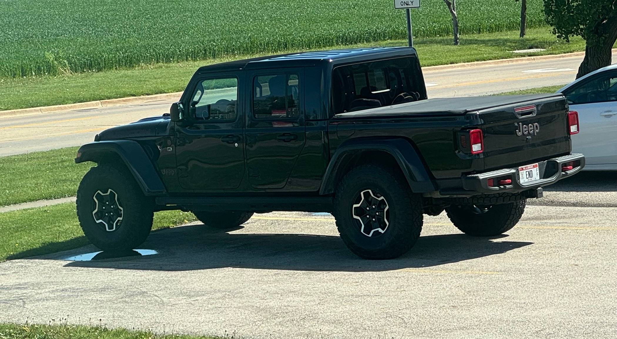

Hi All - I just replaced my tires on my JTR with Nitto Recon Grapplers sized at 37x11.5r17 on the factory Rubicon wheels. I chose to keep the wheels and go with 11.5 because I didn’t want much if any poke since I drive a lot of gravel/rocky roads. I expected some rubbing and wanted to see how much before deciding on a level kit or lift.
I am getting a little inner fender rubbing on the driver side when turned hard left after adjusting the steering stops. The rubbing is at the back, bottom of the fender liner.
I’m now wondering if the level or lift will be enough or if I need to look at either wheels with different back spacing or spacers. I would prefer to keep the tires as tucked as possible. Does anyone have experience with a similar combo or thoughts?

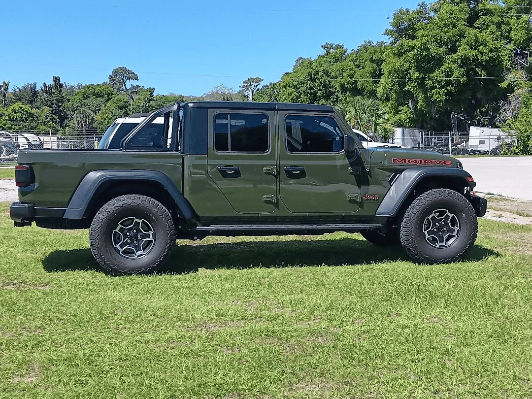

37x12.50x17 with the same wheels you have. No lift. I had the same rubbing on the back of the front inner fender liner. I added two washers to the steering stops on each side and trimmed the liner a little. I don't have any rubbing now and even with 12.50 tires my "poke" is minimal. It can be done

Good call on the trimming. Made a small cut and no more rubbing on road. I still need a lift for off-road but, this buys me some time.

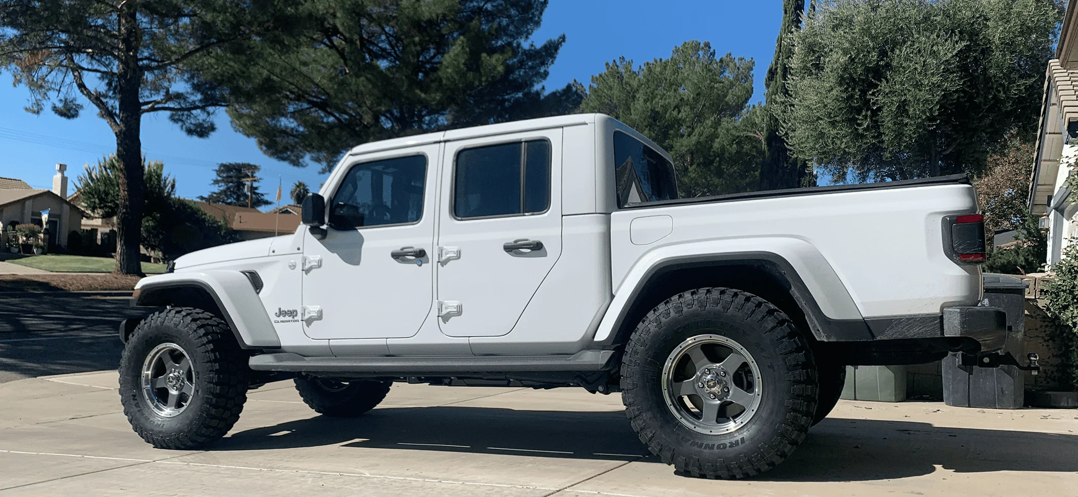

I used the 2 inch Mopar springs calibrated for a steel bumper. And put three-quarter inch spacers on the rear. I’m running 35s. But my jeep sits level and I bet 37s would fit under it.
