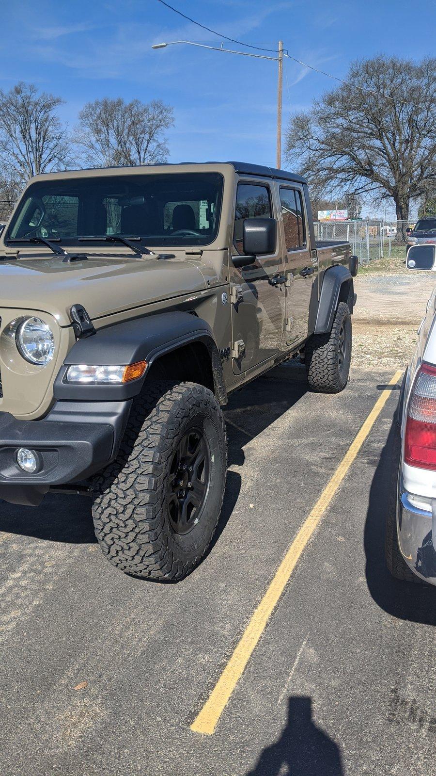

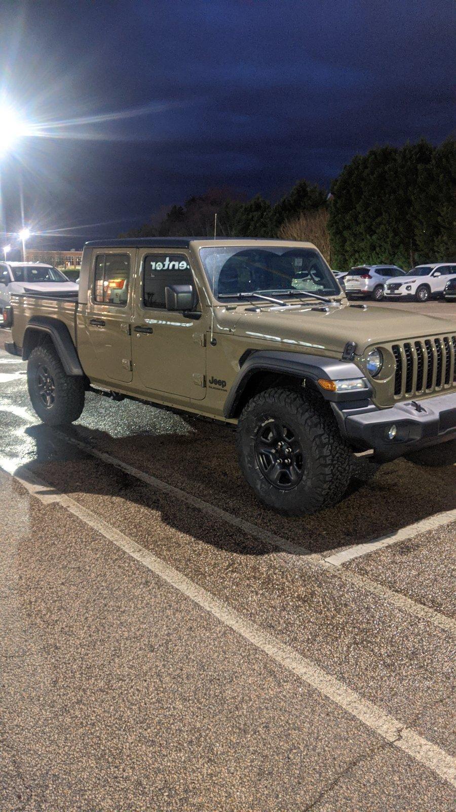

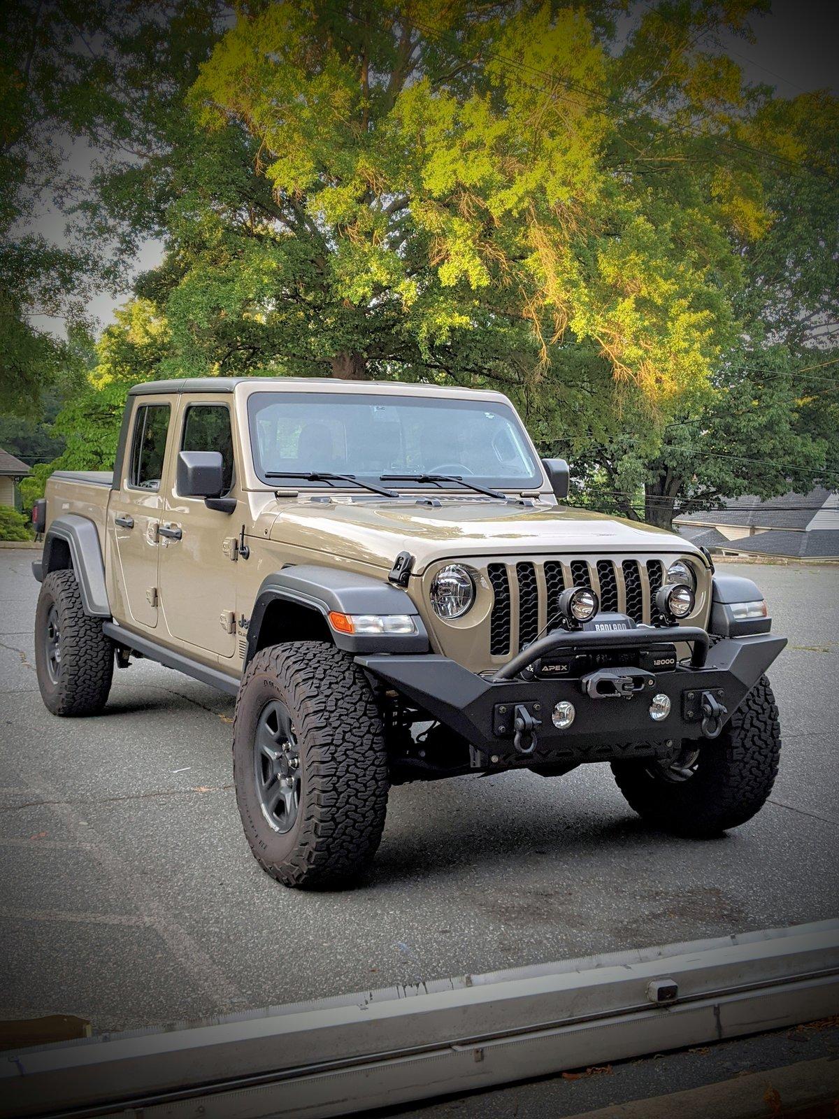

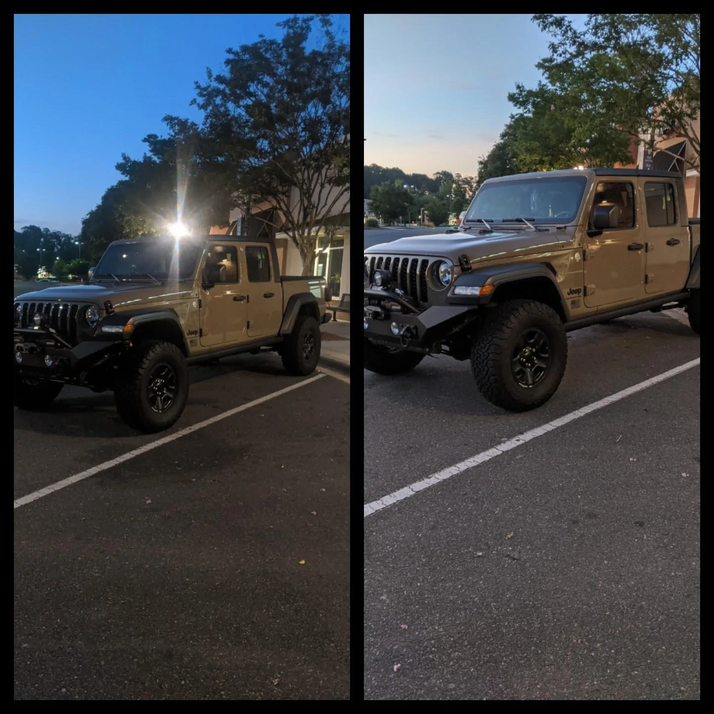

You can run that setup. I have the ReadyLift SST 2.5" on my Max tow with 315 70 17 BFG KO2S and I love the look and how it rides. You will be fine with that size tire. Mine are basically a 35 and I'll be going to 37's when these wear out. I also added Rubicon take off front springs and shocks as well. Here is a picture of it with just the ReadyLift and then with the Rubicon take offs installed
Just ReadyLift
Jeep Gladiator Lift/tire rec’s-2021 Gladiator 00000IMG_00000_BURST20200704070254346_COVER
With the Rubicons take offs and ReadyLift
Jeep Gladiator Lift/tire rec’s-2021 Gladiator IMG_20200808_071524
Side by side of both
Jeep Gladiator Lift/tire rec’s-2021 Gladiator IMG_2020-08-02_06-14-59.JPG

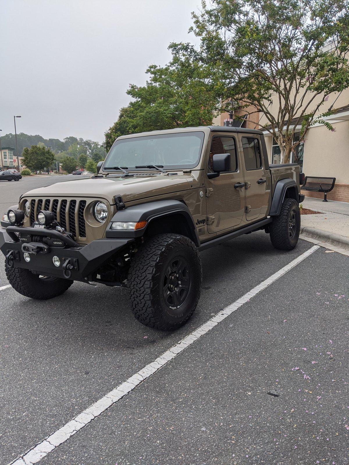

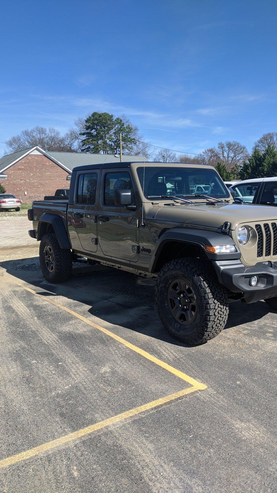

Bumpers front and rear came after. Here it is sitting stock with the 315 17 70 KO2s installed and then with the 2.5" ReadyLift installed. The only thing you will need to do is trim around the air dam in the front. That may or may not apply to you because I think the tire your asking about is not as tall as mine are.
Stock
Jeep Gladiator Lift/tire rec’s-2021 Gladiator IMG_20200213_183121
Jeep Gladiator Lift/tire rec’s-2021 Gladiator IMG_20200213_183207
With the 2.5 ReadyLift installed
Jeep Gladiator Lift/tire rec’s-2021 Gladiator MVIMG_20200215_113302
Jeep Gladiator Lift/tire rec’s-2021 Gladiator MVIMG_20200215_113311

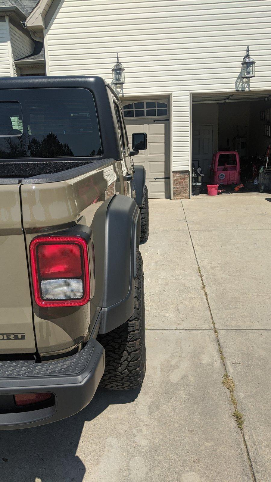

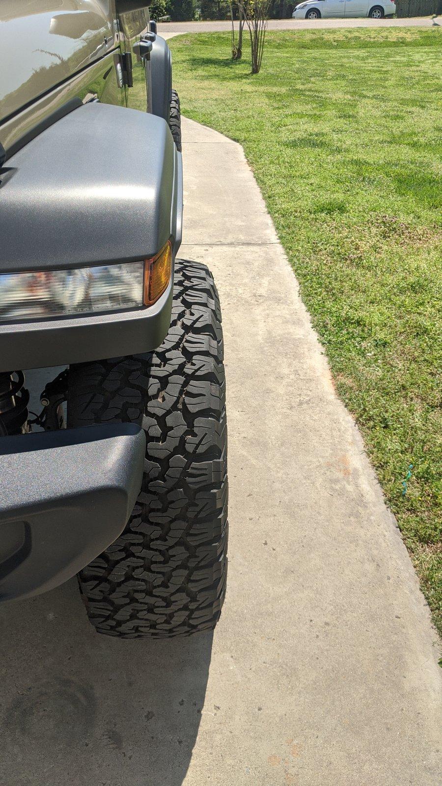

I have 1.75" wheel spacers on mine. I'll show you before the wheel spacers and after.
Before wheel spacers
Jeep Gladiator Lift/tire rec’s-2021 Gladiator IMG_20200411_125913
After
Jeep Gladiator Lift/tire rec’s-2021 Gladiator IMG_20200411_143736
