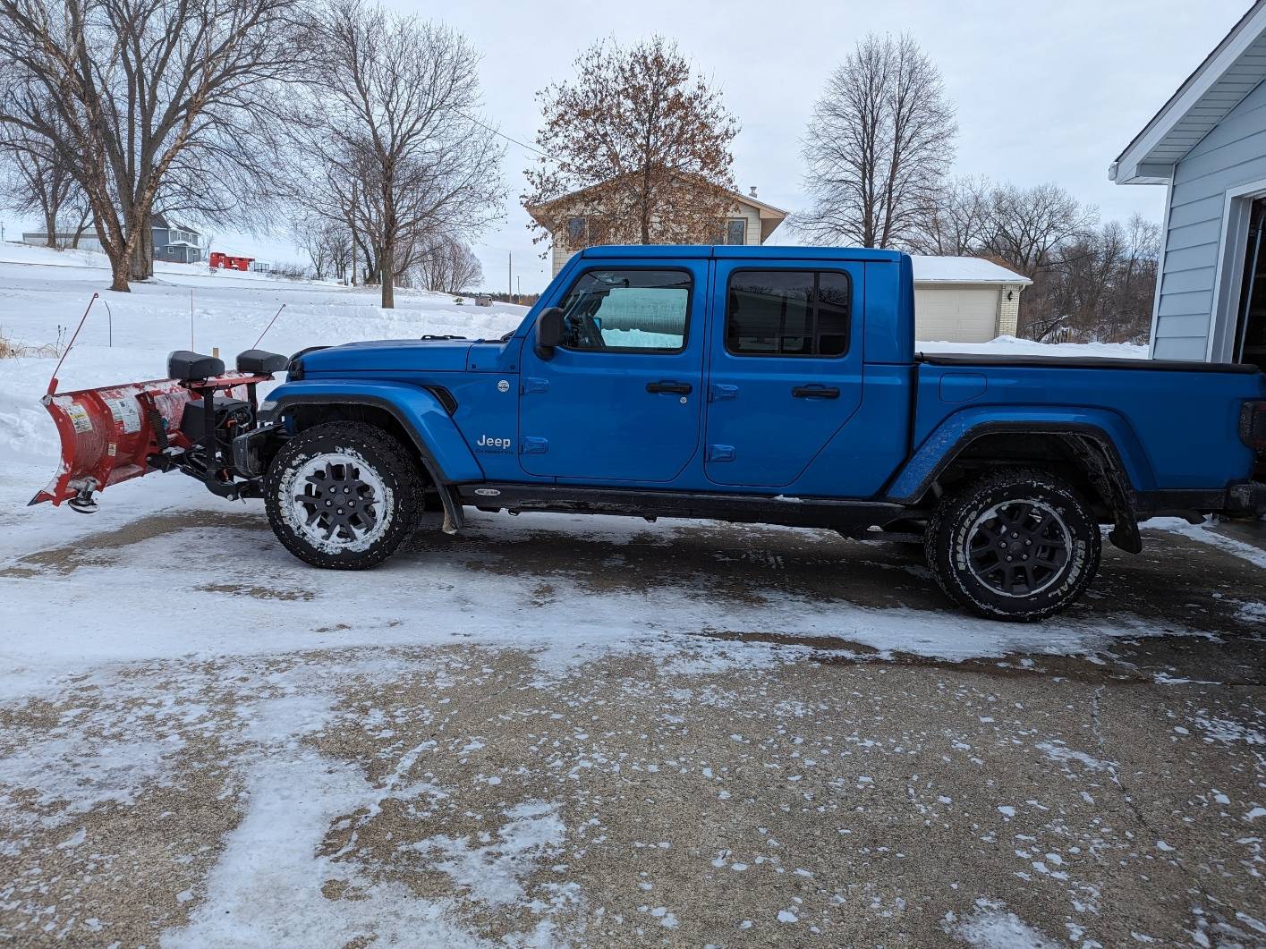

Also - full disclosure - I put a snow plow on in the winter and the Synergy springs handle the weight better, along with giving me a bit more clearance because all of the stuff up front is a big drag in the snow!
Living in rural Iowa, I figure even 1" is a help. Heck, I drove my 84 Eagle through many unplowed roads when I lived up near Clear Lake/Mason City area. We'd get real snows up there. The one and only time I got that thing stopped was when I was messing around in the yard north of our big barn. The snow was deep, tall drifts. The wind and temperature changes had made a bit of a crust on the snow and I could drive over or through it fine with that car............. until I took a tall drift too slowly and went up on top of it.......... and felt this "uh-oh" feeling as the wheels settled in the snow and I was high-centered on the skid plates and floor pan. A shovel took care of that. Drove the car back out after 10-15 minutes clearing snow under it.
If that Eagle could do it, your Jeep can do it - with good tires rated for winter. That's why I put the General tires I have on mine (had them on the 2020 and moved them to the 2022 when I traded Gladiators). They are great in Iowa snows and not bad on ice. I can shove many hundreds of pounds of snow up our steep driveway without a lot of trouble.
The more I think about it - the more I wonder if your issue wouldn't be resolved with better tires and a slight lift of about 1". If I can shove a 72" path up our driveway, you should be able to drive through some crazy snows.

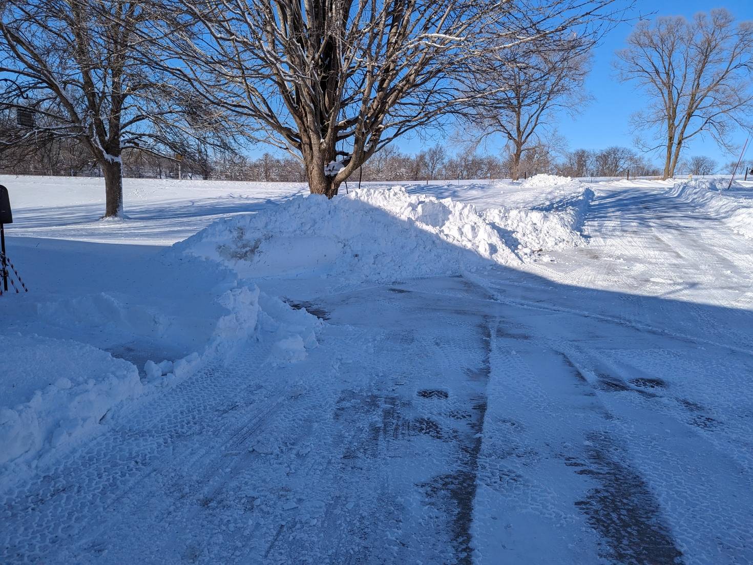

Talking about smacking snow - I've got enough low hanging stuff there in the winter, but it causes me no problems at all.

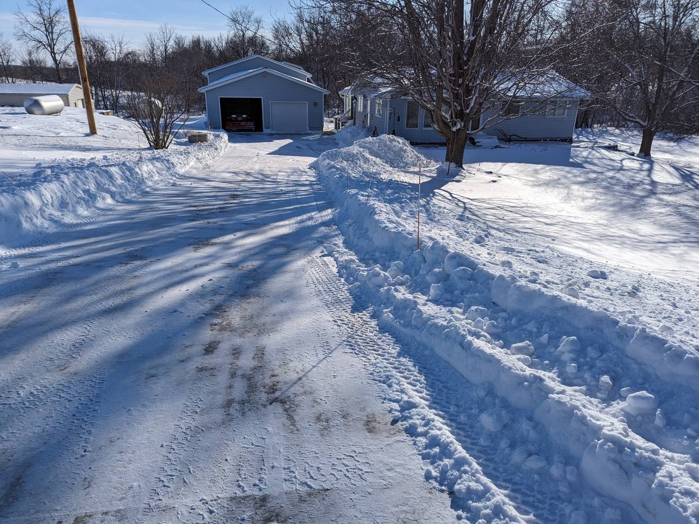

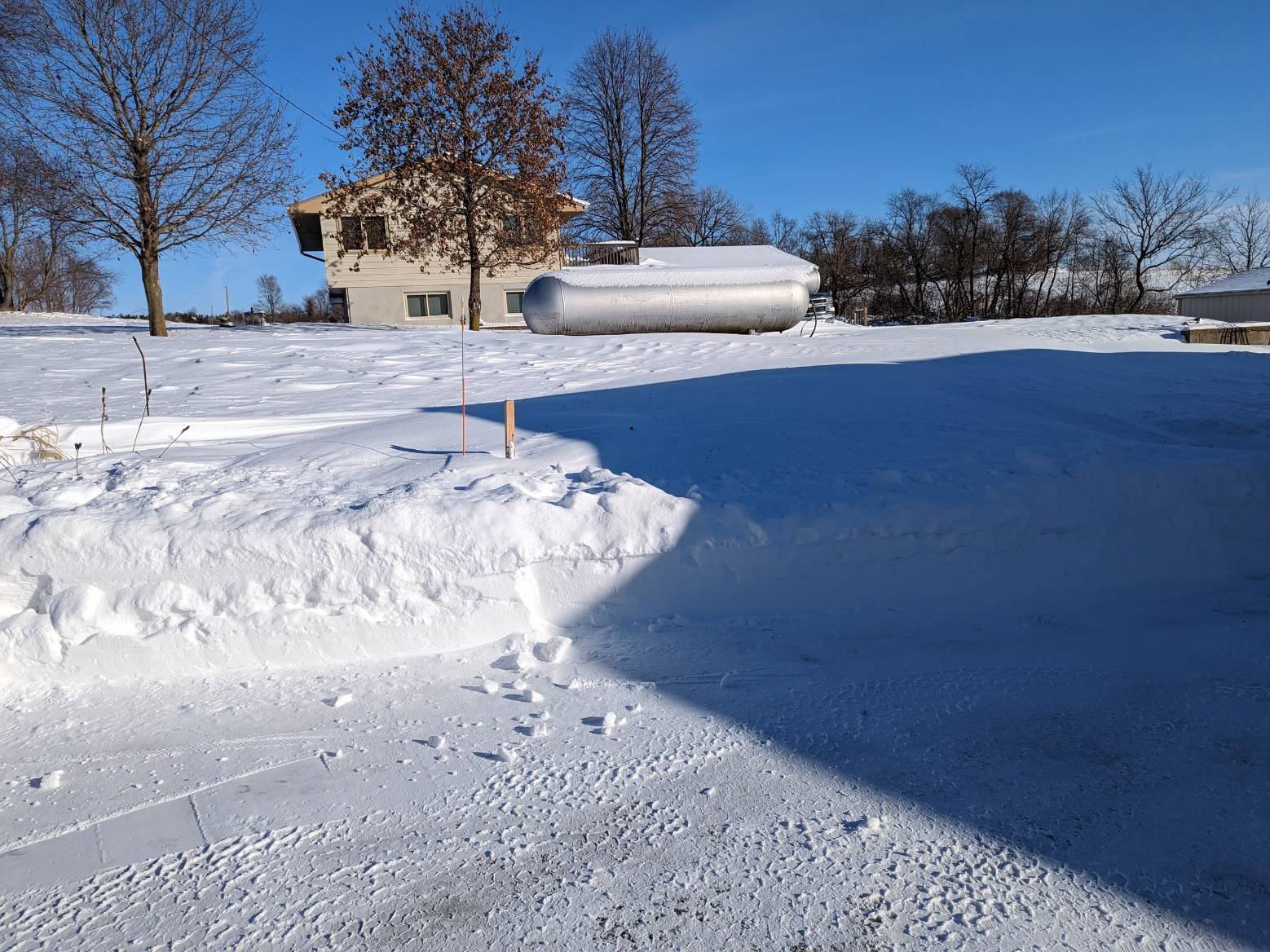

And I have to push it all UP-hill!
Note almost no signs of slippage in those tire tracks.
