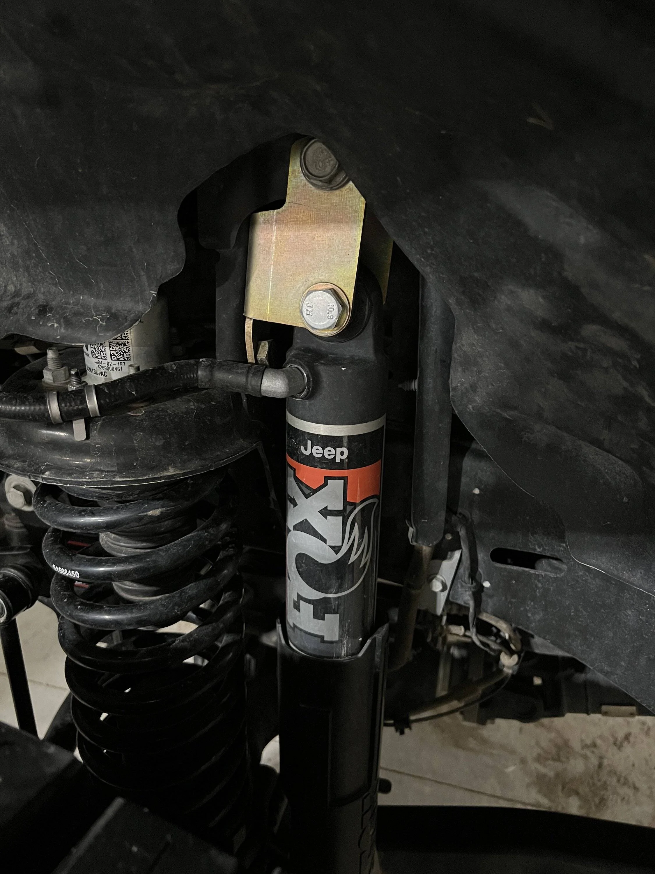

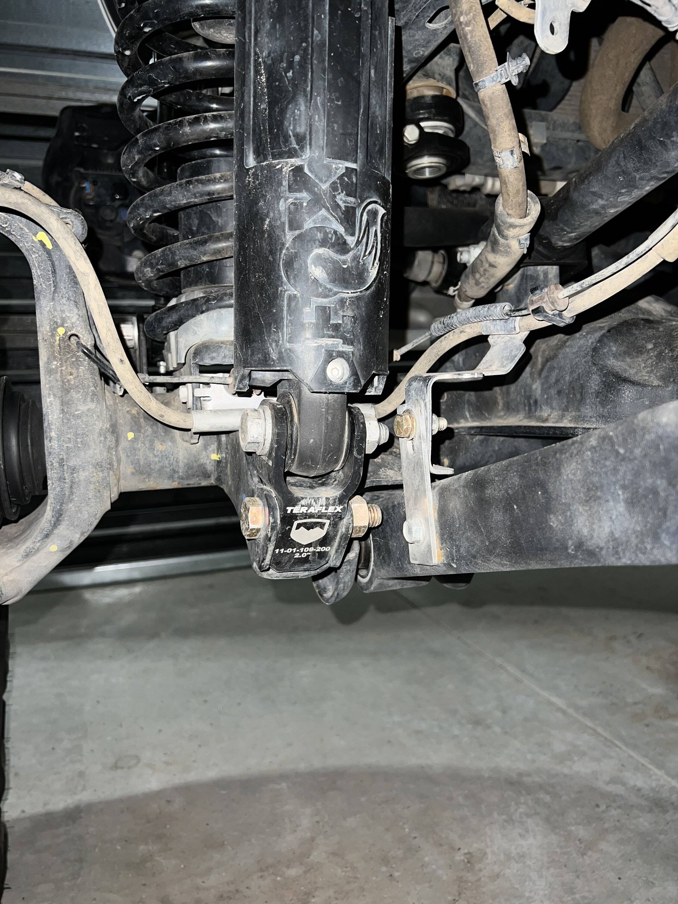

Jumping in here as the one who measured out those Mojave shock specs quoted above.
MetalCloak actually makes that 3” front upper shock extension specific to the Mojave now, so it bolts right up no customization needed. I used them on my Mojave and they’re not expensive.
For front lower shock extensions I used Teraflex 2”. The Mojave lower shock bolts like you said are M14, so I used a 9/16” drill bit to enlarge the lower extension’s holes. It’s just aluminum so it’s an easy drill.
I extended the rear shocks just 2.5” using Evo’s lower rear extensions, although the fitment on these was terrible so I don’t recommend them. No drilling necessary in the rear though.
I felt this extension setup was worth it at ~$250 to keep the OEM Mojave shocks until they start feeling sloppy and then I’ll upgrade.
Front upper MetalCloak/lower Teraflex pics:
Jeep Gladiator Lifting a Mojave 3+ inches and retaining the factory shocks? D954BF87-07F3-4C9E-A96D-A3C913BAEE4F
Jeep Gladiator Lifting a Mojave 3+ inches and retaining the factory shocks? D764F6E7-54BA-4796-A84C-20F15730B9EC

@outdoor.adventures, why 5" total of shock extension in the front? You have 5" of lift in the front?
yeah, the Clayton 3.5” lift provides about 4.5” in the front (they measure 3.5” lift in the rear for the kit) plus I have a leveling spacer. Sorry, should have included that info.
