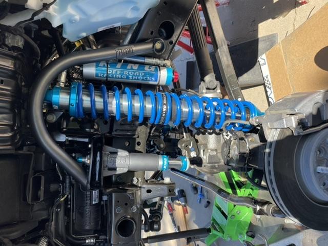

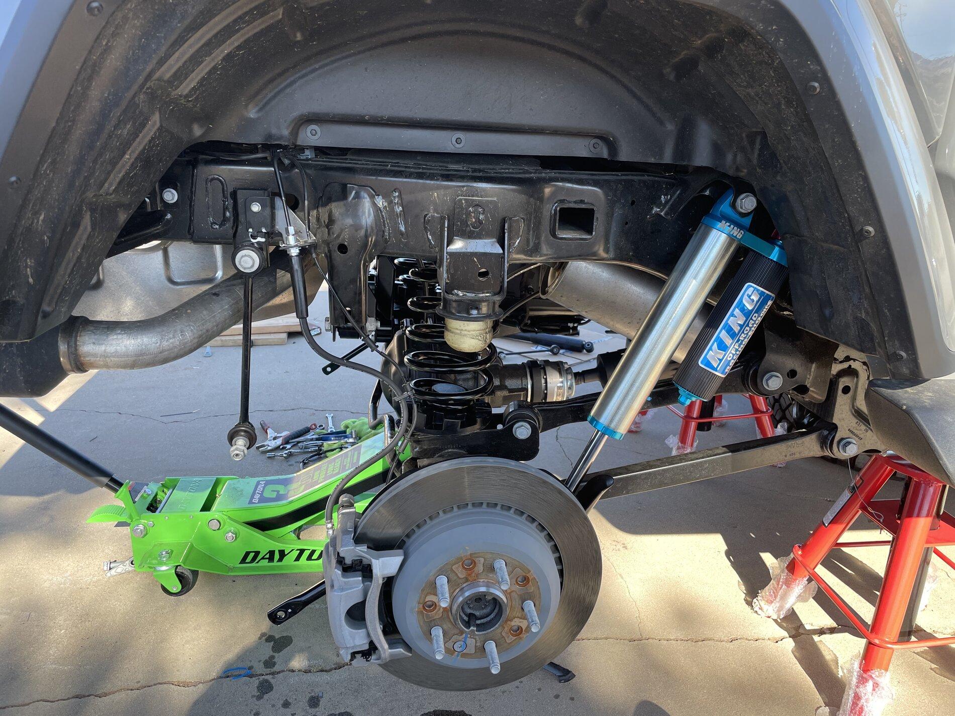

There are some differences
Gas tank is on the opposite side of the gas version.
Theres also part of the exhaust that makes it really difficult to change out the passenger upper control arm bolt.

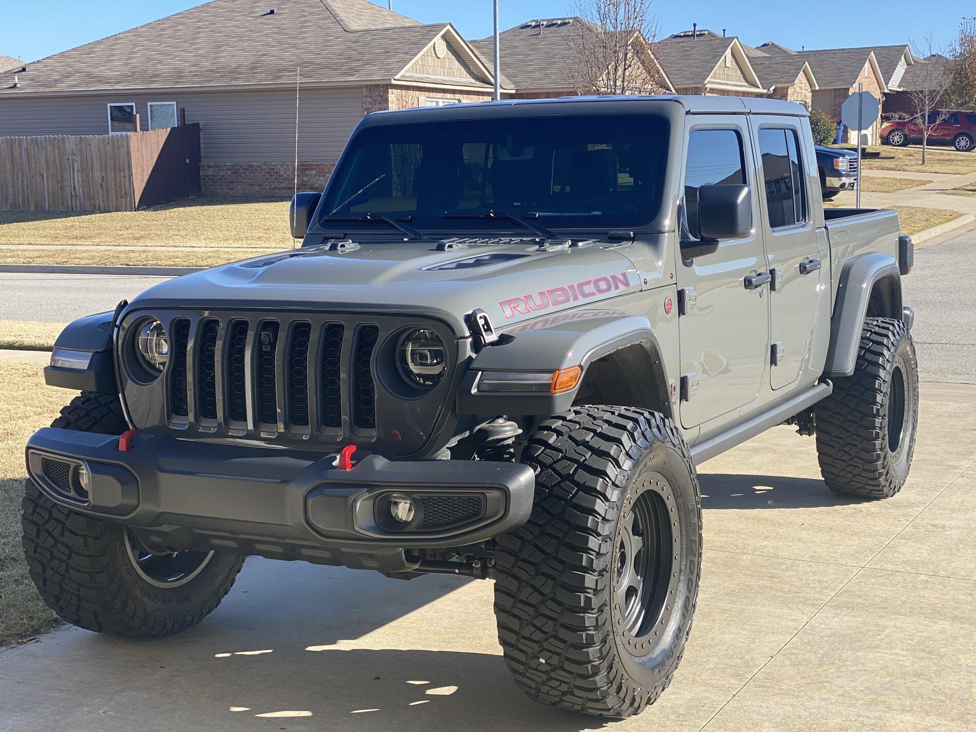

just installed a rebel off road coilover kit
On my sisters diesel
Jeep Gladiator Lifts for ecodiesel 4F610890-0ADD-4750-ABAF-8A6974FC1185
Jeep Gladiator Lifts for ecodiesel AE608250-EFA6-4EF7-8B31-C5AD6F30280A

Which Rebel kit did you install? That looks great! Any other feedback on the kit?
