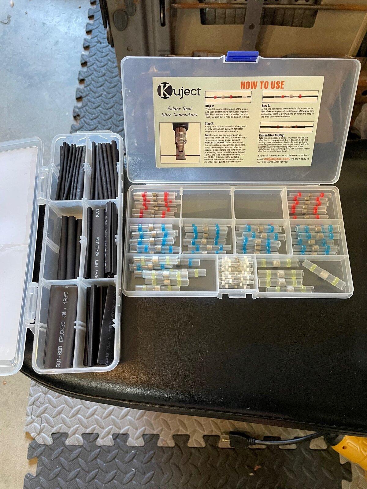

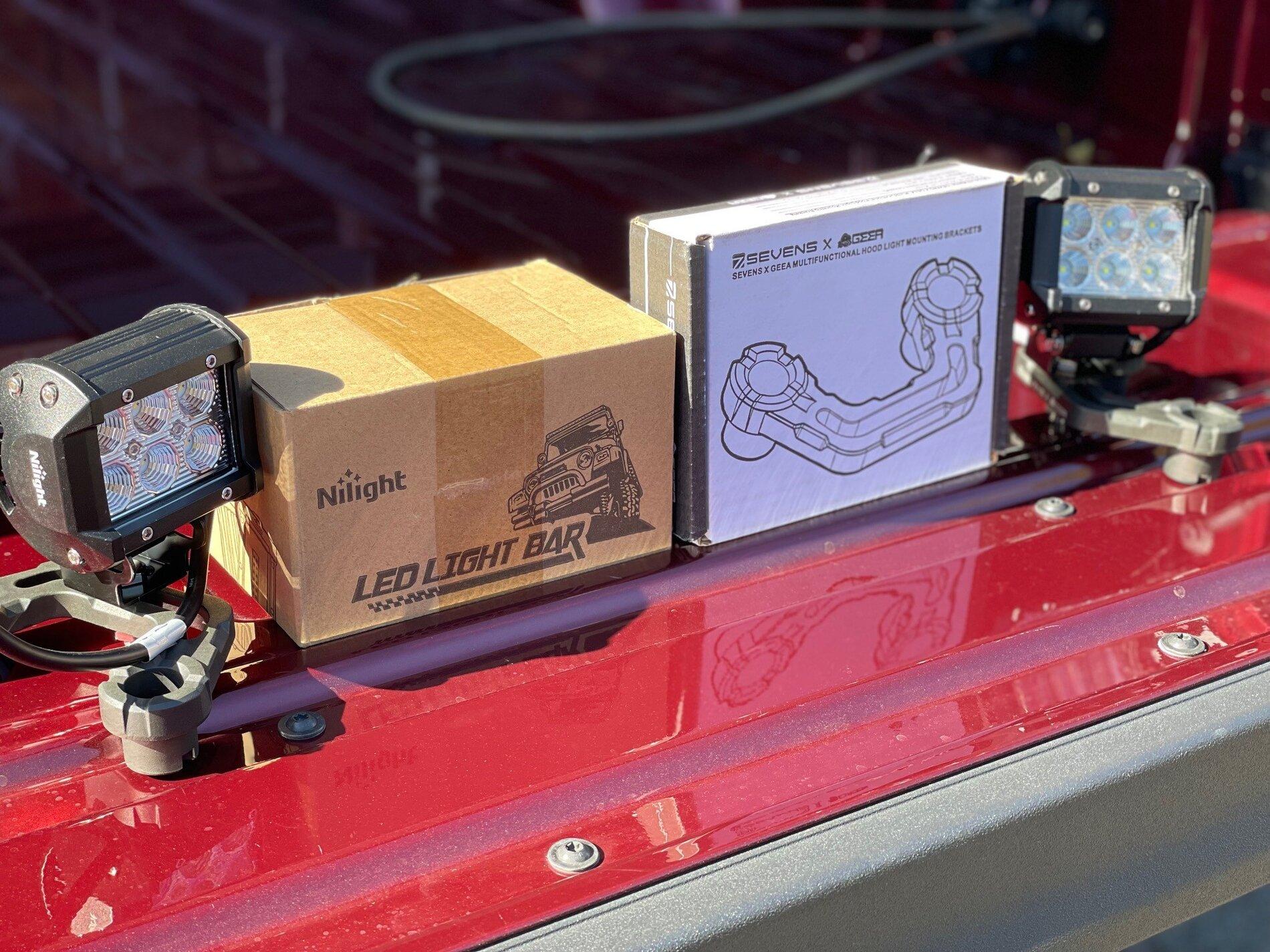

This past weekend I got and installed Nilight LED lights and SEVEN X hood light mounts. This all cost me less than $60 and took less than an hour to install. I used Kuject solder seal connectors, some shrink tubing, and fabric electrical tape to match the factory stuff..
Jeep Gladiator Light bar install Lights and mounts
Jeep Gladiator Light bar install wire splicin

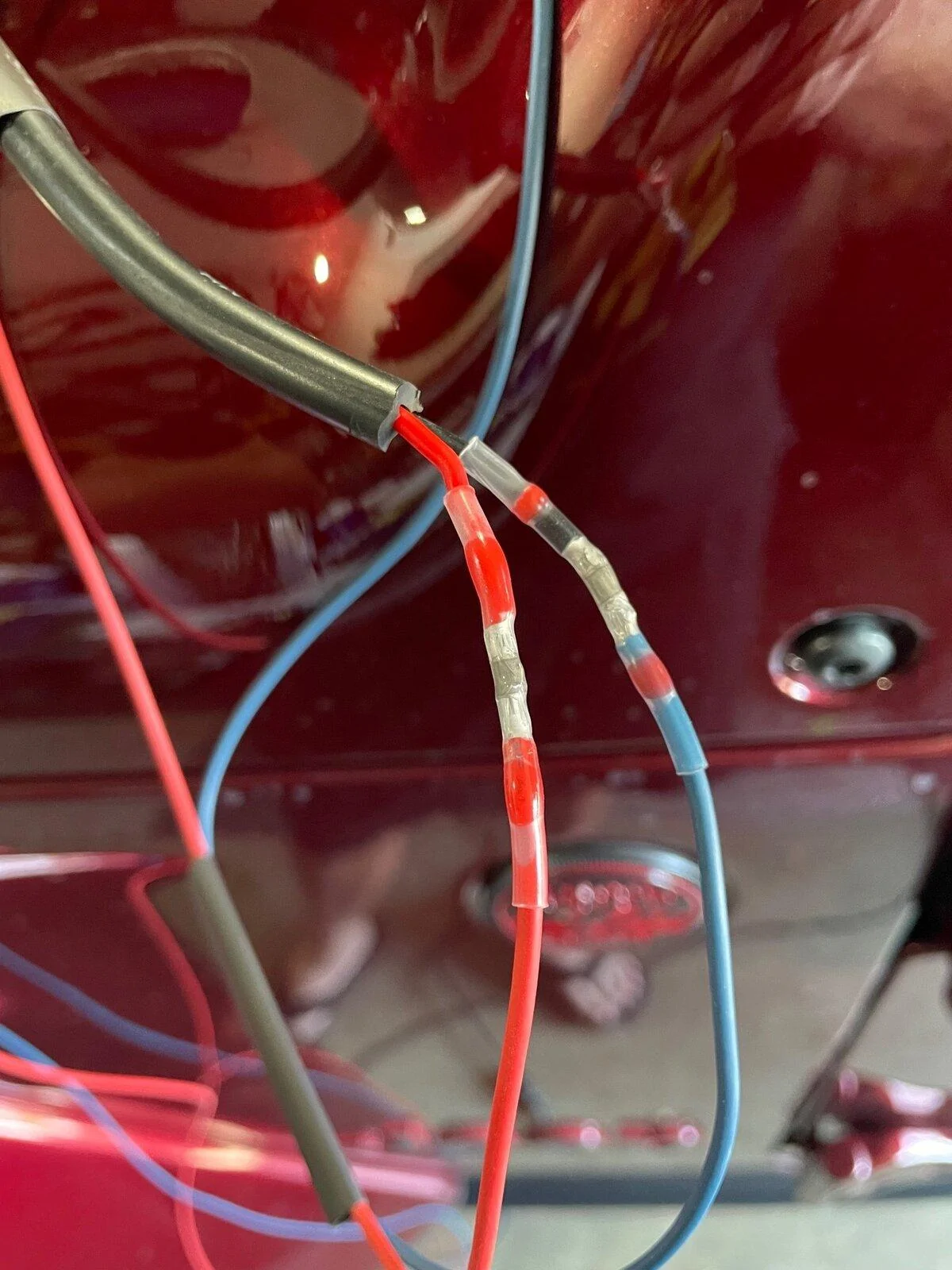

The solder joint are really nice. You just use a heat gun. The ends fuse to wire sheath to create a watertight seal then the metal inside melts to solder the wires together. Then i just covered them up with shrink tubing to his the joint.
Jeep Gladiator Light bar install solder joints

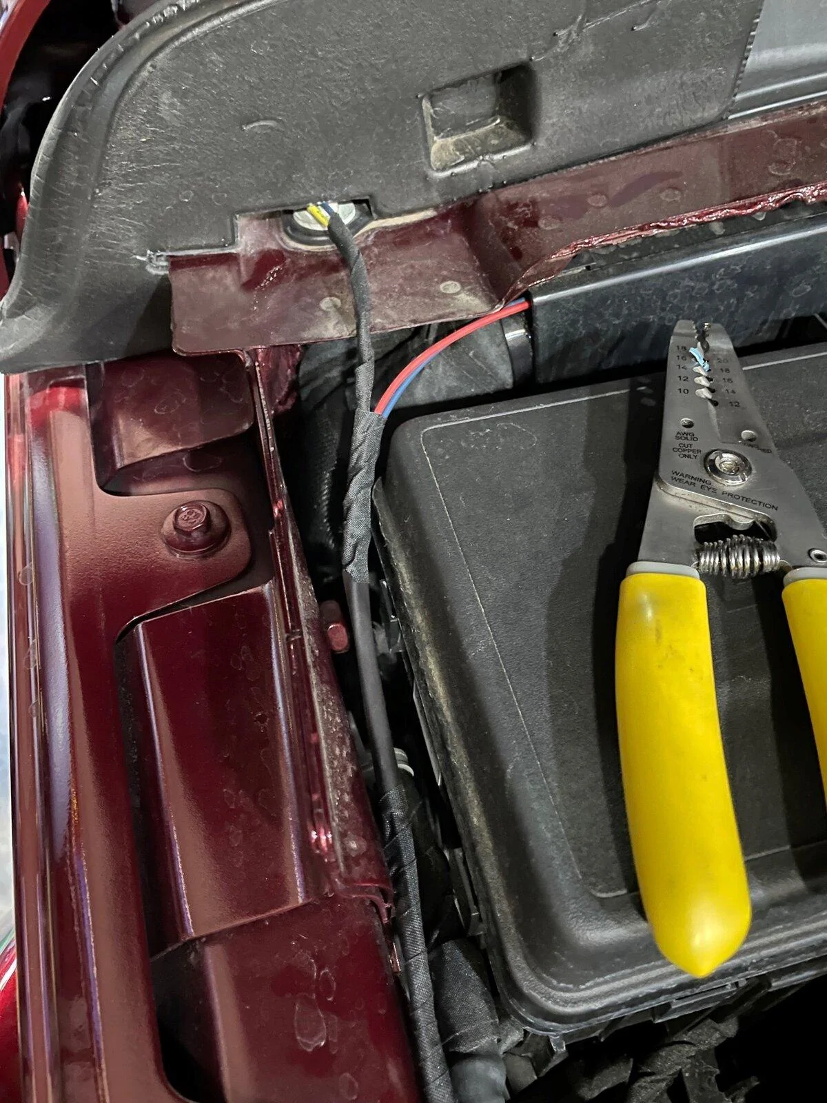

I used a wire fish rod to pull the driver side light wires through the channel.
Jeep Gladiator Light bar install fab ta

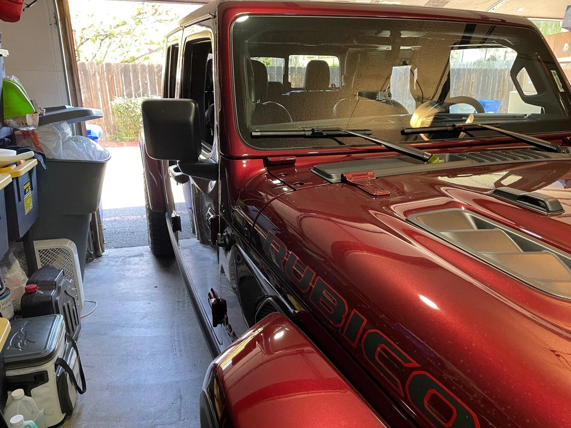

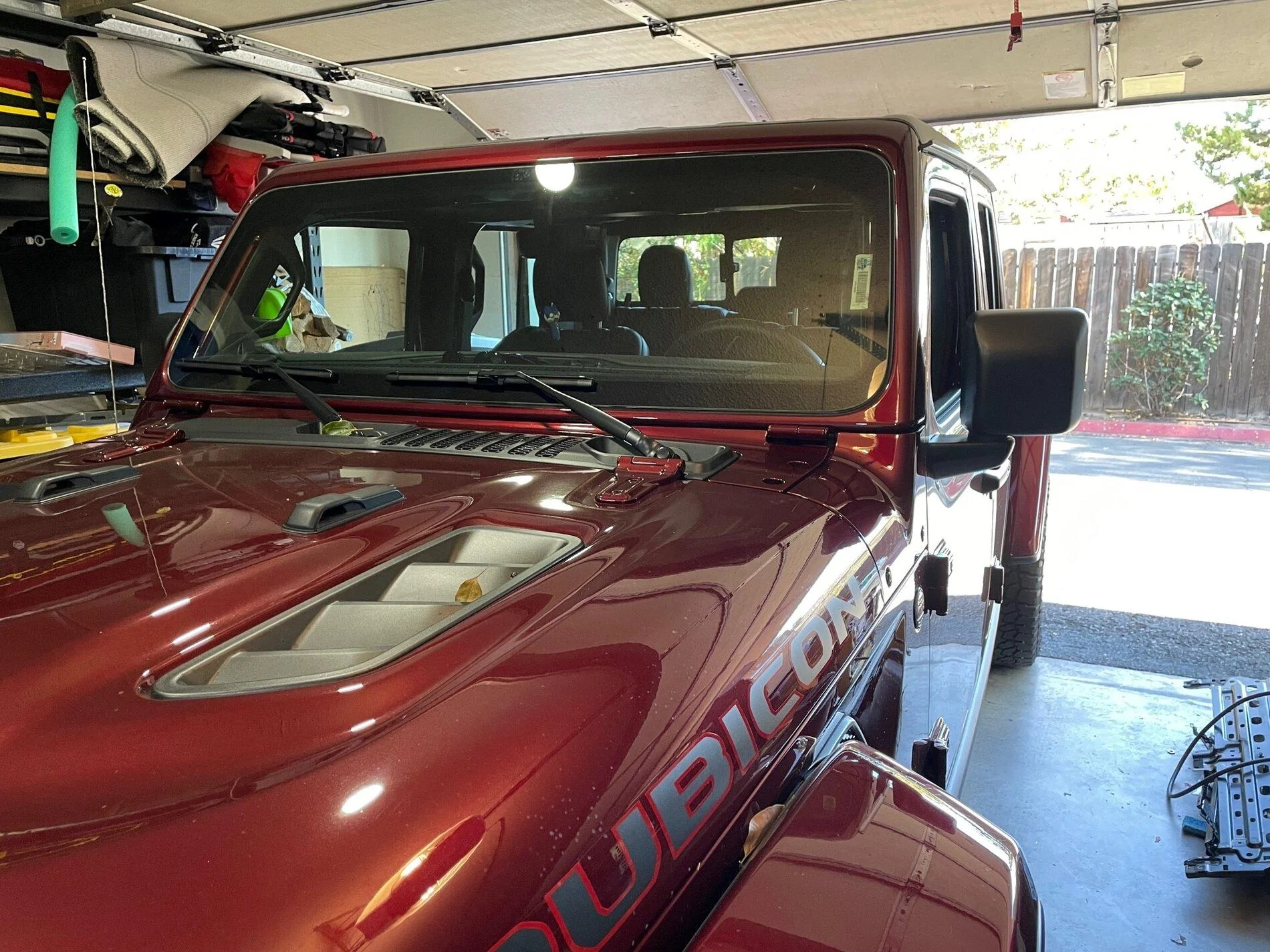

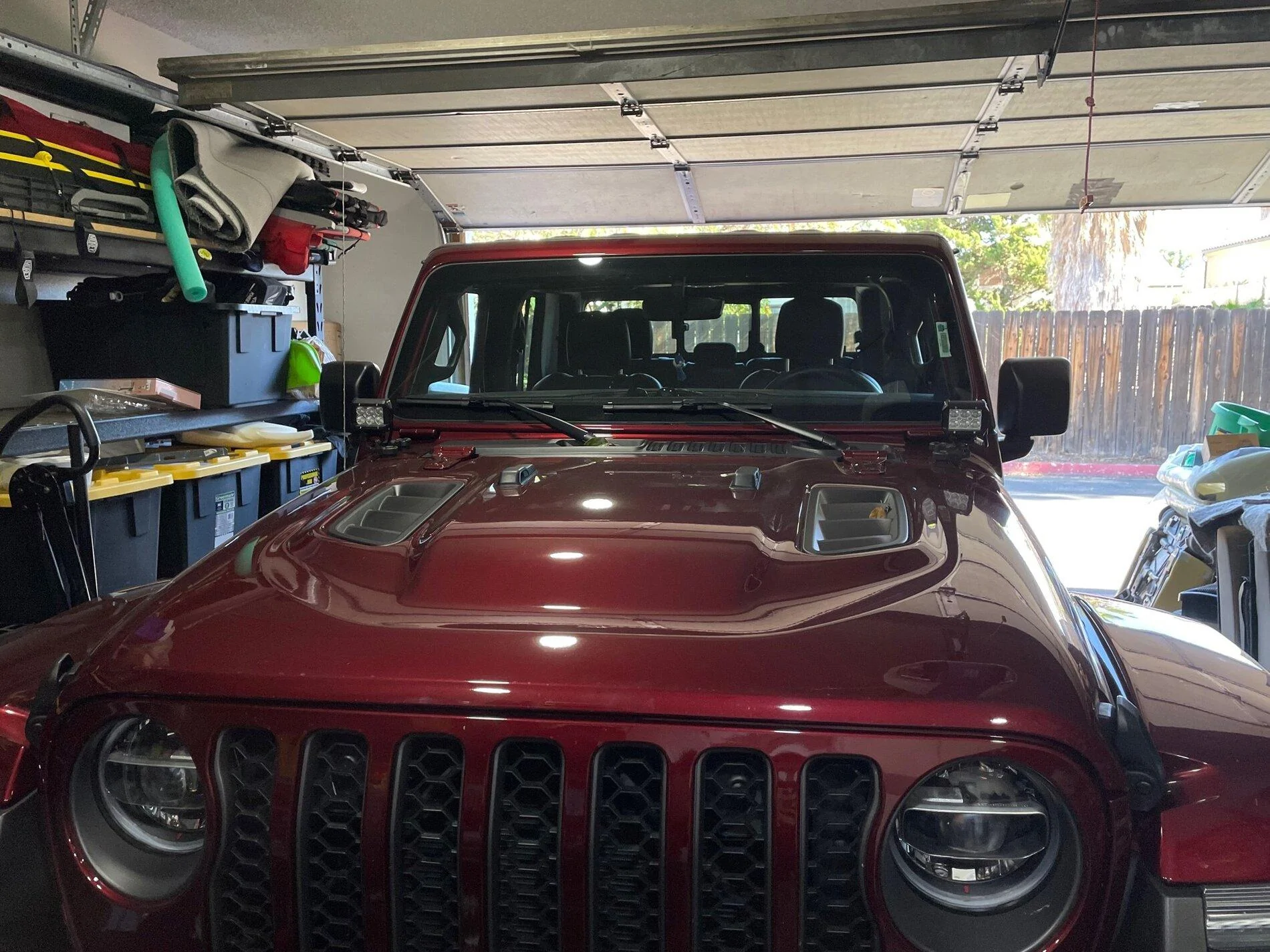

All in all a very easy project if you have the factory aux block. here is the before and after.
Jeep Gladiator Light bar install before right
Jeep Gladiator Light bar install before left
Jeep Gladiator Light bar install full front

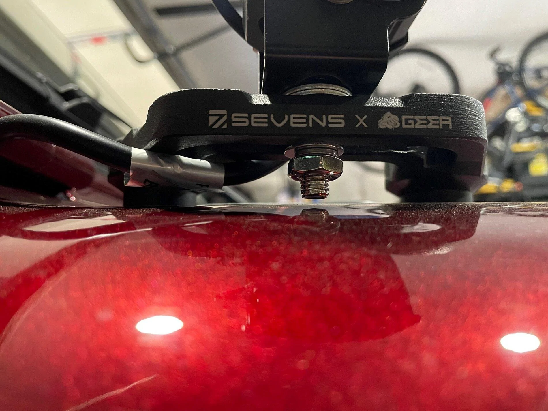

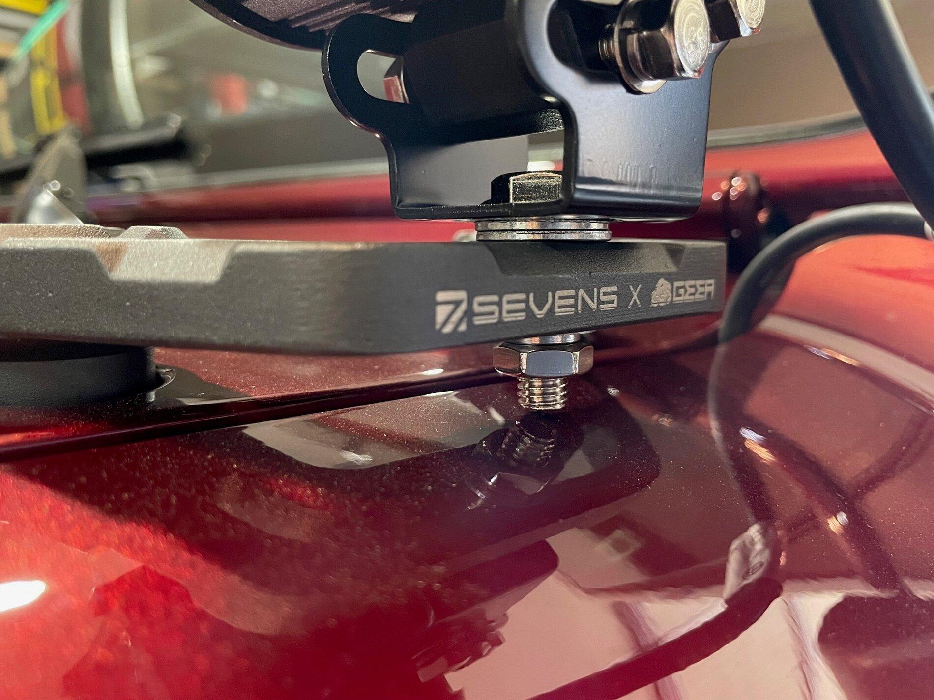

One thing i had to do was add a couple washers to clearance the lights and keep them off the body parts.. The lights really are not that bright but really open up the sides in the dark. I may upgrade them in the future to a higher LUMEN but for the price and the time it took i am happy with the outcome.
Jeep Gladiator Light bar install shims
Jeep Gladiator Light bar install clearanc
