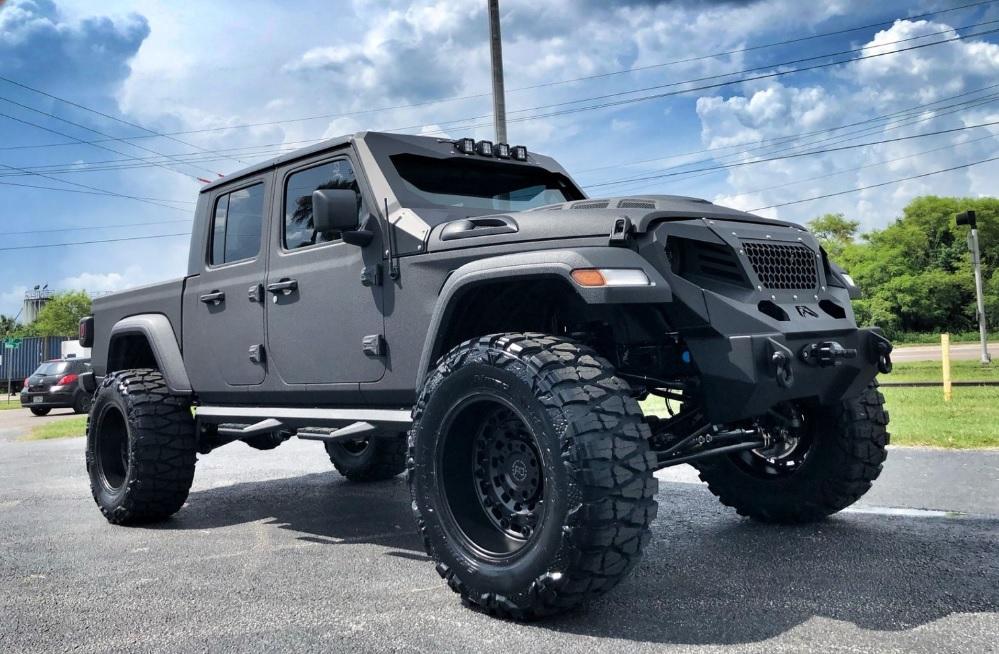

From my understanding the thickness for body panels is much less than that for the bedliner as such the weight should be much less per sq/ft. I have seem some images such as the one below
and IMHO they look amazing. Again not certain about the durability and maintenance of the paint job, but it does look menacing.

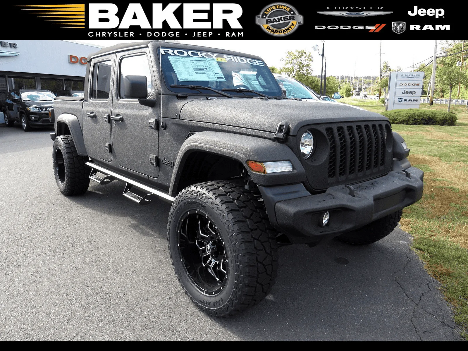

My local dealer is selling a "stealth coated" option as part of the Rocky Road package, looks very similar to line-x.

LMAO, so looking at the site there is no price and it says contact dealer. On the window sticker in 1 of the pictures it clearly says the truck is $44k. There is an add-on sticker to the right of that for the dealer and guess how much this package above costs? $17k! The truck is now $61k. Those wheels look terrible BTW. And why did they respray the bedliner? It's an added cost on the original window sticker. Wow...
