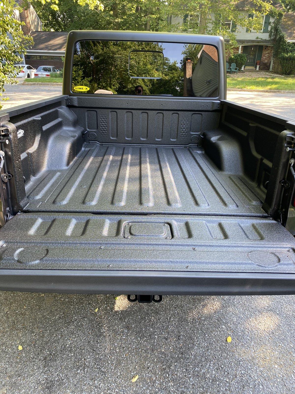

I got it back today and overall am happy with how it turned out. The threaded holes did get covered, I guess if I had plugged them myself it would have been avoided. I have not plans to utilize them so this doesn't bother me. If I do in future, I don't think it would be much effort to re-tap (really more thread chasing). The plastic plugs were covered over, I'm not sure what the plugs are for, but if they need to be removed I'm sure I could get a blade under them to cut the Line-X or just drill through the plastic. The only thing I actually don't like is the Line-X yellow sticker that was stuck to the back window. Looks like a job for scrapper and denatured alcohol to remove.

Looks good.
My understanding of the forward plugs and the holes under them are just access holes for the assembly process and need of future access short of maybe a collision repair, will probably never need to come off in a normal ownership experience.

Thanks for the insight; hope I never find out if that's the case!
Also, sticker came off easily, started with razor but came right off with no other help needed
