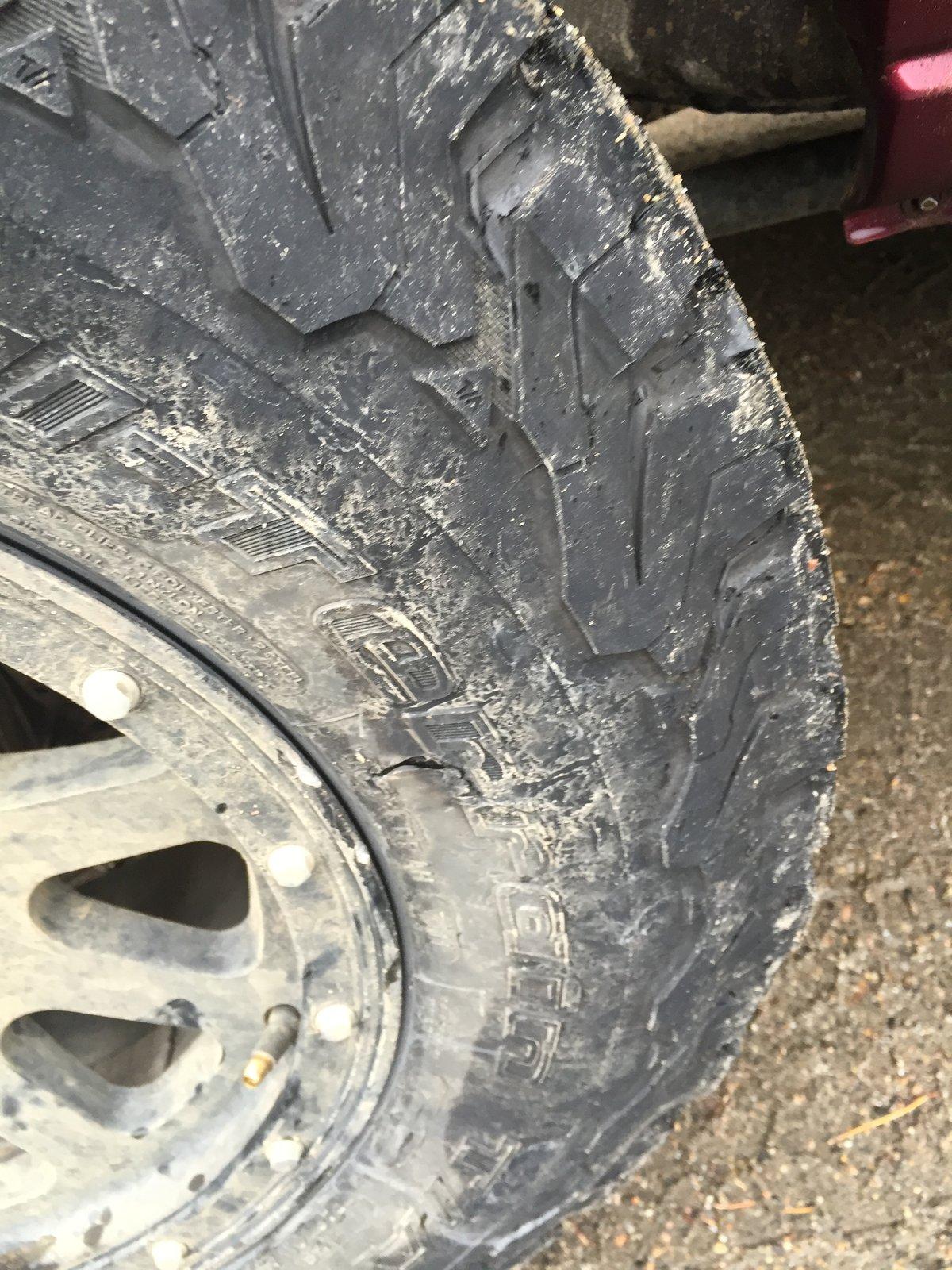

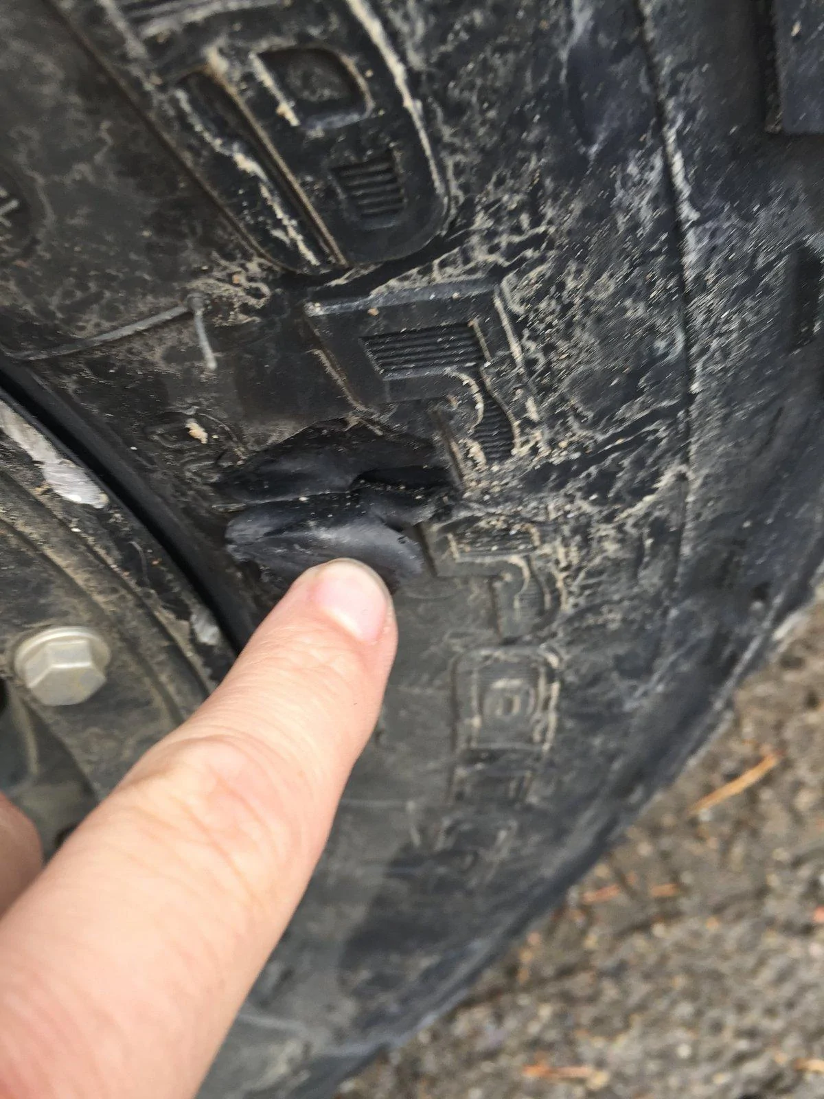

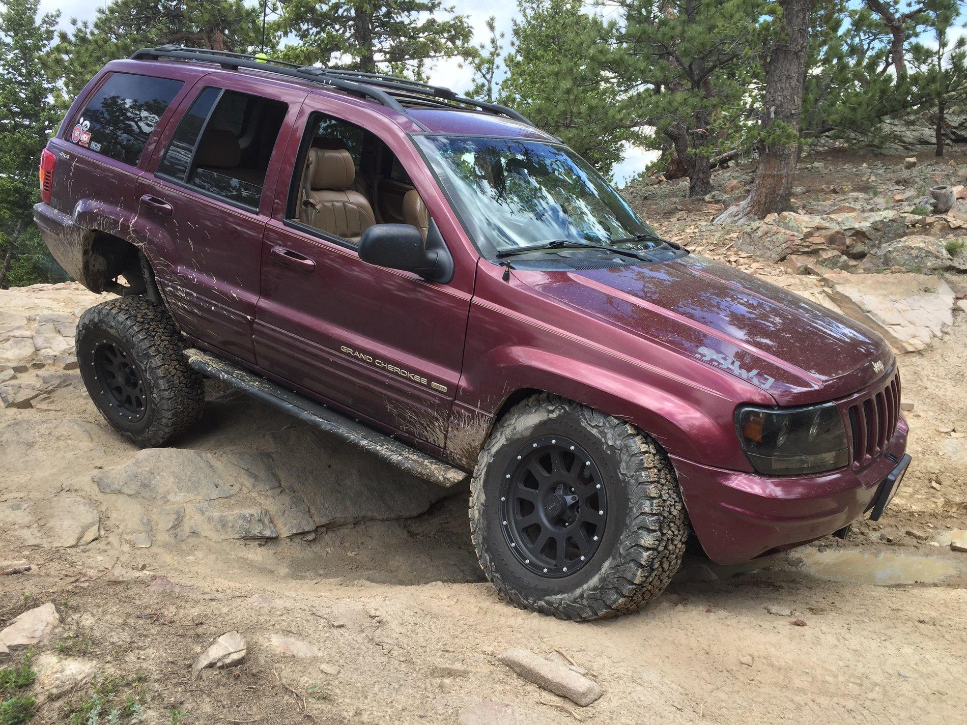

I use to run ko2’s on a previous WJ. They were E rated and did really good onroad. Off road they were okay and I considered them on my JT build but decided against them due to an issue I had off road. I went 4 wheeling aired down, had fun and then had to fill up tires for my 2 hour journey back home... what did I find... a cut sidewall. Fortunately, I didn’t have a blow out but I did have to put a spare on and take the tire to my local DT where I got it swapped out With using certs. “If” I did them again I’d do the 10 ply E rated... I’m on my 3rd set or nitro ridge grapplers 33’s, 35’s and now 37’s... all I can say about them is wow... best tire I’ve ever had to date.

sass JT, good photos of your Jeep in action. Thank you for posting your thoughts. I'm glad to hear you had Certificates to get your tire replaced. I'have used the Certificates in the past and was glad I had them.
