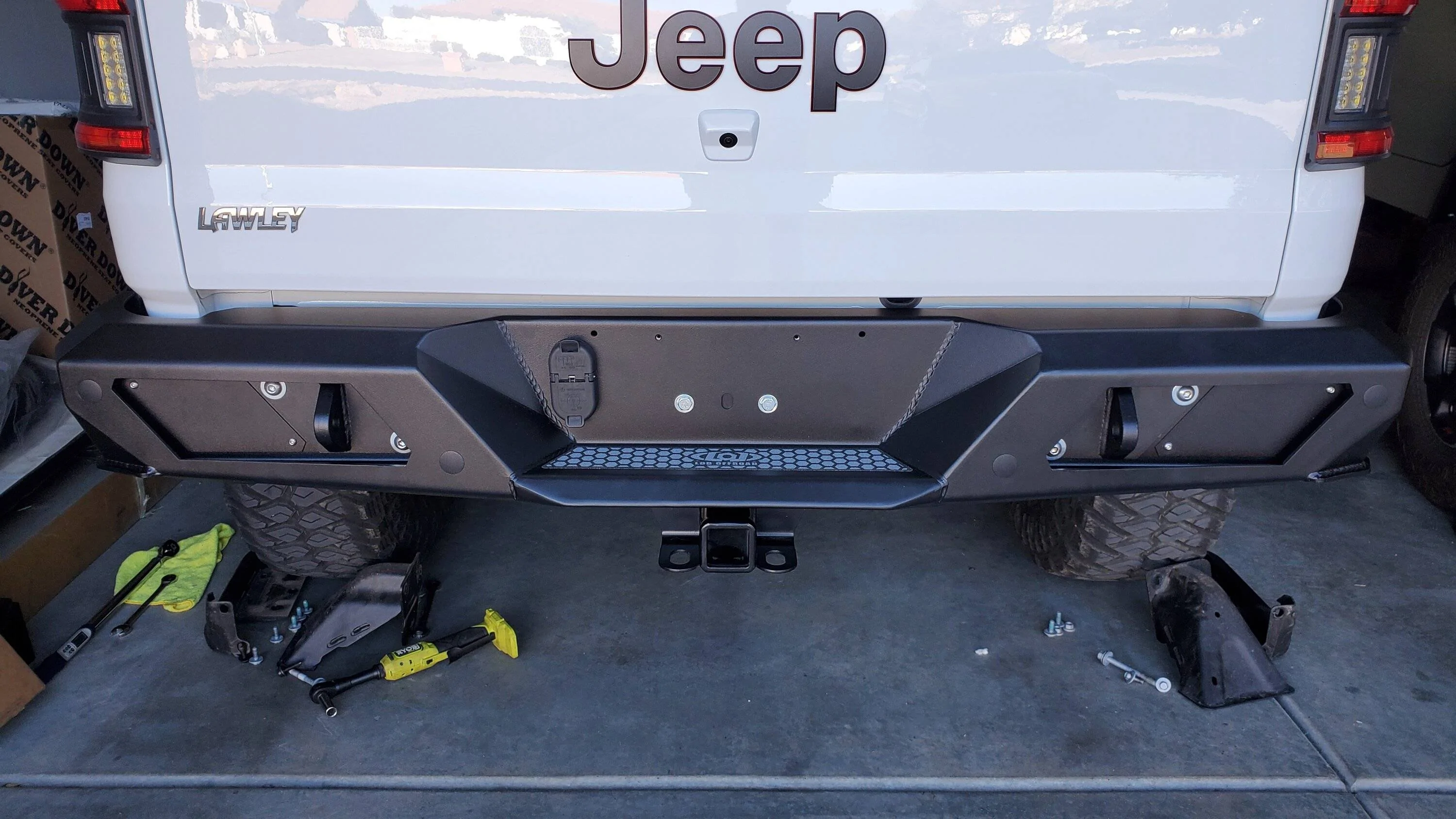

Just installed the LoD Destroyer rear bumper and it went together really easily. I am however having issues installing the bed skids with the instructions provided and wondered if anyone else has had a similar issue. Not sure if the instructions provided are for a different model of Gladiator, but they do not work for a Rubicon model with factory tow package.
Jeep Gladiator LoD Destroyer Rear Bumper and Bed Skids 20221222_084437

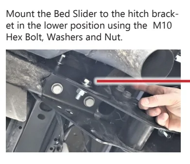

The instructions are as follows:
Jeep Gladiator LoD Destroyer Rear Bumper and Bed Skids Bed Slider Bolts

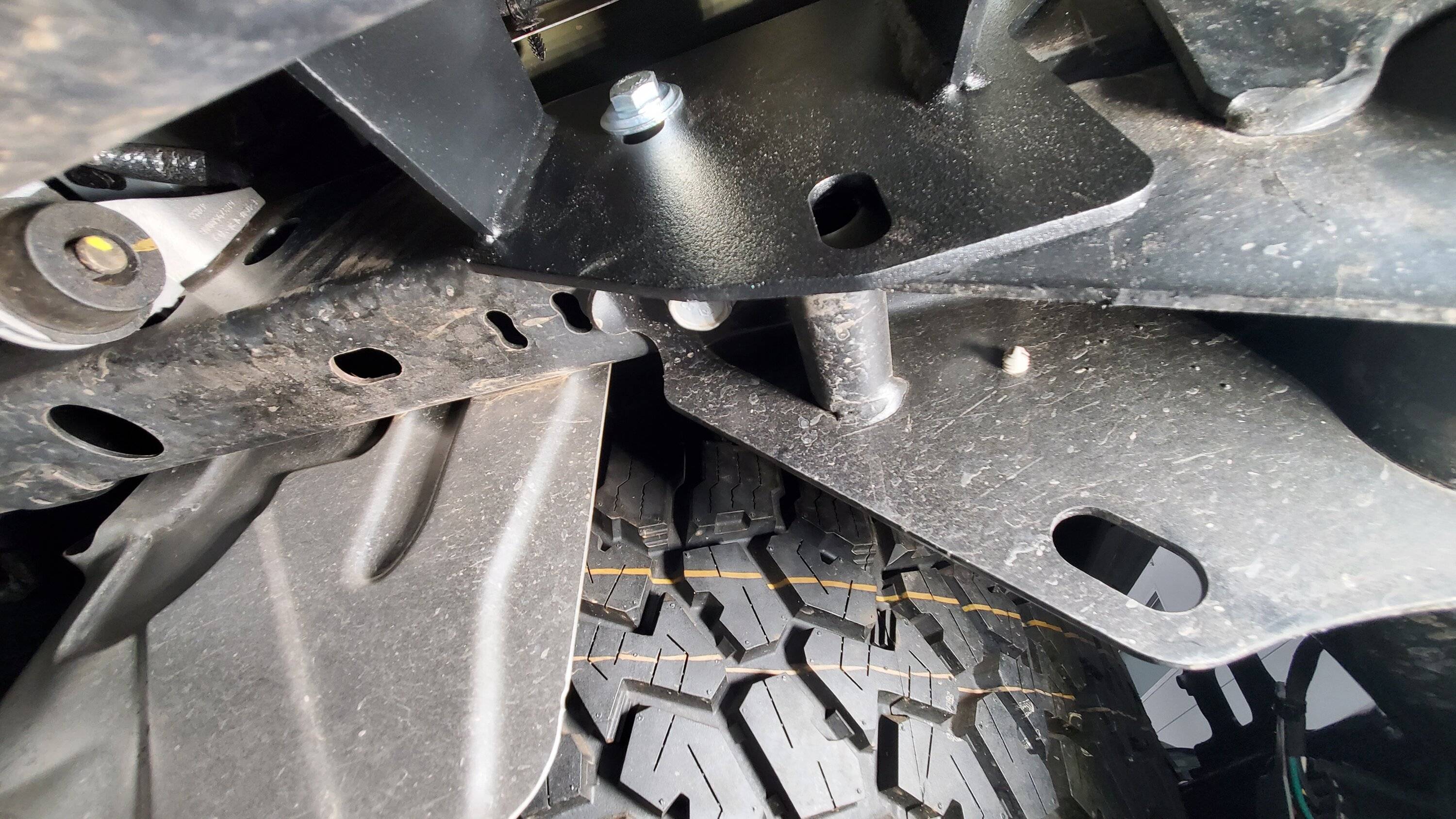

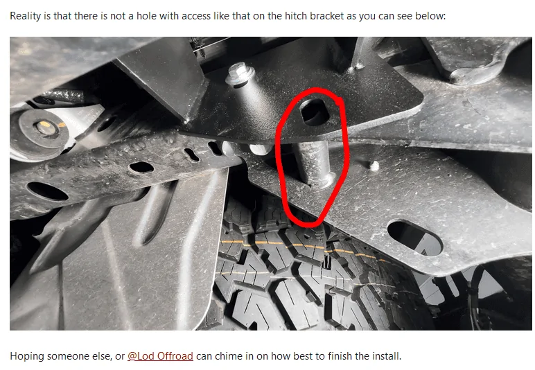

Reality is that there is not a hole with access like that on the hitch bracket as you can see below:
Jeep Gladiator LoD Destroyer Rear Bumper and Bed Skids 20221221_202847
Hoping someone else, or @Lod Offroad can chime in on how best to finish the install.

Looks a little different. Maybe they added that tube spacer? You might need to get a longer bolt and feed it thru that spacer.
Jeep Gladiator LoD Destroyer Rear Bumper and Bed Skids 1671725630319
I think the OEM Rubicon rear hitch assembly is different than all the others due to the included welded-in pipe spacer (circled above) that I believe helps strengthen the mounting point of the OEM bed rock rails to the hitch assembly. I noticed the same thing when I pulled the steel rear bumper and bed rock rails from a rubicon and installed them on my sport s.

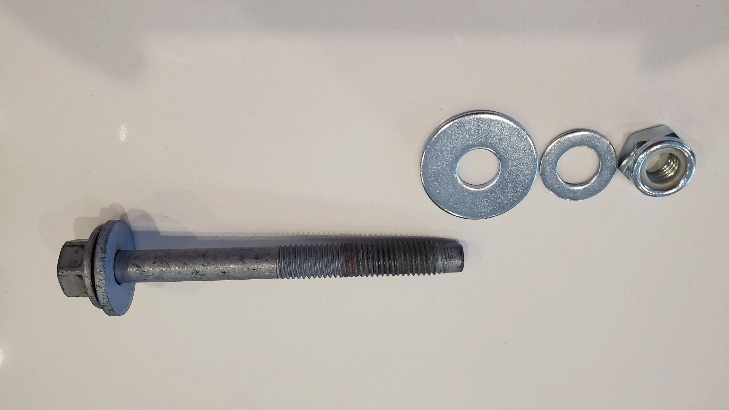

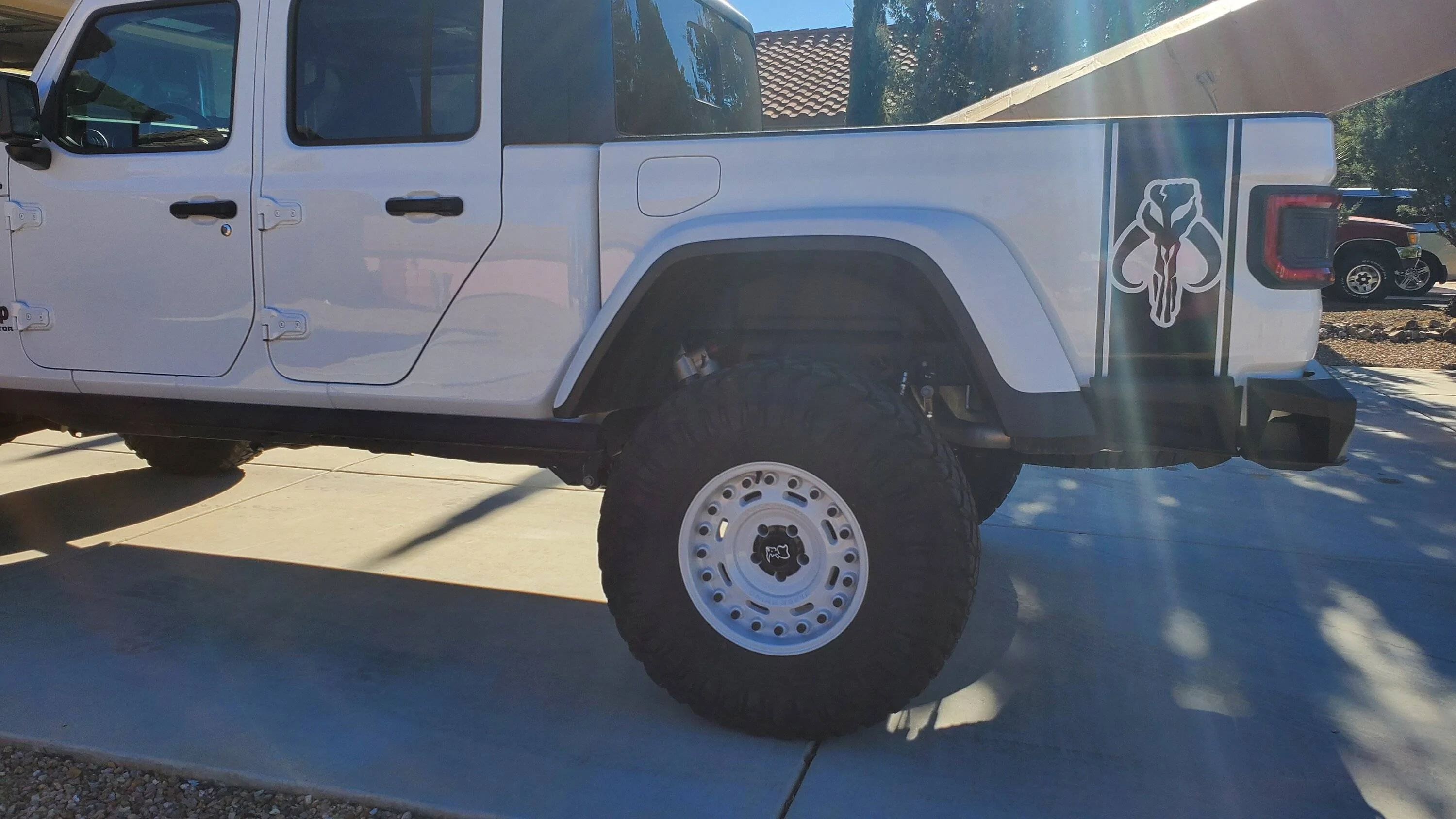

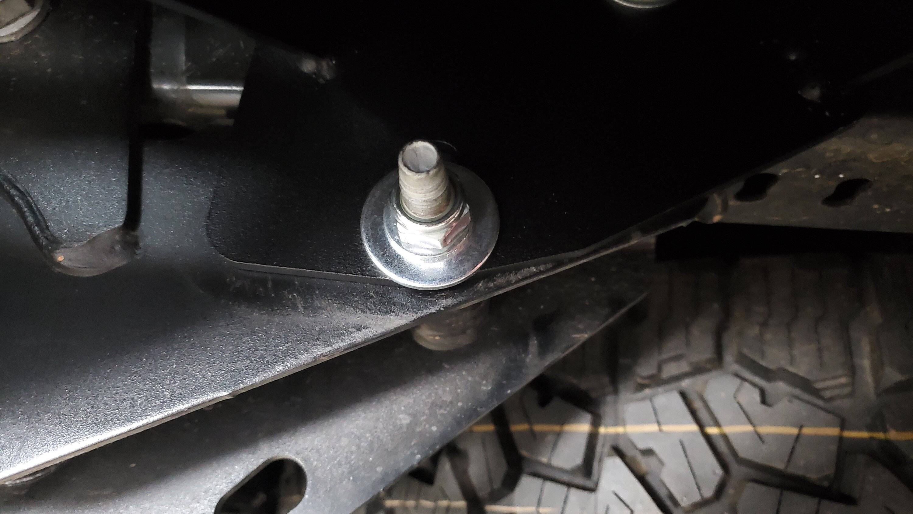

Here is what I did to resolve my issue:
I used the lower bolt from the factory bed skids. Added a couple of fender washers, one 1.25" one and one around .5" both for a M12 bolt size. Added a new nut.
Jeep Gladiator LoD Destroyer Rear Bumper and Bed Skids 20221225_115152
And here is what it looks like underneath:
Jeep Gladiator LoD Destroyer Rear Bumper and Bed Skids 20221225_135318

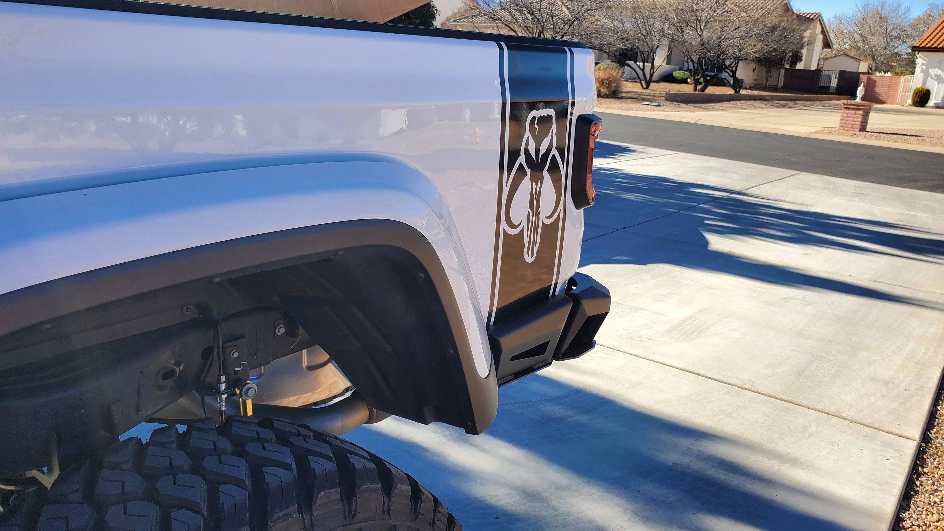

And how the skids look mounted:
Jeep Gladiator LoD Destroyer Rear Bumper and Bed Skids 20221225_140247
Jeep Gladiator LoD Destroyer Rear Bumper and Bed Skids 20221225_140318
