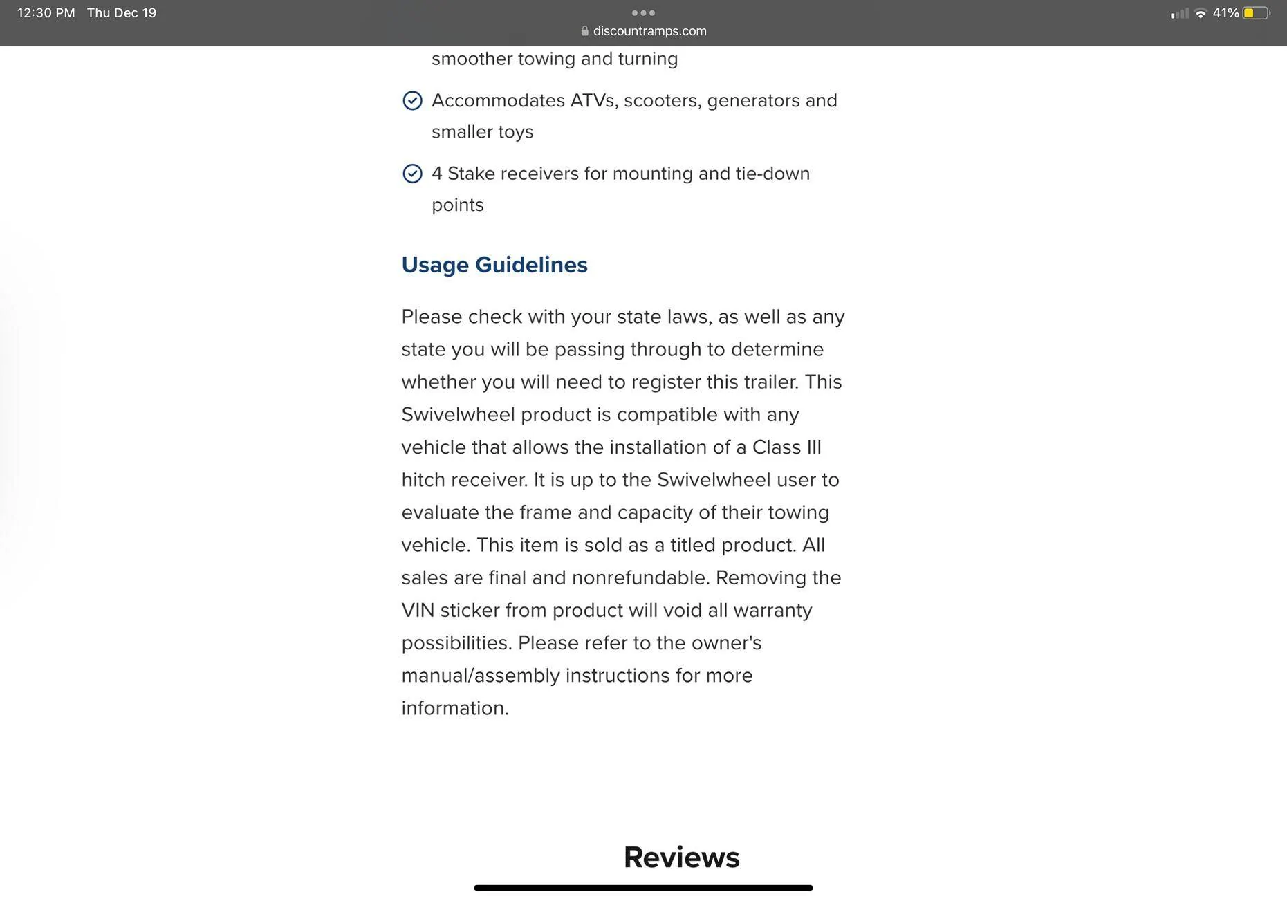

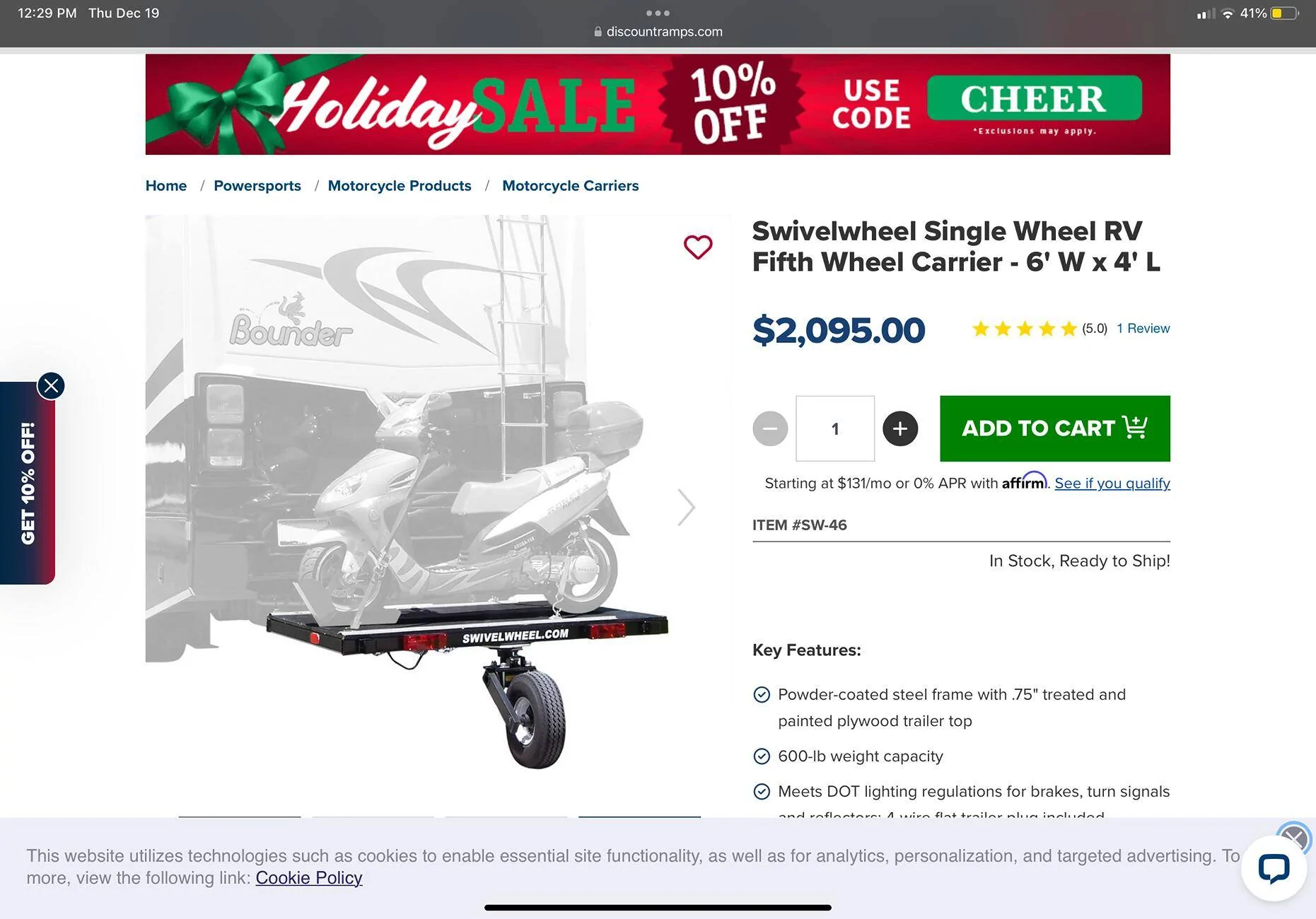

Not sure about license requirements....but you would not be able to turn without bending the extension. There is such a trailer that has two mounts near the rear frame, with a single wheel at the back. Designed to carry a load with added advantage of being able to back up easily. I've seen these on RV to carry a motorcycle. But you will have more expense and material to store when not in use
I actually considered that after I thought about it more. Never one to give up on an idea easily, in my mind, I came up with an articulating wheel mount similar to a motorcycle front wheel. That would actually turn left/right to follow the tow vehicle.
But….the final nail in the coffin for me was: what about VERTICAL articulation? Going over a speed bump MIGHT work if the receiver hitch had enough play to allow the support wheel to rise up and down that slight amount without binding and bending. But any approach steeper than that could possibly rip the receiver mount right off your Gladiator.
So I would need to invent some type of mount that allows left/right articulation for following the tow vehicle AND has a certain amount of up/down articulation so it can handle bumps and steep hills.
This is when I threw in the towel because I realized somebody else had already beat me to this invention……..
