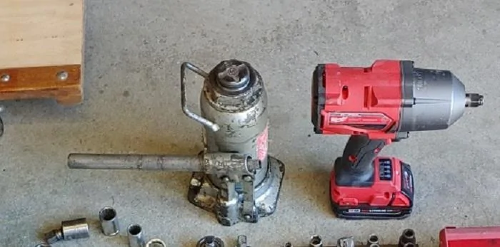

I prefer Milwaukee. They have been around forever.
Jeep Gladiator Looking at getting an impact wrench Screenshot_20210605-104800
You betcha - a friend told me about his and showed me how he can strip down a car for restoration in no time at all - some bolts on the suspension and steering he just lets the thing bust 'em off instead of fighting it. I used mine when swapping springs and shocks on the JT - what a time saver! It took loose the tightest stuff under the truck with no hesitation.

Impact also chews up the finish on lug nuts. I hate it when dealers use an impact on lug nuts and it destroys the chrome - and the capped ones, I've got some where the cap is literally worn through from their stupid impacts.
Breaker bar to loosen with vehicle on the ground, then the new Milwaukee will remove them when the vehicle is raised with a smooth NON-IMPACT action.. That's what's nice about it - impact action only to break things loose then it goes more into electric screwdriver mode, smoothly backing things off.
