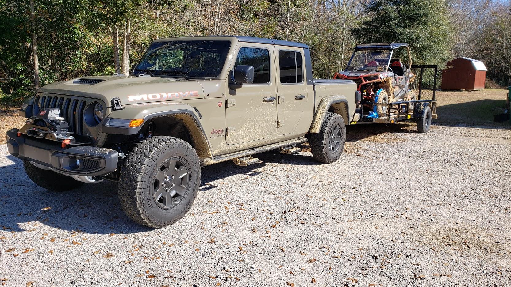

Hi Folks,
I have a Mojave. I chose to install a Winch Plate on the factory Plastic bumper. I want to swap it with a Front Bumper because the Winch sits up too high and obscures the camera.
Here is how the winch looks on top of the bumper:
Jeep Gladiator Looking for a Front Bumper with specific needs. WinchPlate
I can relocate the controller bump elsewhere, but frankly, I'd like to have something that is more integrated.

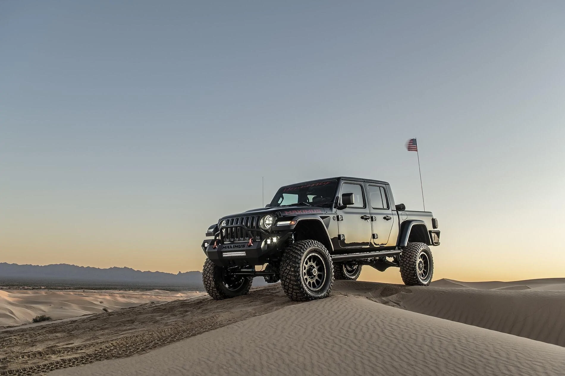

This bumper uses the OEM red hooks, though it's a stubby and the Bull bar might be a problem).
Jeep Gladiator Looking for a Front Bumper with specific needs. Hennessey-MAXIMUS-Jeep-Gladiator-Glamis-1-min
I just can't afford that bumper. You can only get it on their Maximus Gladiator, which costs about $200,000. :)

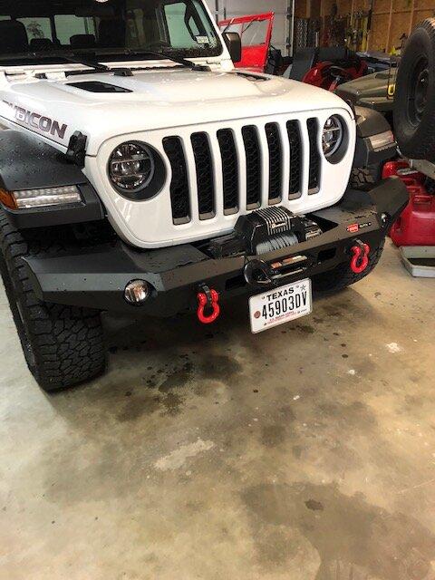

There's also their Rugged Ridge HD full width as well, however it does replace the red tow hooks which in the long run for recovery aren't the best since their attachment point is open in comparison to what's on most bumpers with shackle tabs.

With that winch on top looks as if you where to use it you would be applying a cantilever force on the bumper, a bumper that is not designed for a straight force let alone levered.

I decided to go with this (Rugged Ridge HD full width ) and D Ring shackles. The hooks for quick strap pull outs, and D-Ring shackles for where those would be more prudent. I also decided to get the 'X-Striker Bar' which looked like they would provide a lot more support when it is in use. Thank-You everybody for you wisdom and teaching on just what a 'not so great idea' the winchplate above the bumper is.

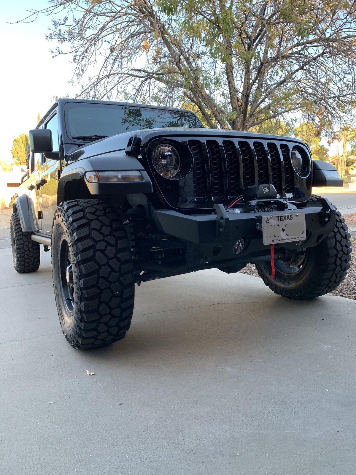

are you talking about re-using the factory skid? If so I wouldn’t if it’s the plastic one, however I do have a stock steel skid from a rubicon and after looking at it I think with some minor cutting it could be used with the Rugged Ridge bumper.

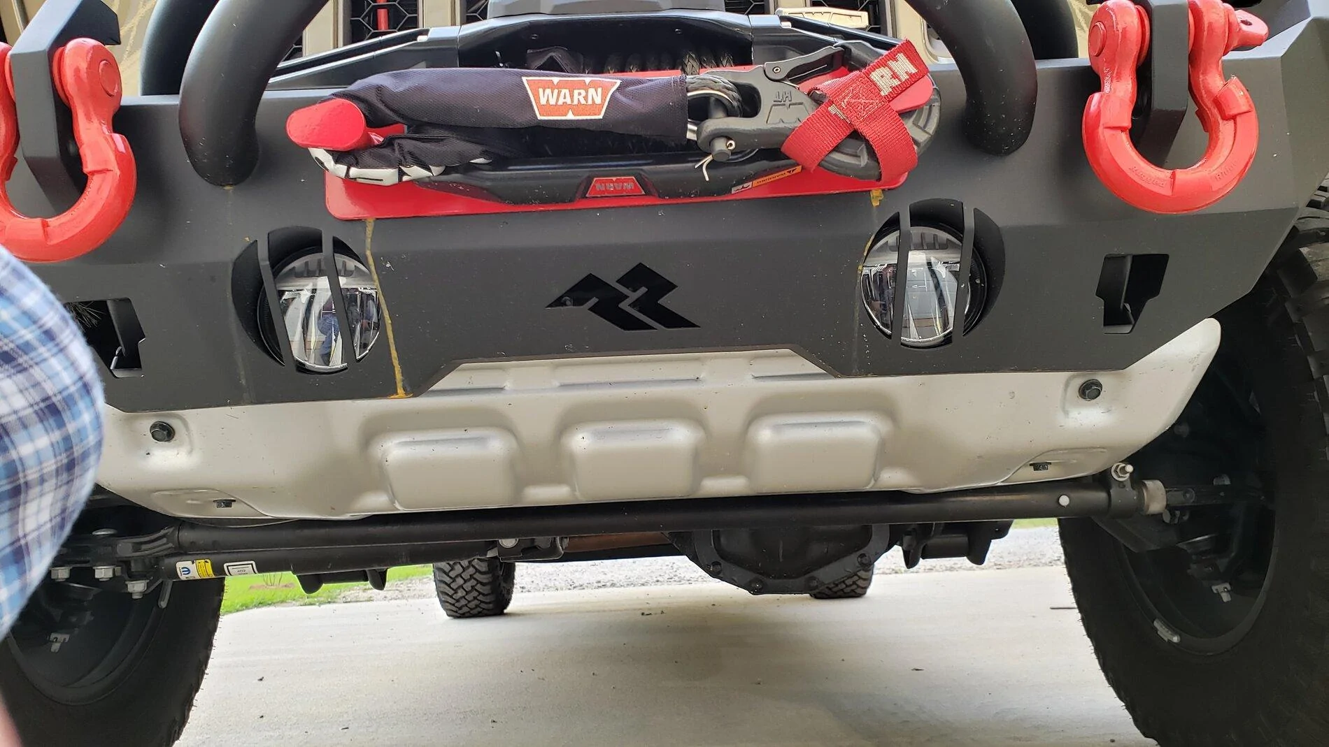

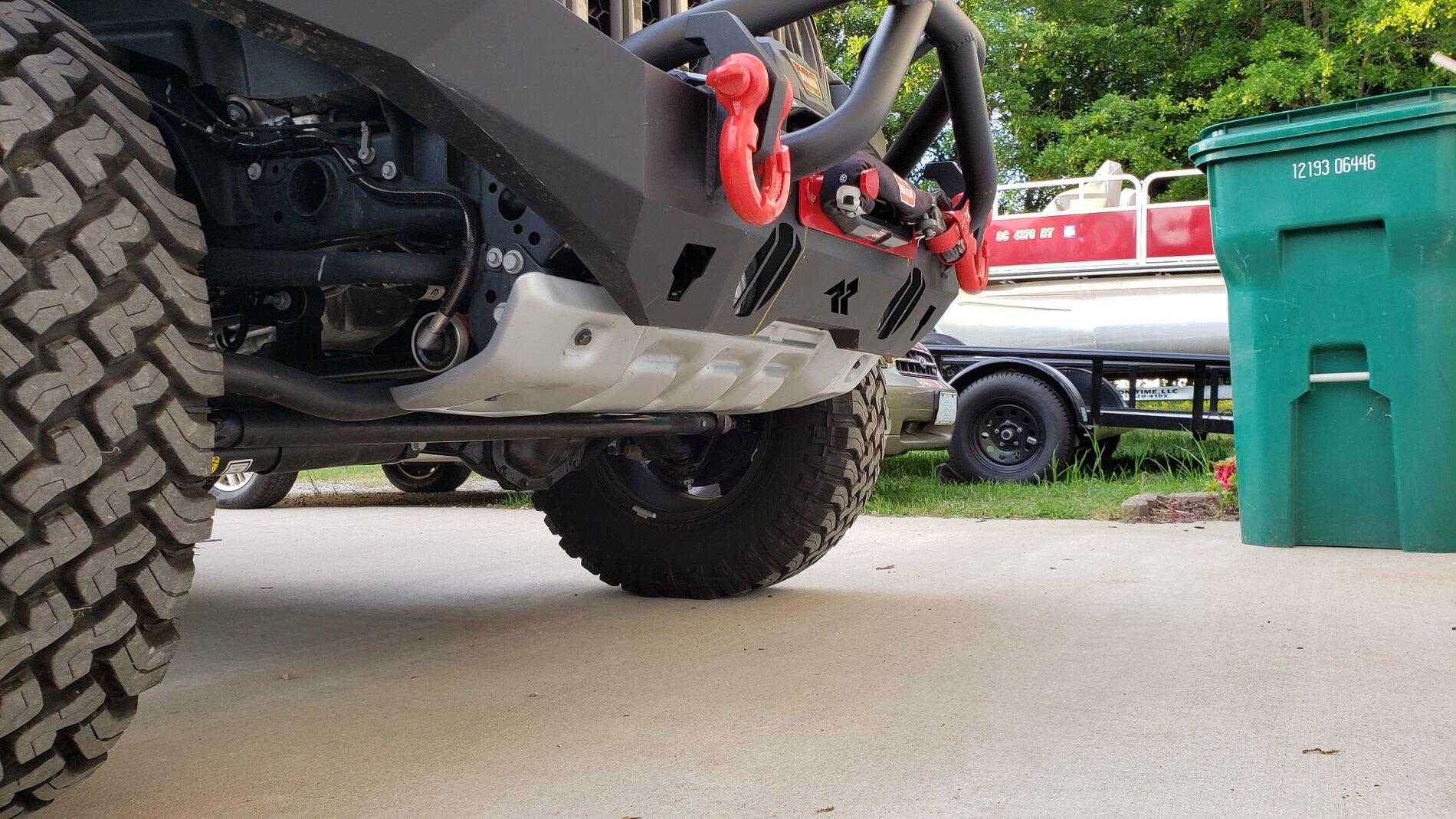

No, Skid plate bolted right on to the factory location and had no effect on the mounting of the skid plate. Looks nice aso. If I can remember, I'll take a picture and post it.
JeepJunky
Bruce
Nov 28, 2020
143
94
South Carolina
Gladiator Mojave (Gator)
As promised, here are two close-up pictures of the skid plate. it attaches to the frame, not the bumper. The bumper is not in the way of the skid plate in any way. Personally, I think it's an attractive combination, but then of course, I am biased! :)

and from an angle:
Jeep Gladiator Looking for a Front Bumper with specific needs. 20210420_191156
If you want a different shot, just let me know.
