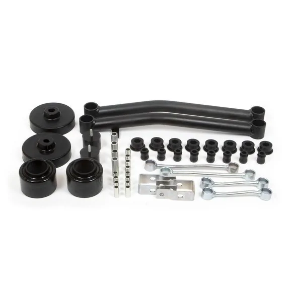

I'm looking for better and adjustable front lower control arms. I like the idea of being able to adjust the control without having to remove one end to adjust. I installed a Daystar lift and the only thing worth keeping is the spacers the best I can tell. Front is a 2" spacer. I've replaced the sway bar end links and I'm looking at replacing the non adjustable front lower control arms that came with the kit with the Teraflex 1416550 Alpine IR Adjustable lower Control Arms. A little pricy I think but I want them to last. They look good what do you think?
Daystar KJ09188KV 2" Spacer Lift Kit I've installed already

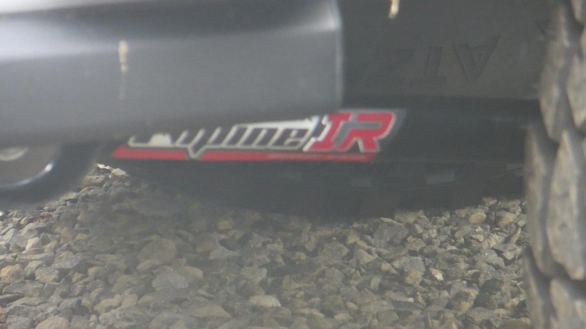

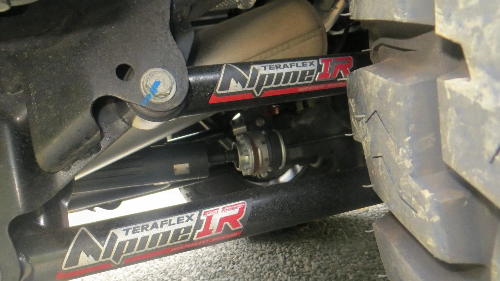

thats what im running on both ends
Jeep Gladiator Looking for better and adjustable front lower control arms IMG_0003.JPG
Jeep Gladiator Looking for better and adjustable front lower control arms IMG_0009.JPG

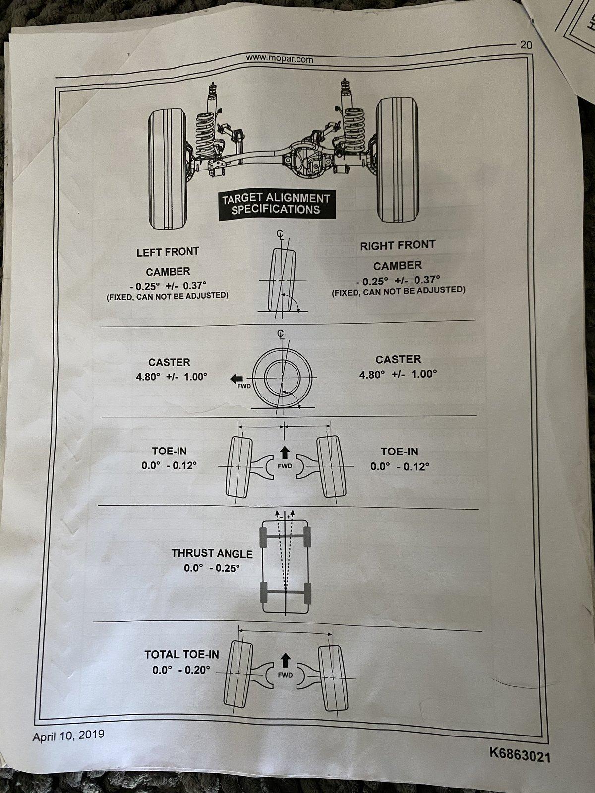

Any up to date alignment specifications available because a good alignment will come next.

Also, here are the alignment recommendations that came with my MOPAR 2” Suspension lift, FWIW:
