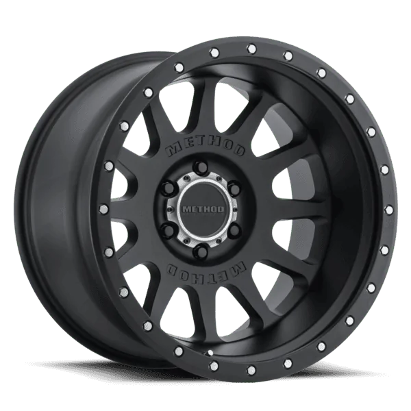

I am new to the forum as well as a new Gladiator Rubicon Jeep owner. I am looking for feedback regarding if the wheel and tire selection I am looking to purchase will fit properly. I am currently looking to put 20"x10" method rims with a 37" x 13.5" Toyo RT on my Rubicon. I will also be installing the 2" mopar lift. Does anyone think I would have any clearance or ride issues with this set up? Your feedback is greatly appreciated.

Super heavy tires and wheels will definitely have a negative impact on ridge quality. Since off-roading isn’t a priority it’ll clear just fine

If you’re going to offroad I’d reconsider due to the big wheels and reduced sidewall because of them.
also the Toyo 13.50” are only available in E rating so sidewalk stiffness and airing down could be issues. I understand the Toyo 12.5” wide tires are load rated D so they’d have less stiff sidewalls
