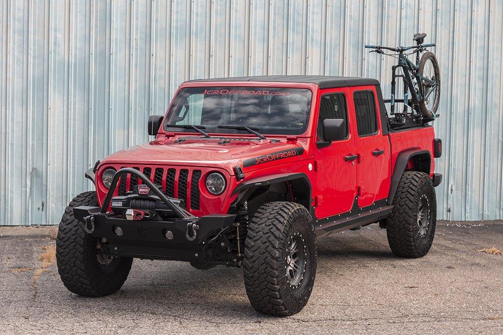

isnt there a jcr rack that lets you mount a bike (or two?) on the side of the rack and has a top rack for the rtt? kayaks in the bed. i might be wrong on the brand, usually i'm not right

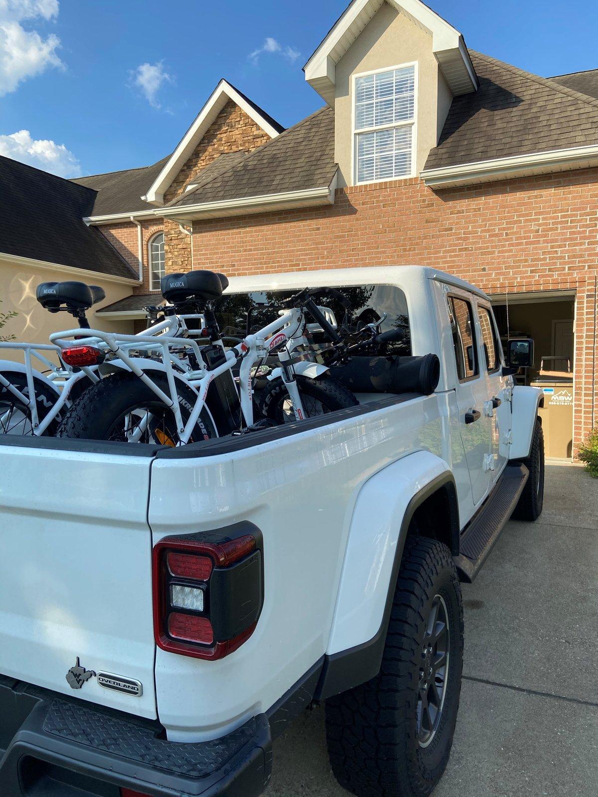

Just lucked out. Both my Ebikes fit perfect in bed. Was hoping to be able to fold in half and fit 2 under the Tonneau cover, but were about 2 inches too thick folded to close cover.

I overlooked the no hitch part. Then the JCR bike mount would be the way to go but I would not want to have them there to obscure my side-view at all.

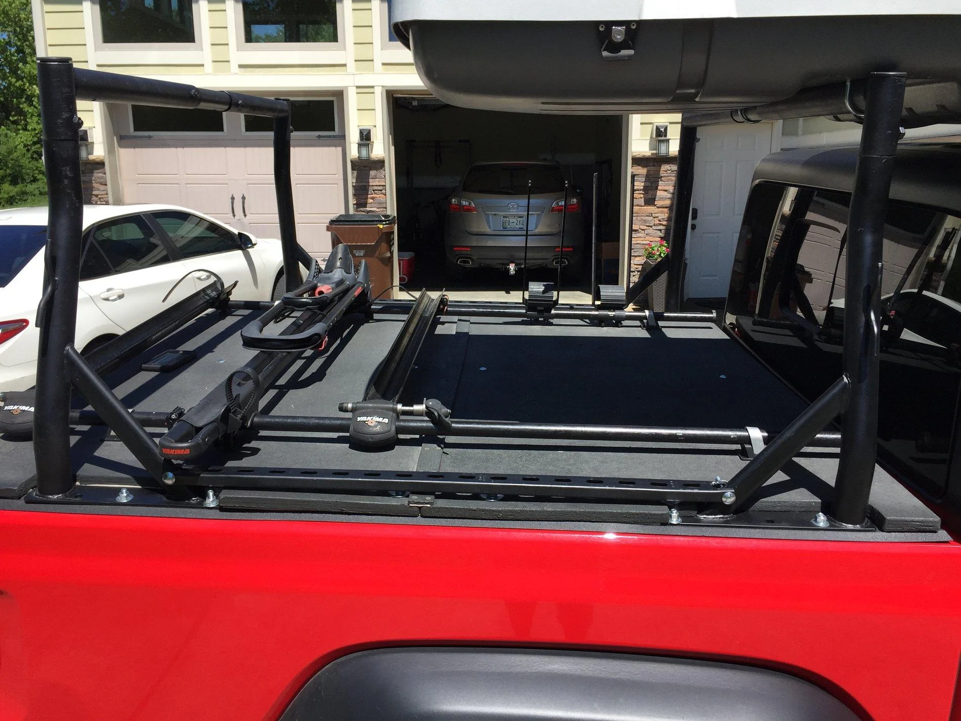

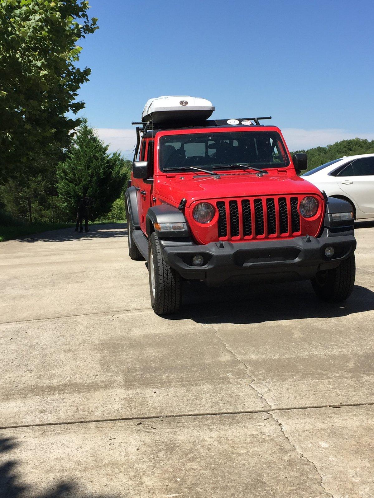

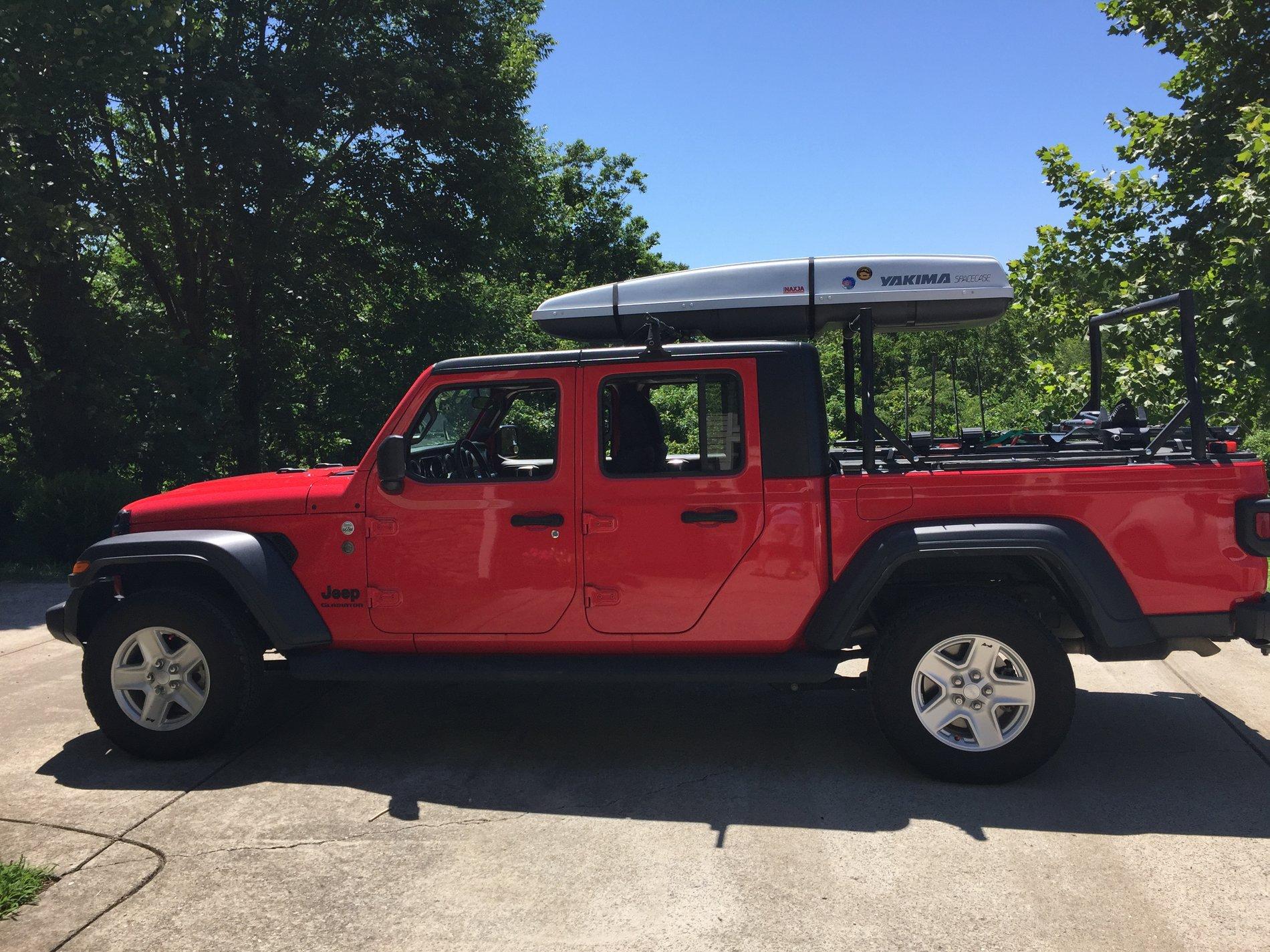

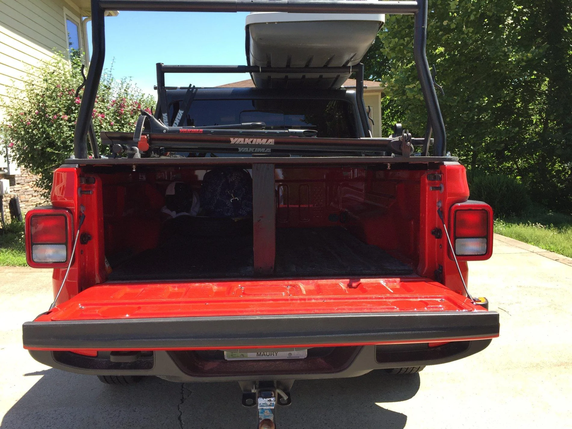

So... I have been thinking about bed rack and dry trunk/bed storage for a 1800 mile round trip to the UP of Michigan from TN. I had a bunch of parts in my garage and after many changes, especially trying to figure out how to safely carry my ā€˜19 Specialized Stump Jumper with the tailgate closed, this is what I came up with.
I can carry all camping gear (including 10 person rapid deploy tent) fishing gear, dirt bike helmets and bike gear in Yakima Sky box. I have room for 2 kayaks or one canoe. Can fit 4 Bikes or more if I donā€™t have the top storage bins up by the cab. Inside trunk space I used storage bins and had two coolers, a spare for my jet ski trailer and room for food etc.
The bed cover is marine grade 3/4 plywood rolled with textured deck paint inside and outside. I used truck bed seal for the top. I added, for now a 4x4 center support. The Yakima space case I bought a couple of years ago for $100, the bike racks I accumulated over many years of cycling. The rack was given to me by my B-In-law from his Tacoma, the rack a cheap amazon $100 purchase. I cut it up to get it lower to roof line. I donā€™t like the look of racks sticking way above the cab of the truck.
I will add drawers soon instead of bins and have a spot for fridge in one of the drawers.
On the trip I towed my jet ski on a single trailer, loaded the bed, roof box with gear, 3 mountain bikes and lots of room in the cab for three people ( all the gear in the back!). I averaged about 17-18 on the trip in heavy winds and rain. The Gladiator handles as if nothing was there, really, the truck is amazing. I have owned a lot of trucks including 3 built diesel F-350 OBSā€™s. The Jeep is easier to drive and does everything I want it to do. I even took the doors and top off while in the UP on vacation! No other truck can do this!!

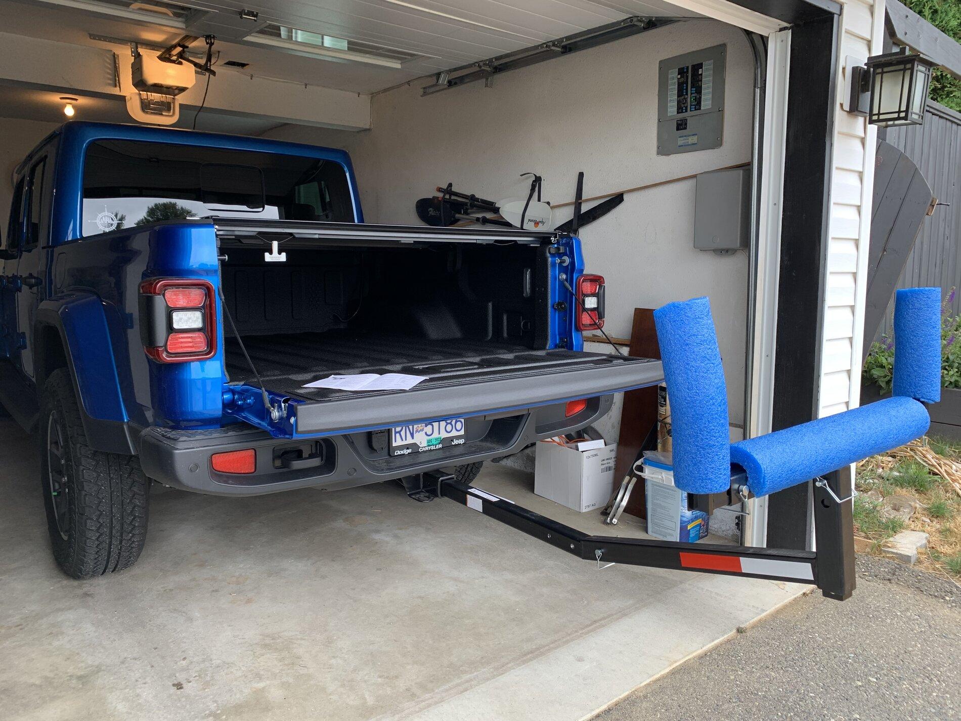

Got this bed extender on Amazon for under $125. I have a 12ā€™ kayak. I added the pool noodles to the metal to protect my boat.
