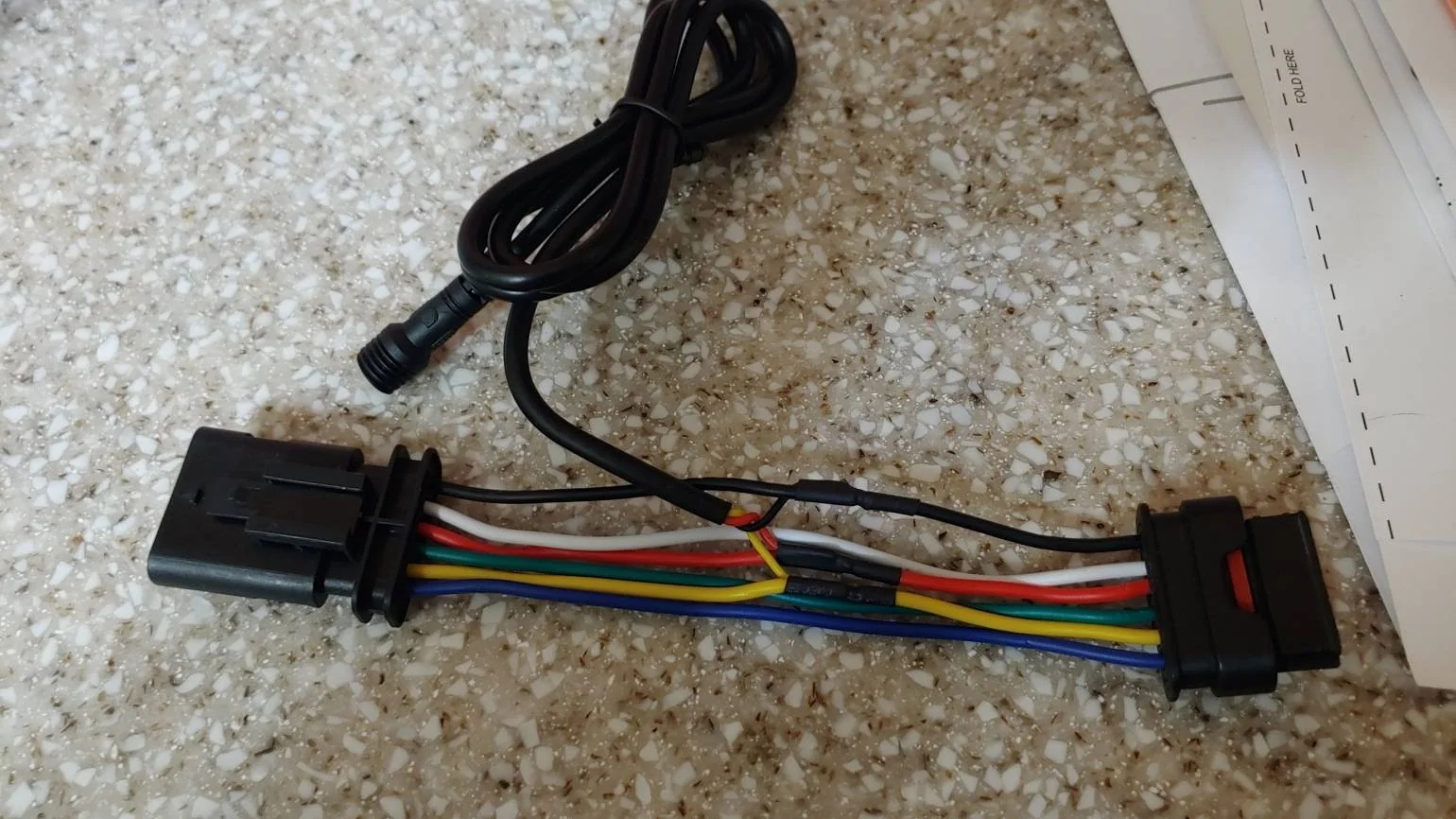

Thanks in advance. Can anyone tell me what type of connectors these are? They’re part of a quadratec DRL harness, but I want to buy some to create a similar harness to splice off of the blinker circuits without cutting or tapping the OEM harness.

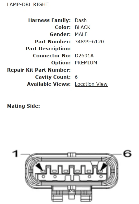

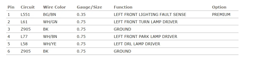

DRL and turn signal are in the same harness. I got the signals for my snow plow for turn, DRL and park from the same exact harness.
Most quality connectors have the numbers right on them. Search Mouser, Digikey and other connector sources.
Use the 34899 numbers, for example -
Jeep Gladiator Looking to Source Connectors 1672602870795
Thanks. I knew it was the same harness, but I need two of them for blinkers, and I only have one. Did you buy the same quadratec harness, or source the connectors separately? I’ll search 34899.

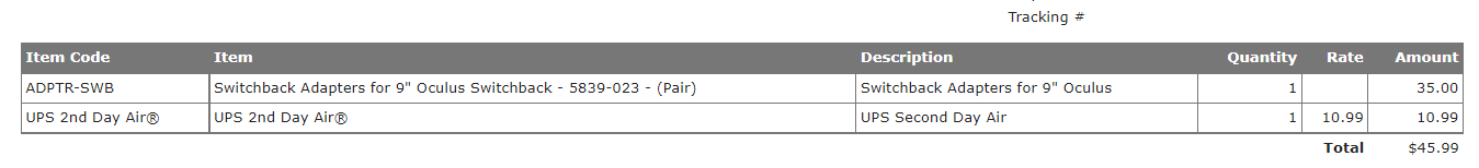

I bought from Oracle - they use them for their switchback lights.

Justin was the rep - and I don't know if they'll sell individuals or not. I needed a pair so I was happy to get a pair. (I needed to take Left turn and Park from one side and right turn and DRL from the other, or was that the other way around.......)
