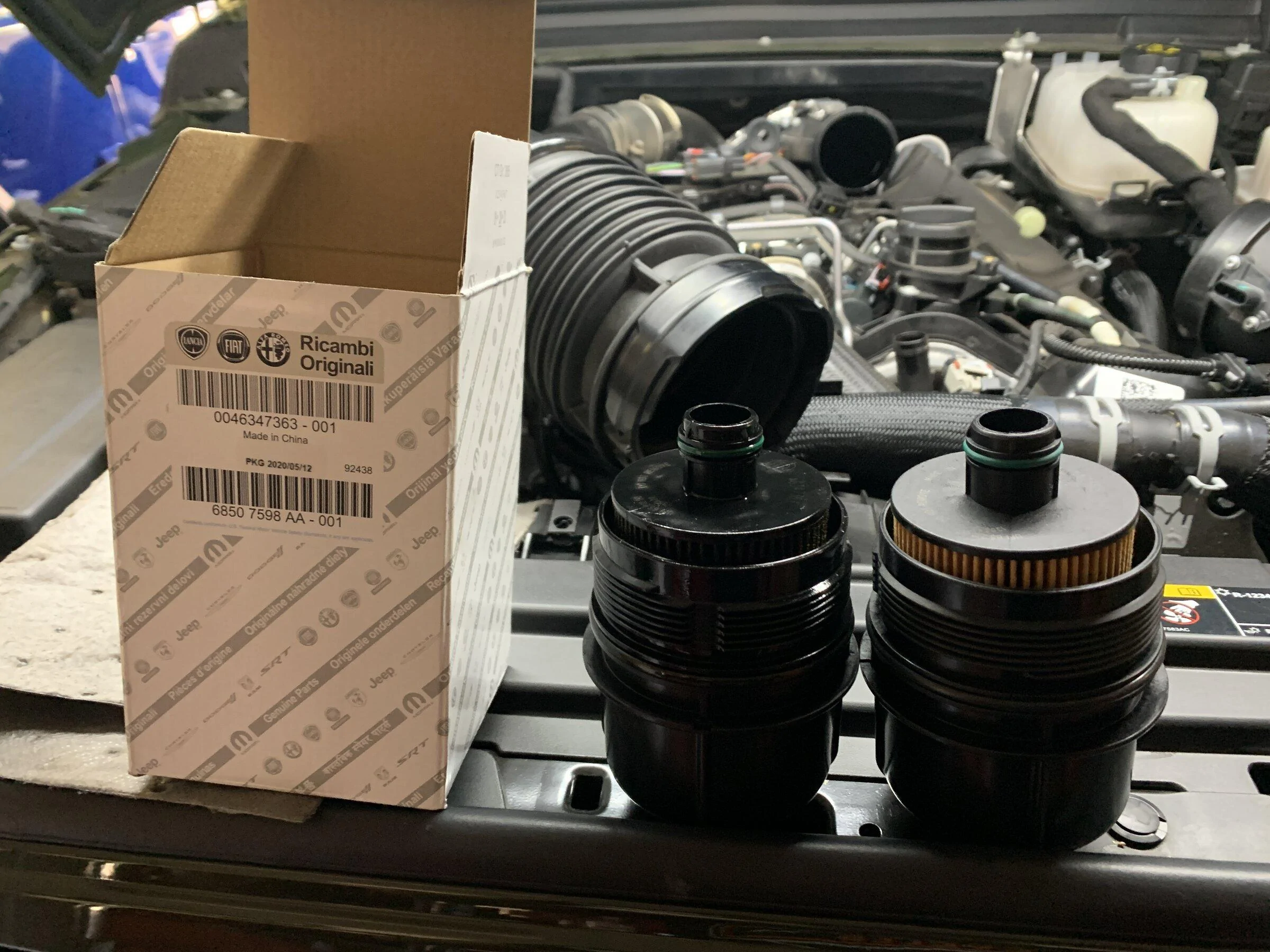

Self changed oil on 2021 eco. New oil filter is OEM and correct PN. Filled with 9 qrts Pennzoil Platinum Euro 5W50 MS 12991. No issues for first 60 miles. Then after a start got the low oil pressure light and oil gauge turned red. Oil pressure reading appeared normal range never dipping below 19psi. Then saw it dip to 6psi for just a second at idle. Shut engine down and called dealer. Dealer said to drive it over as there is a recall for this indication. On start up and drive over no issue. Tech was able to duplicate and scan showed low oil pressure code. Dealer flashes ECU and said was good to go. After another 50 miles low oil pressure again. Dealer made appointment and advised me to go ahead and drive it for the two weeks till my appointment. Stay tuned will advise if it seizes up before appointment. Dealer is taking responsibility if any damage occurs until appointment.

There was an issue with wrong type of oil filter used or not seated properly or something like that.

Make sure your oil filter is torqued to 25NM, and not just hand tight. Also, next time if you want to save a few bucks on a filter, I’ve been using an Ecoguard filter. It seems to work just as good as OEM

OE filter. Just pulled the first PM A on mine, no issues.
Dealer tech also removed and checked filter and put back on prior to flashing ECM. So can only assume he torqued correctly. Thanks for your input and filter info

I will second the oil filter thing. I did the oil change myself and had the low low pressure light come on at a stop. You have to make sure the oil filter is completely seated and screwed all the way in

The issue I am having is something other than filter. It will not do it on cold starts. The engine must be at operating temp on a restart. If I hit the accelerator peddle right at start it will not do it. Idle pressure hovers around 18psi may dip to 16 just for for a 1/4 second but oil temp has to be up there. 215. Dealer had pulled filter to verify correct one so only assuming tech torqued correctly. It goes in this Thur to figure out.
