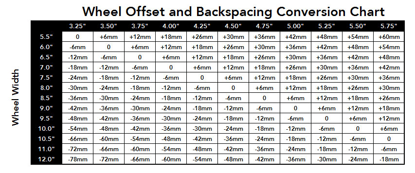

Here is the best chart. You can see how rim width, offset and backspacing work together.

With that tire I think you need to gain about a 1/2". A wheel with 5.50" of backspacing or less should work. Just doing rough math here.
