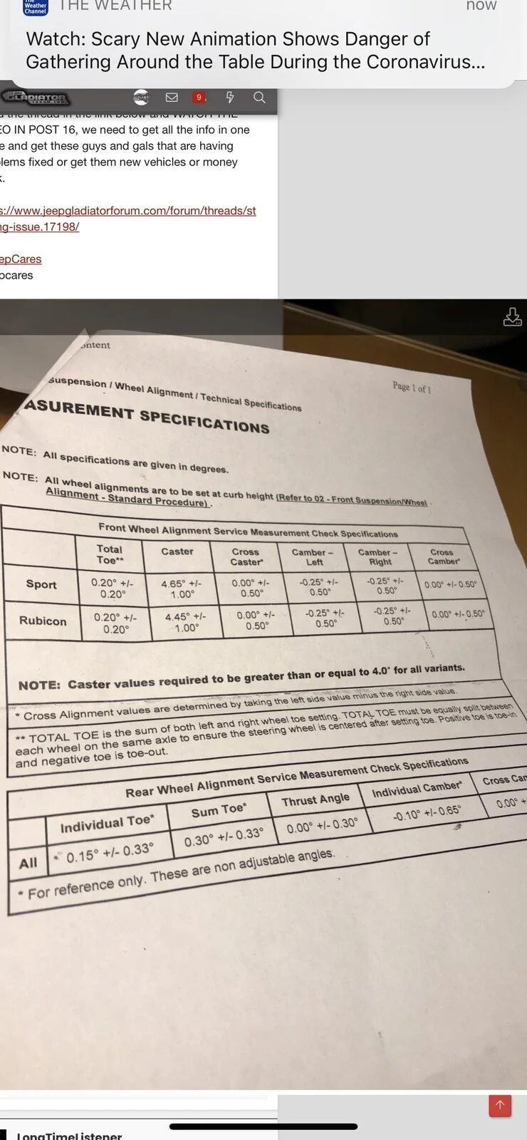

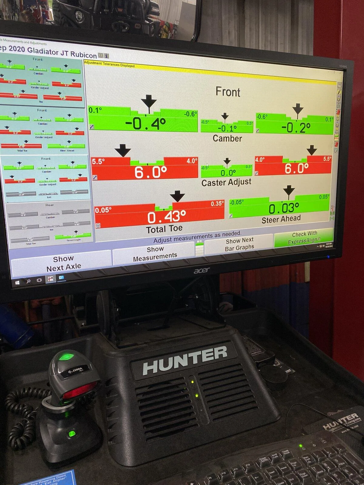

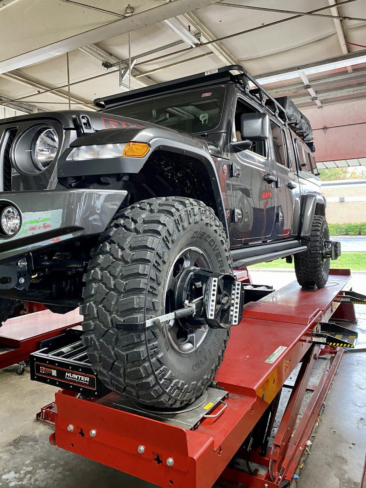

Best way is to put it on an alignment machine.
I’d start with the 1/4” longer and adjust as needed. Also to help with steering I wouldn’t stay within the stock spec.
I bumped my caster up to 6* and it’s much better. I also added a little toe.
