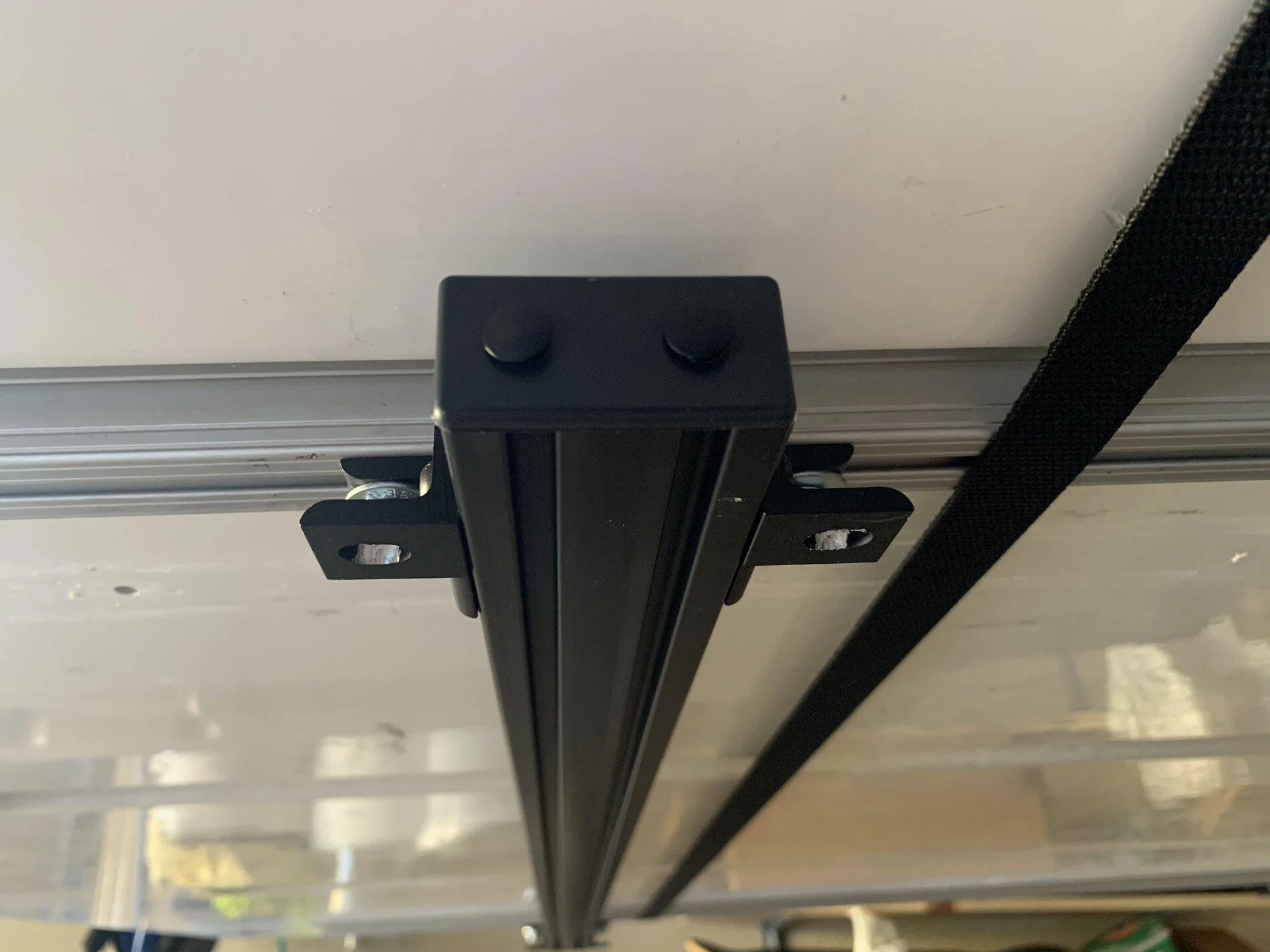

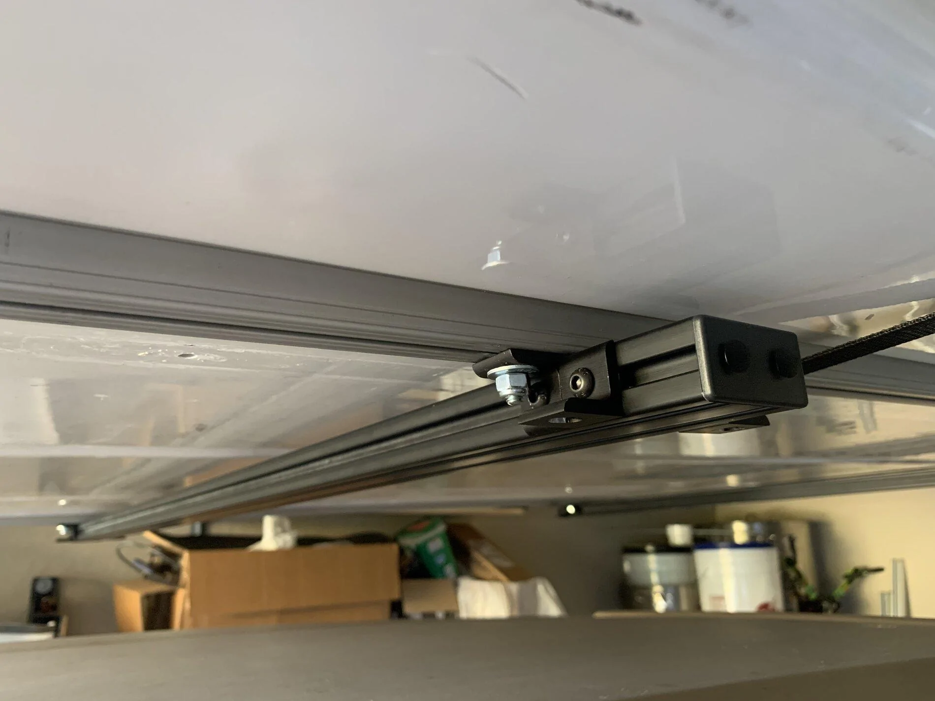

This is the 1"x2" t-bar I ended up using as crossbars to keep the RTT as close to the EvoA as possible. They will remain attached to the bottom of the RTT to keep the top of the cap clean when the tent isn't installed.
