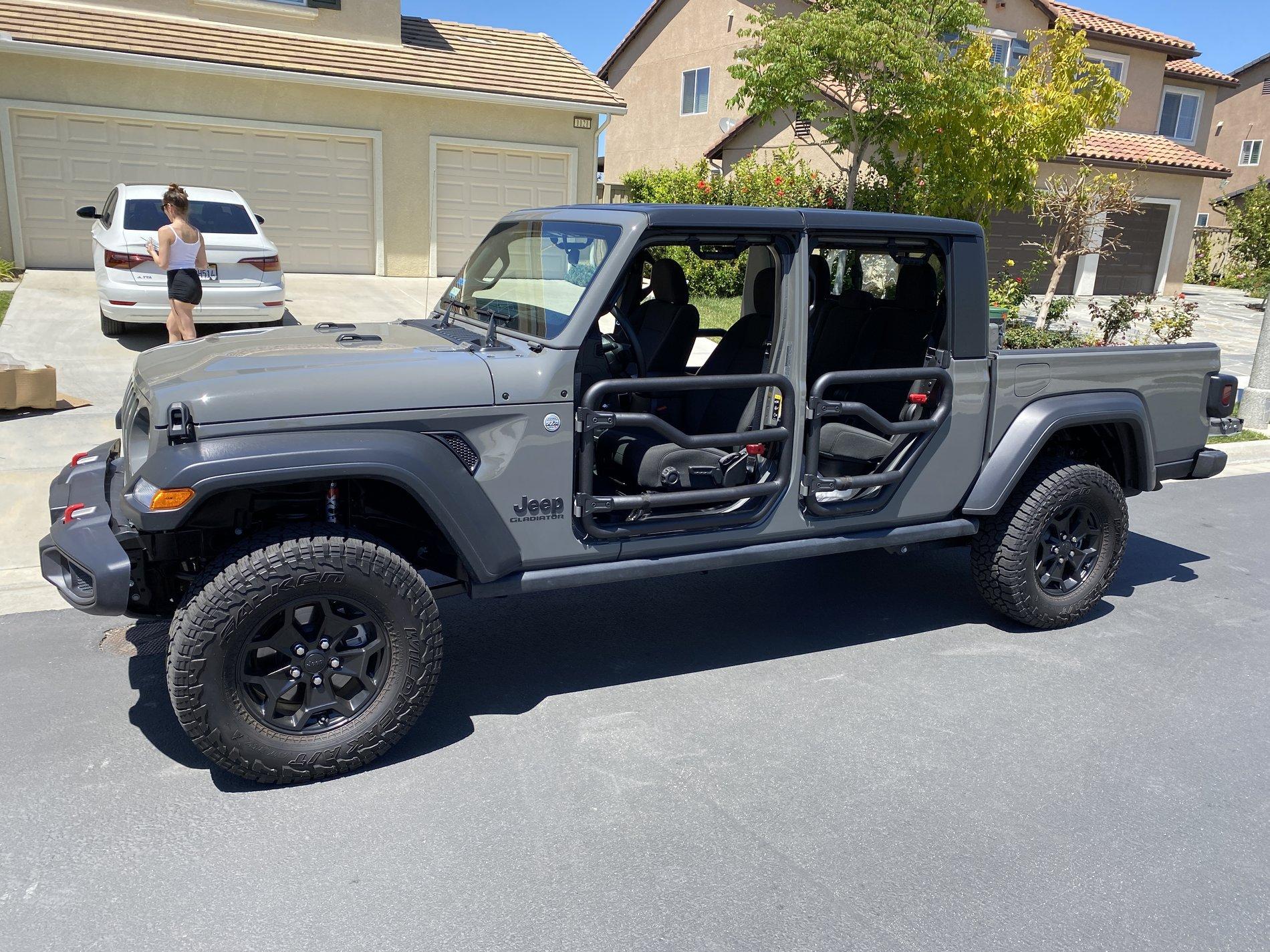

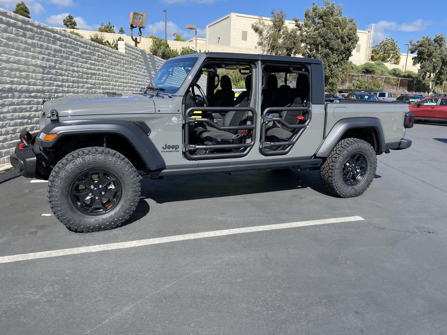

Went ahead with 315/70 17 Goodyear Duratracs which are 63 lbs and 34.4 inches. Can confirm no significant difference in acceleration from 285/70 17 Falken WP ATs. The Falkens are heavy for a 285 at 63 lbs so I believe that’s a factor. For anyone with a M/T and 3.73 gears that’s stressing about the acceleration like I was don’t worry about it !
Jeep Gladiator M/T 3.73 gears 33s to 35s? A9DD2A7E-DA95-4F11-BAFB-498FF8C60049
Jeep Gladiator M/T 3.73 gears 33s to 35s? 47594CD1-F3CB-41BF-922F-A5D98C246934
