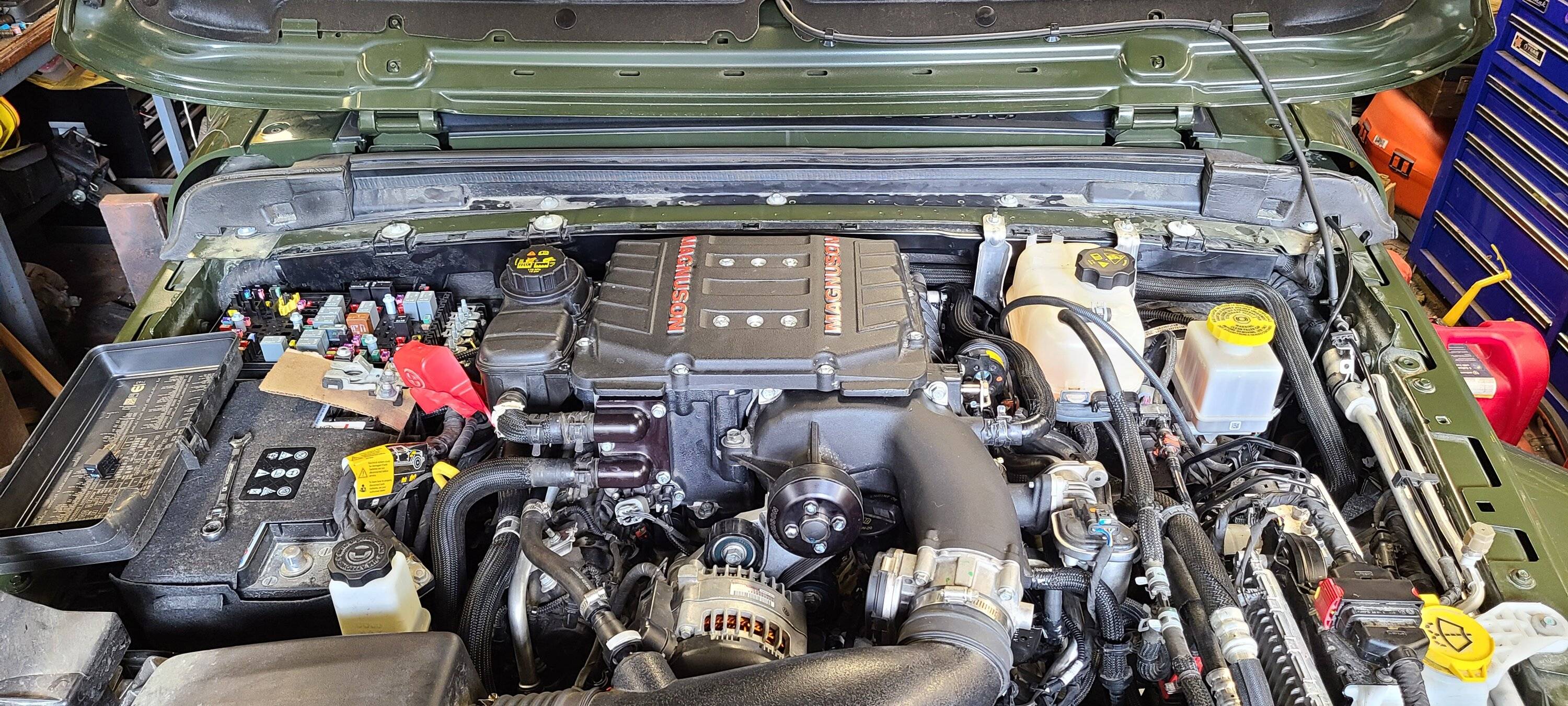

I got the Magnunson installed and the preliminary tune is pretty good. Some fine tuning needed, I think I need to do some tuning in torque management. If I get on the throttle it will stumble and my fuel mix leans out. I will update as I do some trial and error.
Other than the stumbling issue, it definitely has better get up and go.

Boy they do a proper job of fit and finish. Even if it added nothing performance wise it looks great ? Looking forward to hearing how it is working out ?

Current update is: it was running and driving but would bog down and lean out if I got on the throttle too quick. I messed with the throttle voltage and caused the pedal and throttle body to get out of sync/ not respond so the throttle remains shut. So I now have to figure that issue out before I can continue tuning. I have a few leads I am following.

Drives like a champ. Got help from a guru and it made all the difference.
Still working out a few bugs. Gets some knock at the top end, likely due to too much boost.

With the magnuson I had to go with the stock pulley, I may even need to go one size larger as it makes a lot of boost at high revs.
