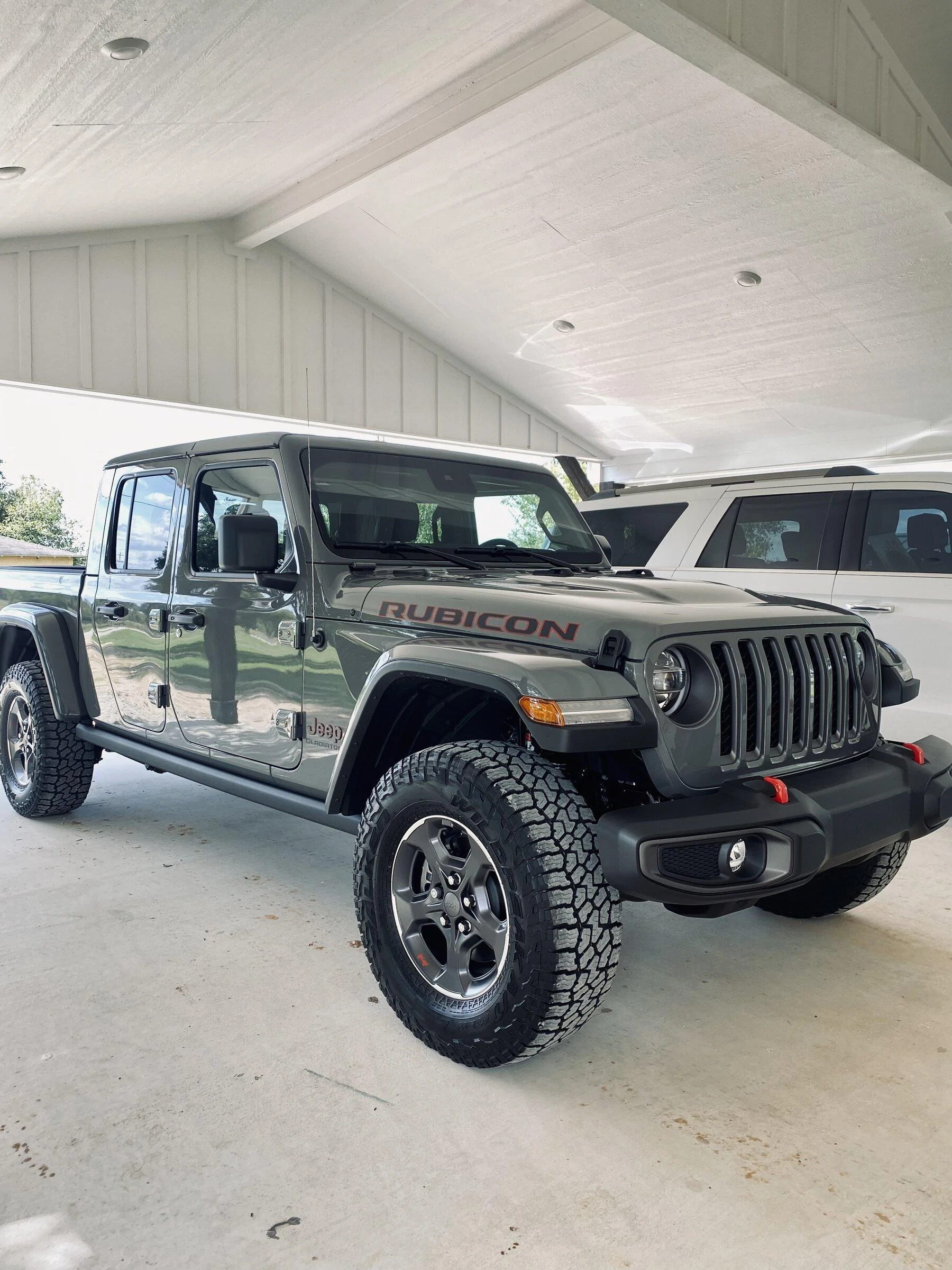

Howdy! Been lurking for about a month. Picked up a 2021 Gladiator Rubicon two months ago. Just purchased a Magnuson supercharger kit from a local shop in which the original customer backed out on. Looking forward to the build and documenting everything. Hopefully I don’t destroy my Jeep.

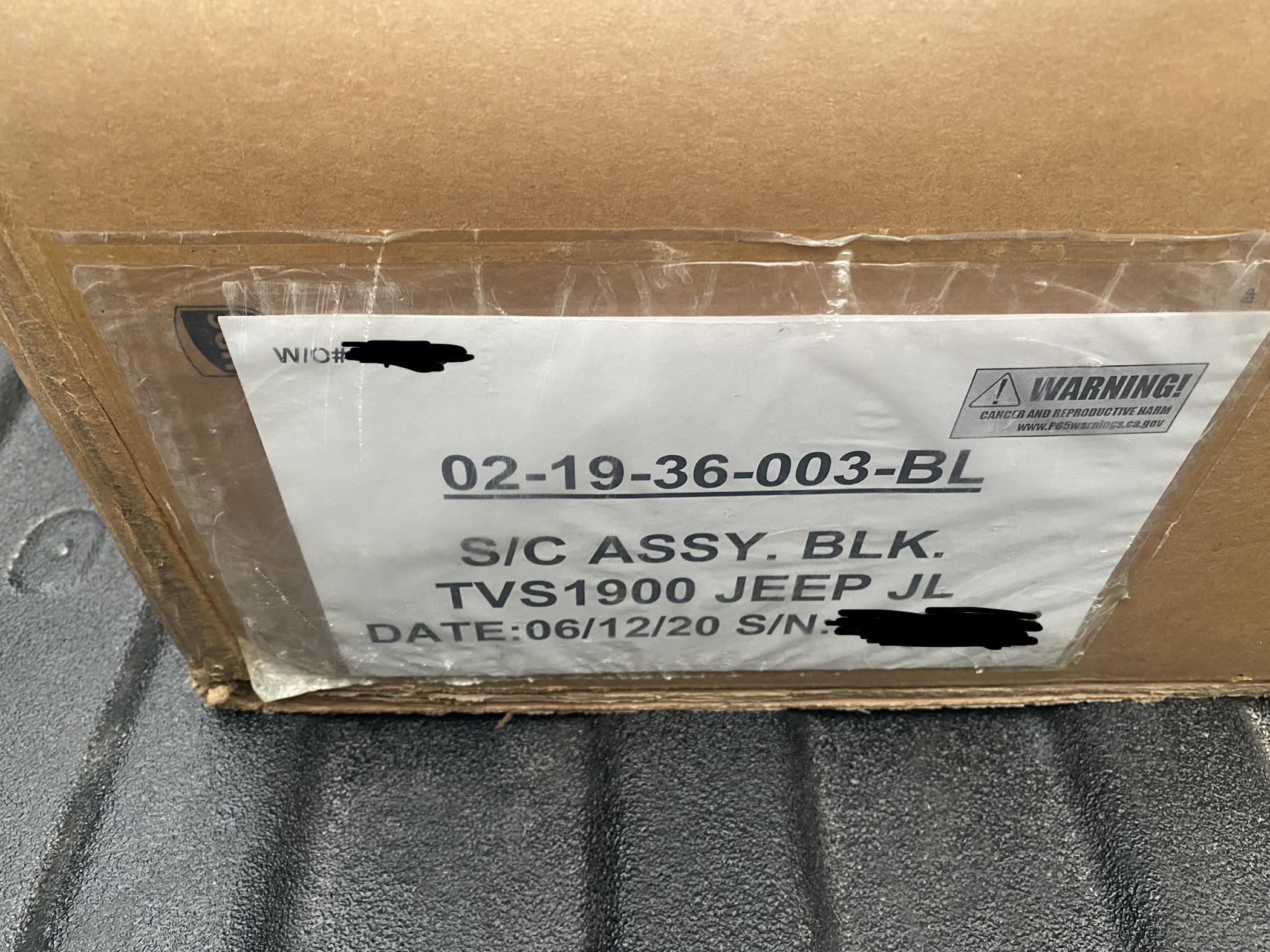

Picked up my supercharger stuff today. Like I mentioned, this thing was ordered for a customer that backed out. I feel like I got a great deal on it. Looks like it was made in June of 2020, and has been sitting in the packaging since then. Anything I need to be worried about manufacturing at that time, ala recalls? Thanks for any help.
