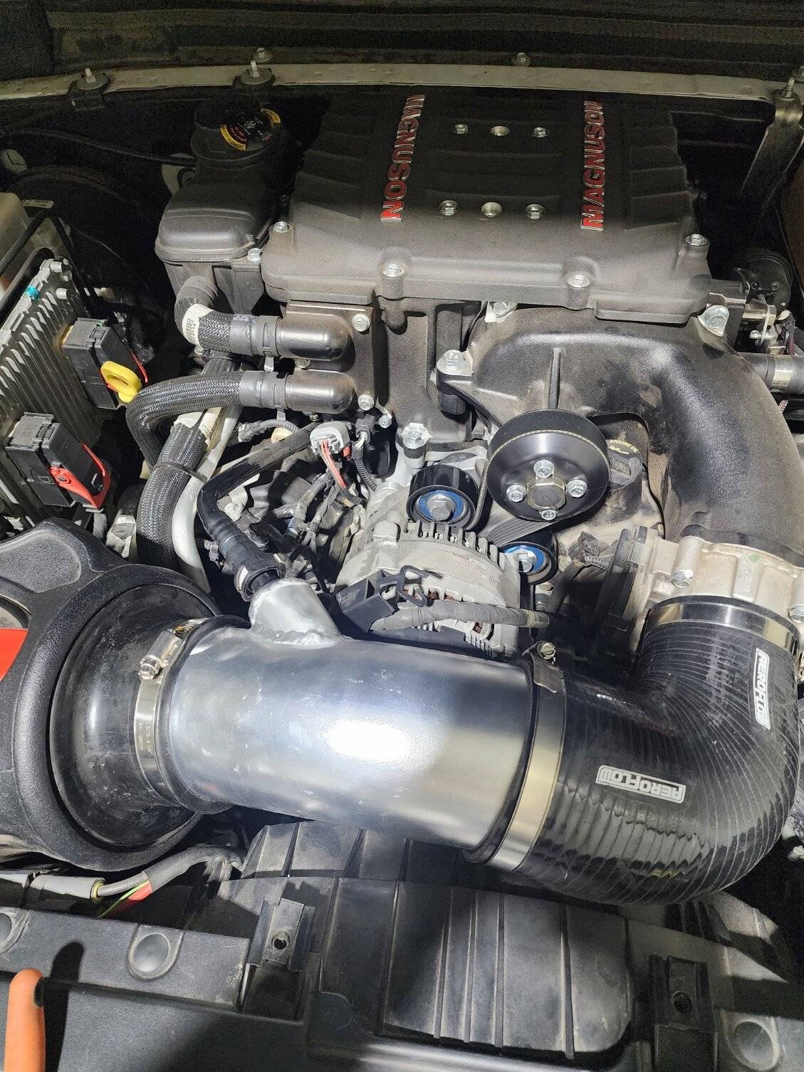

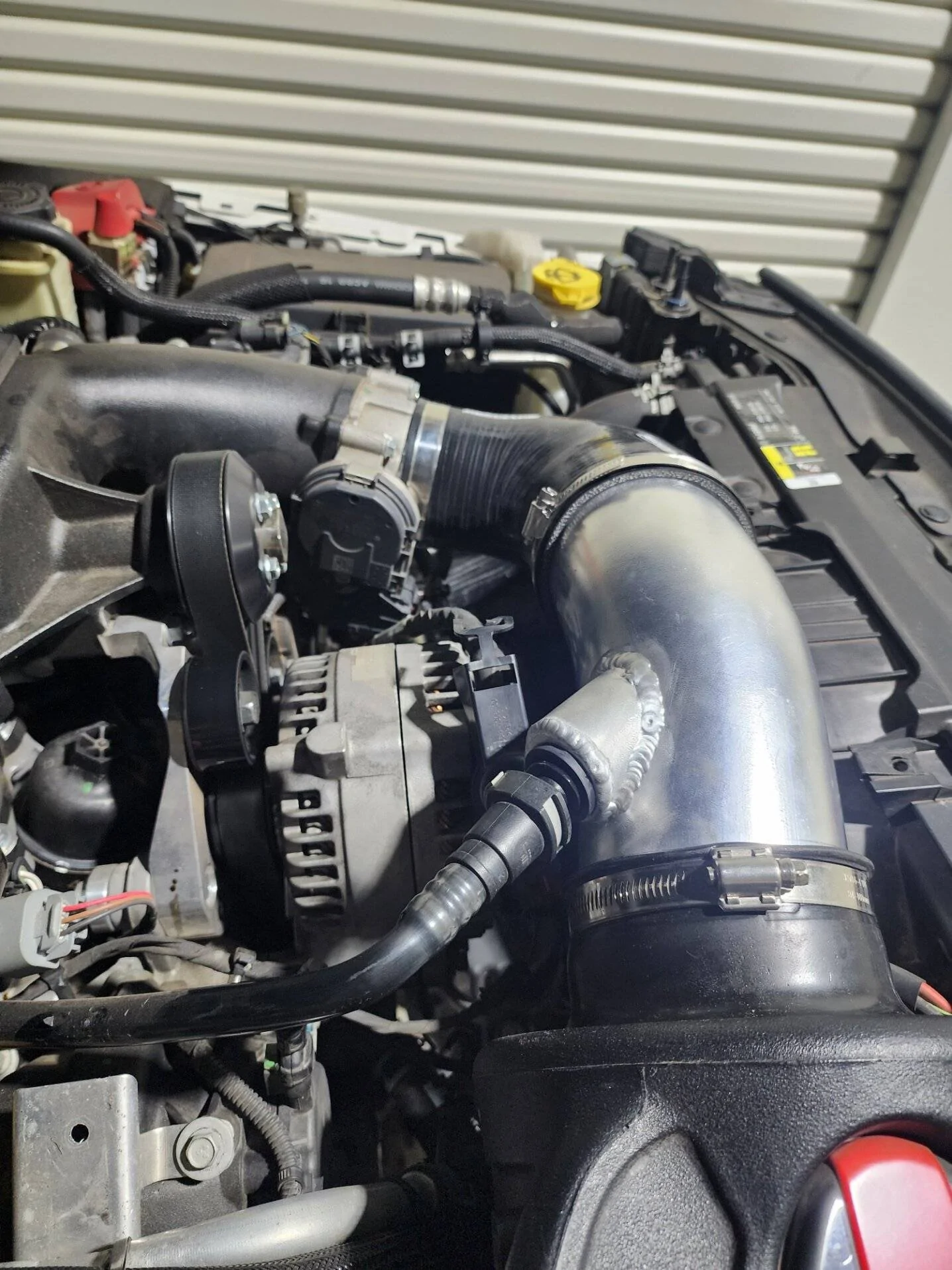

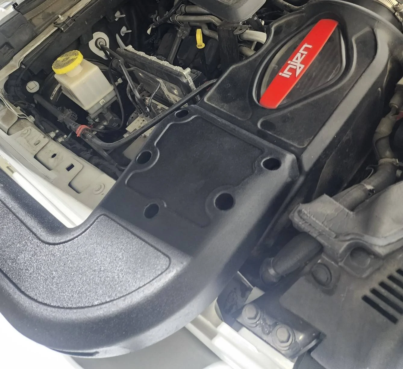

Fitted my Magnuson at 57,000kms now done 15000kms and no issues. Using an Injen Cold Air Intake and Injen Snorkel as well as Corsa Cat Back Sport exhaust.
