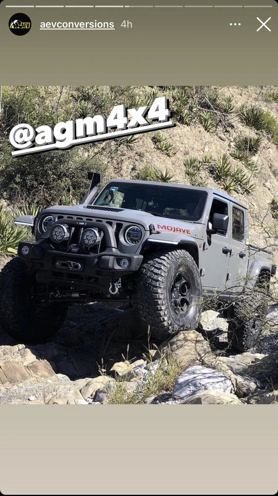

As for the snorkel, it CAN be done. Not 100% sure how but I know someone has made the AEV fit. Which I plan to do soon.

Thank you. So waiting on my order, I am left to aimlessly shopping or cruising the forum :crying: . I guess that is part of the"fun", figuring things out..... and maybe overthinking things to death. Which is inevitable while waiting. I find myself second guessing even the options I orderedšŸ˜‘šŸ˜«

lol, I know the feeling. Youā€™re going to love it. I had that same thought intially tooā€¦ that ā€œshoot, the mojave might limit a lot of my optionsā€ but enough guys are figuring it out and so am I! Excited to see your rig!
