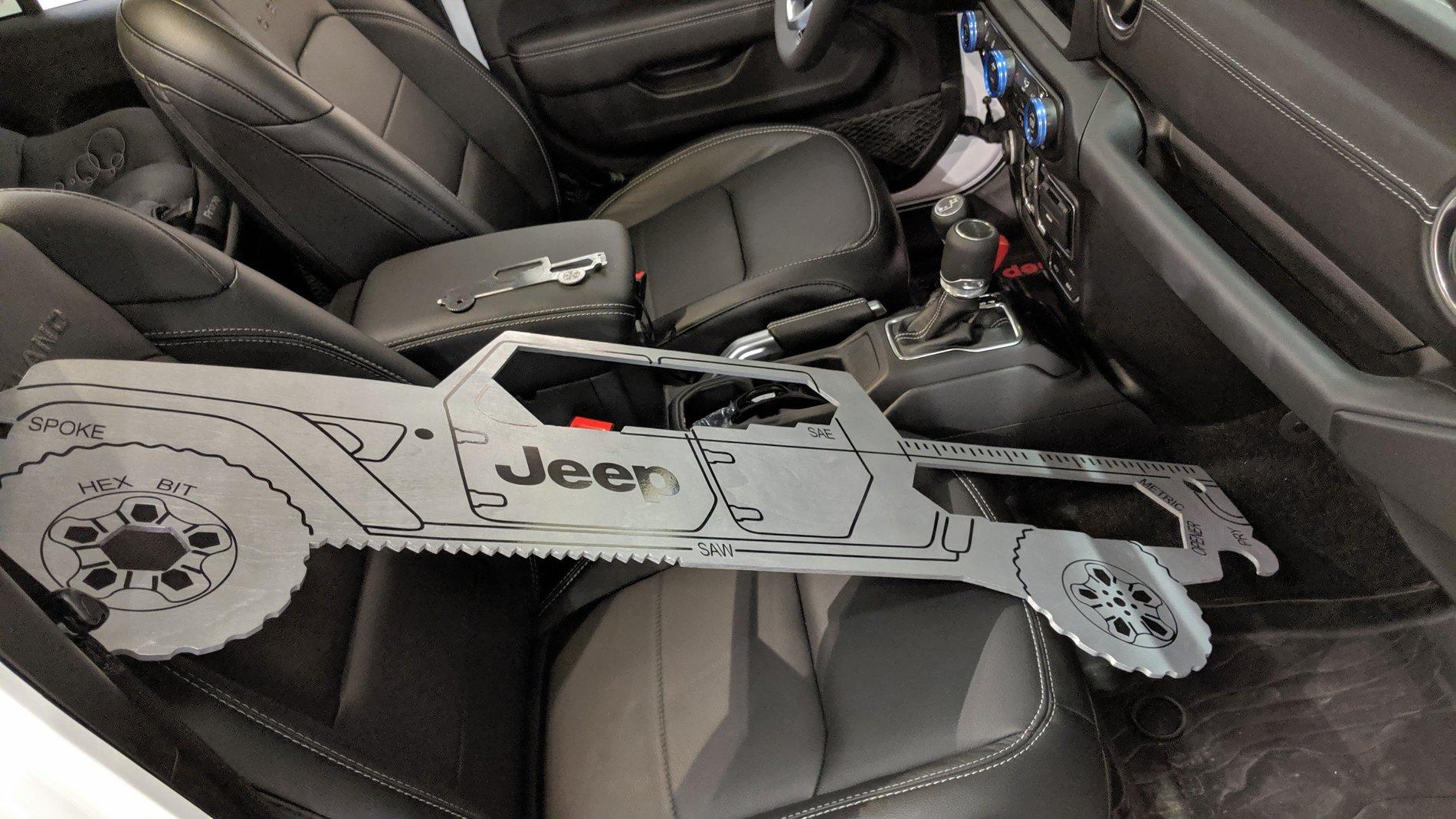

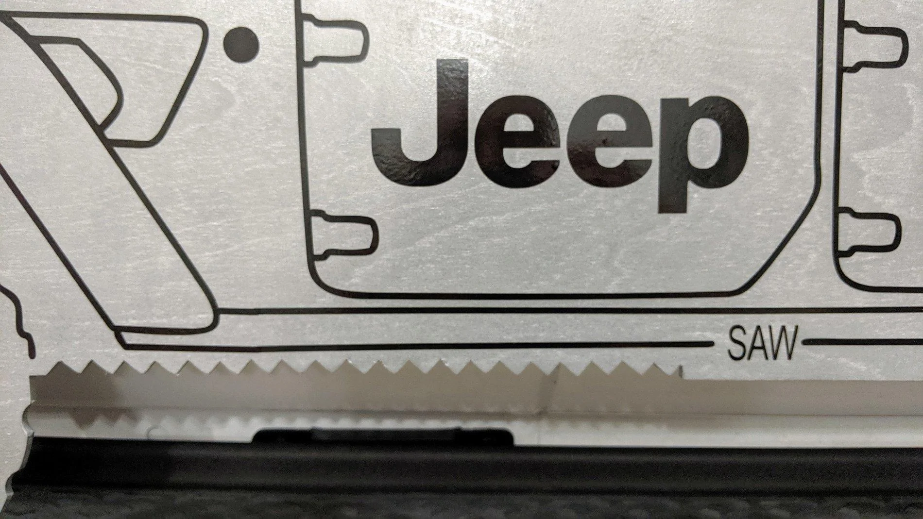

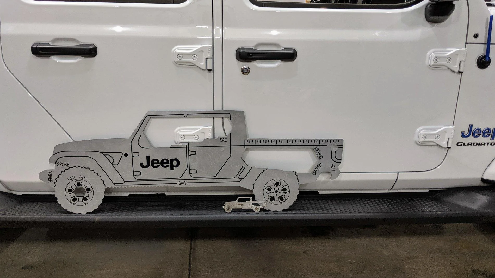

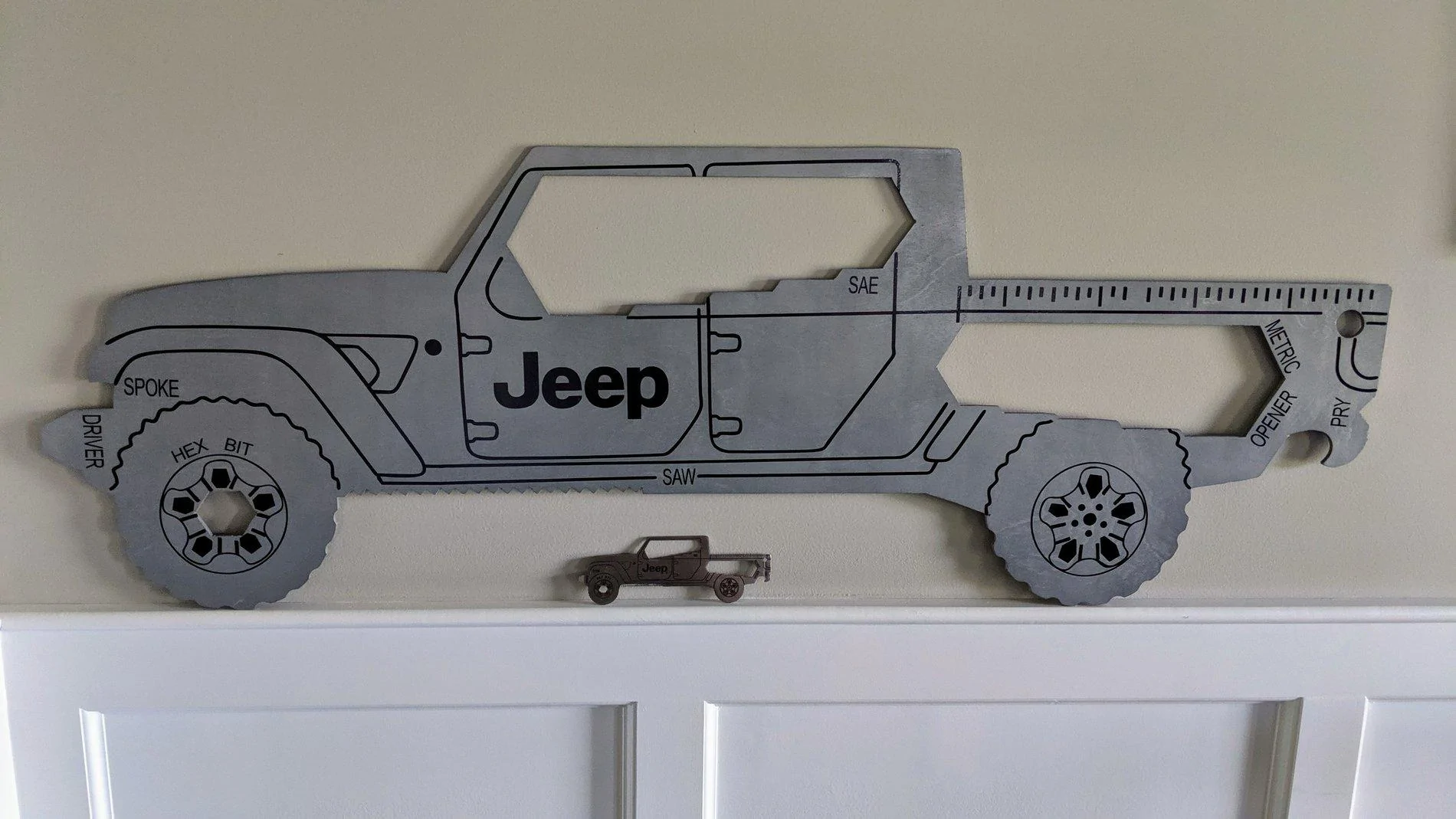

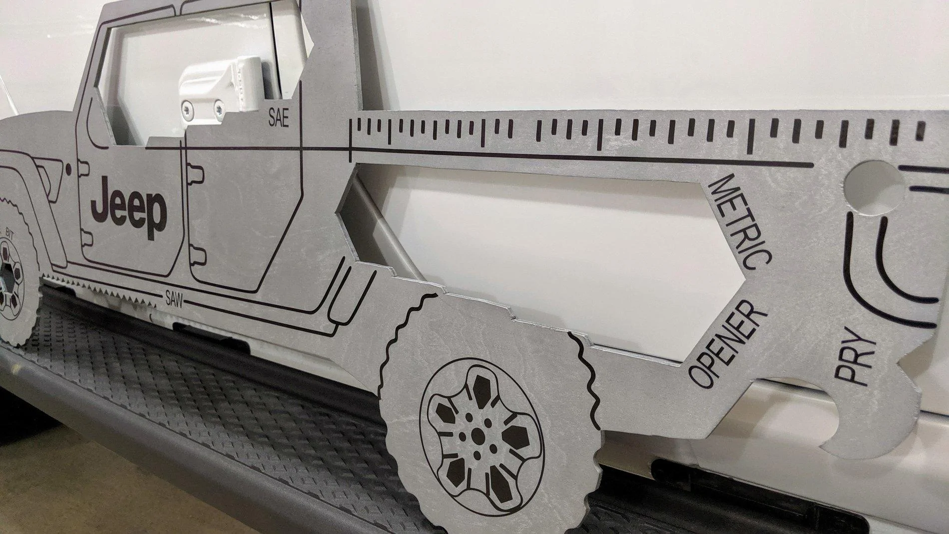

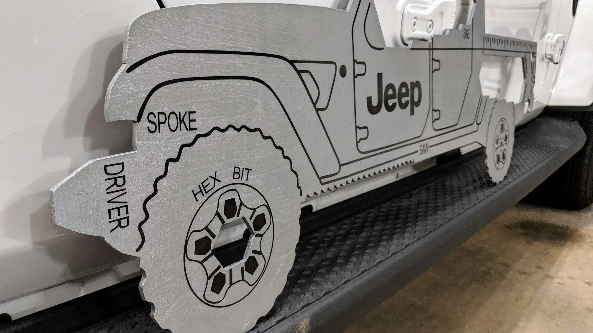

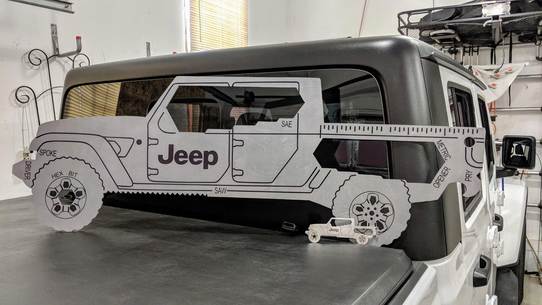

    I was in need for some garage wall art, and having just received my Gladiator Multi-tool the other day, I thought how cool would a massive one of these look on the wall!! And more appropriately for this forum it's made out of PLYWOOD!!
    Here's what I did:
    1. Projected a picture of the multi-tool on a 1/4" 2x4 birch plywood. In pencil I outlined the outside and any holes.
    2. Used a jigsaw to cut out the shapes.
    3. Used a Dremel with a sanding pit to carve the tire treads.
    4. Sanded with 220, primed, and two top-coats using Rustolem Silver Metallic spray paint, then sanded smooth.
    5. Created the decals and lines using Silhouette Studio.
    6. Using a Silhouette Cameo 3, cut the decals and lines using black glossy vinyl (Oracal 651).
    7. Transfer to the plywood, and voila!
    Final piece is 16"x47", almost 7X the size of the original. Here are bunch of pics to show perspective. This thing is MASSIVE:muscle:!

    Very nice!! how did you get the Gladiator tool?

    I ordered a few on ebay. $10 or so each.

    I just want to know how long it took to make that. The detail is perfect!

    Honestly not that long. Like I said, I'm a maker and have been for years. Lots of experience with many tools and design. I started the project at 4pm yesterday and was done at the time I posted this. I do sleep, work, and take care of two kiddos too, so all-in it didn't take too long. I pride myself at being extremely efficient. This video speaks to my beliefs and efforts. Worthy of a 12 minute viewing.

    Bravo! I thought the detail with the dremel was amazing on the treads... For sure I was thinking you used a CAD CAM tool LOL Great job!
