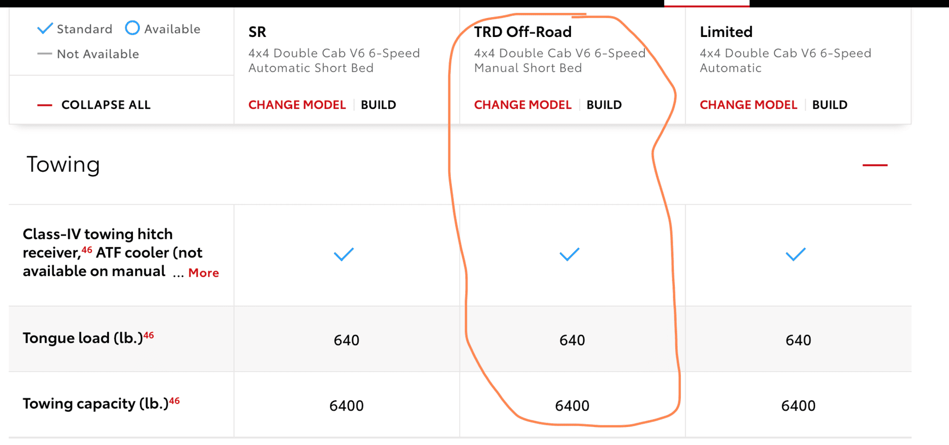

So i need a truck that can tow 5300lbs. I traded my manual rubicon in for a manual Tacoma TRD off road. (6400lbs capacity)
The tacoma ended up being a waste. The thing was terrible offroad. specifically i blew up three t-cases on the trail.
I wheel hard.
