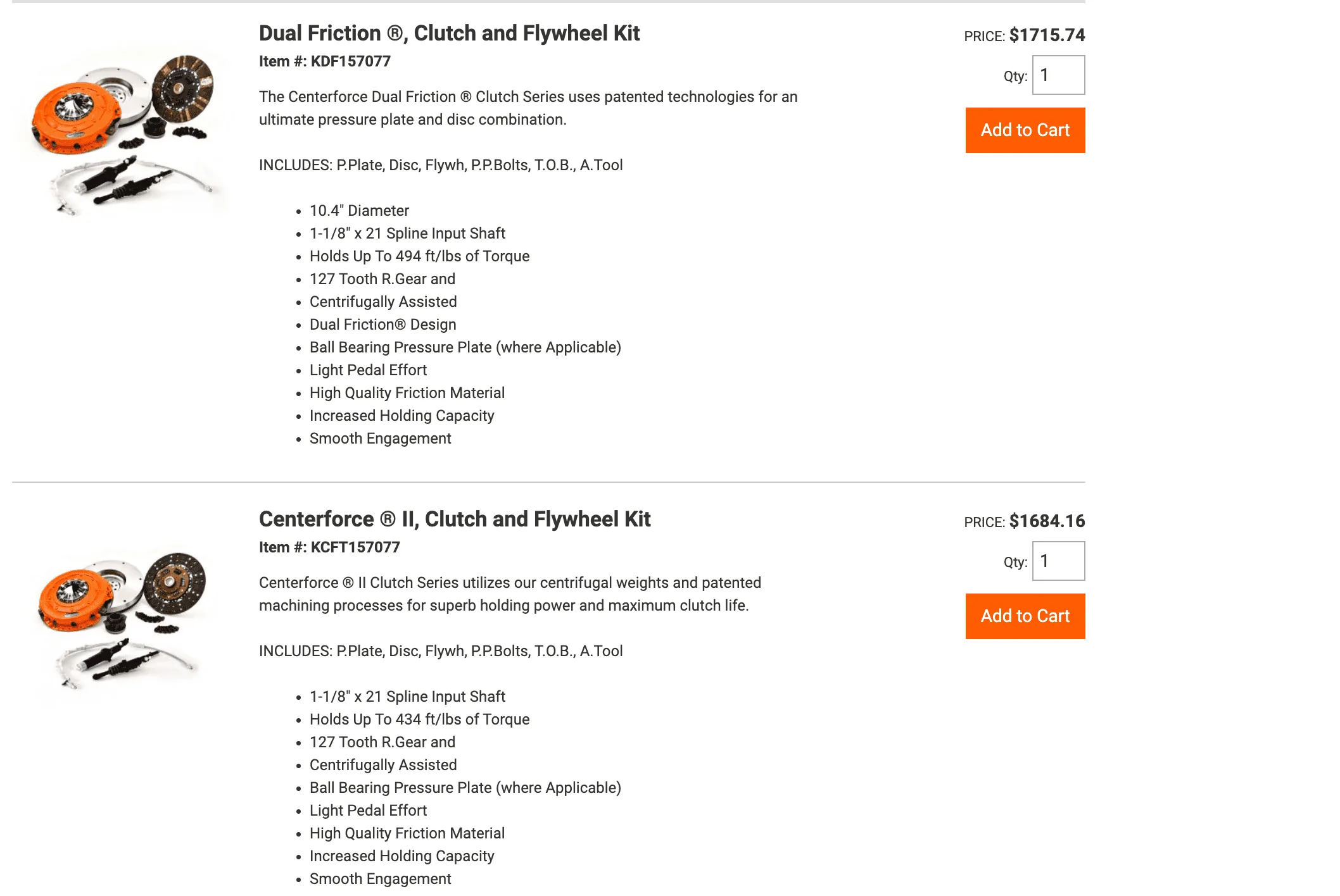

I see two options on CF website for JT. Which one would be better for daily driving?
Jeep Gladiator Manual Transmission hiccup 1674365682515
I have good relationship with my Jeep dealership parts & service here, so I am thinking of getting it done through the dealership itself.
I have the dual friction kit. I tow and off-road. I daily drive and took my JT to Yellowstone and back from Pennsylvania.
The only con I’ve noticed is that the clutch pedal requires more effort than stock. I suspect that a CF 2 kit would be closer to stock. I have not driven CF2 equipped Jeep so I’m not sure.
That’s a long way of saying CF2 is supposed to be more like the factory level of effort and Dual Friction is the heavy duty version. Either version is going to be way better than stock. Good luck!
