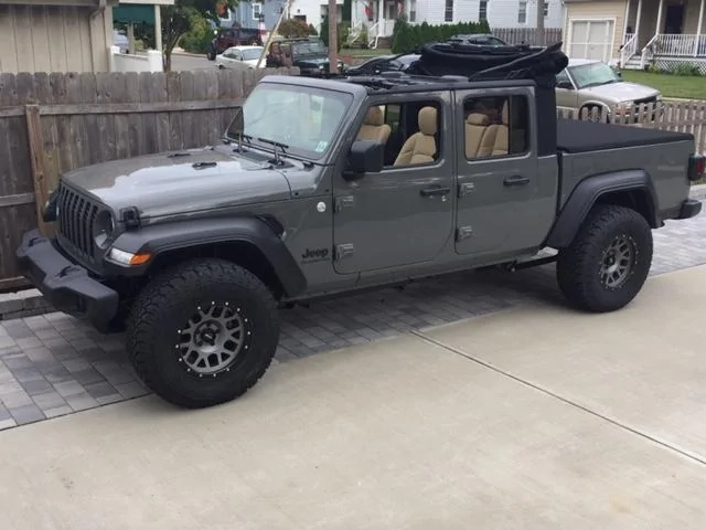

JCJeep1
Aug 21, 2019
257
242
New Jersey Shore
1997 TJ 37" MT Long Arm 2004 Dodge Ram 2500 Cummins 2020 StingGrey Gladiator Sport S Tow
have to remove the wings - 315/70/17 here - (34.5" overall) if your good with a dremel / cutoff wheel you could trim them.
