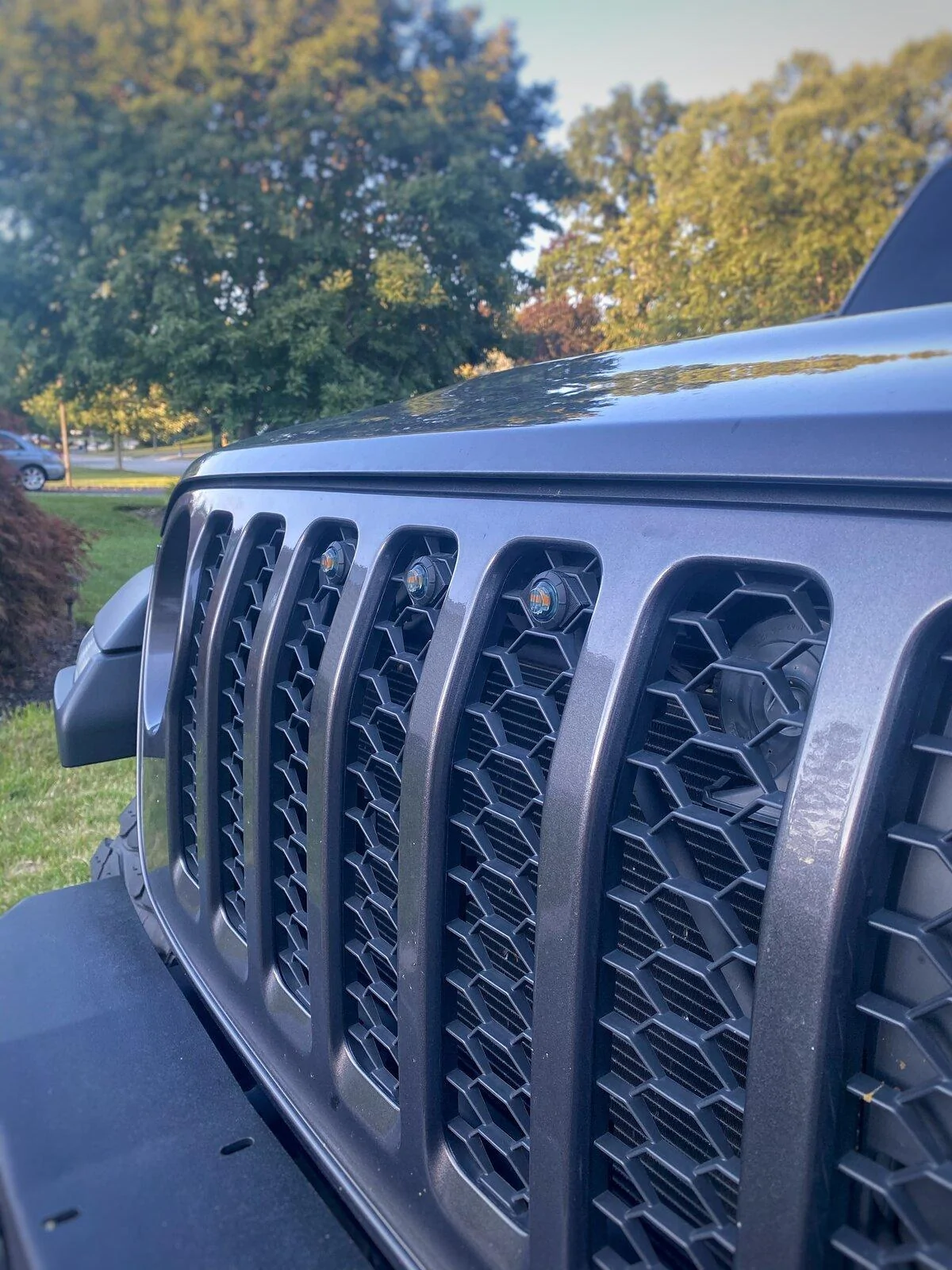

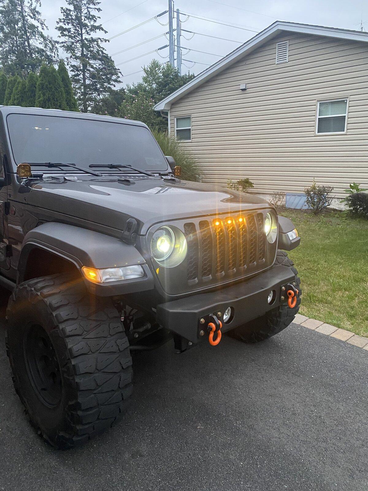

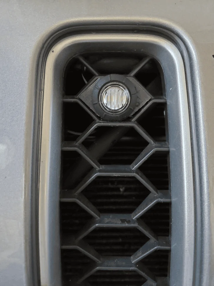

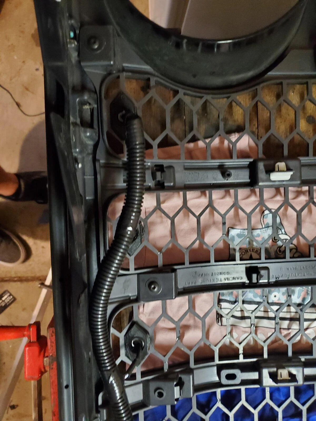

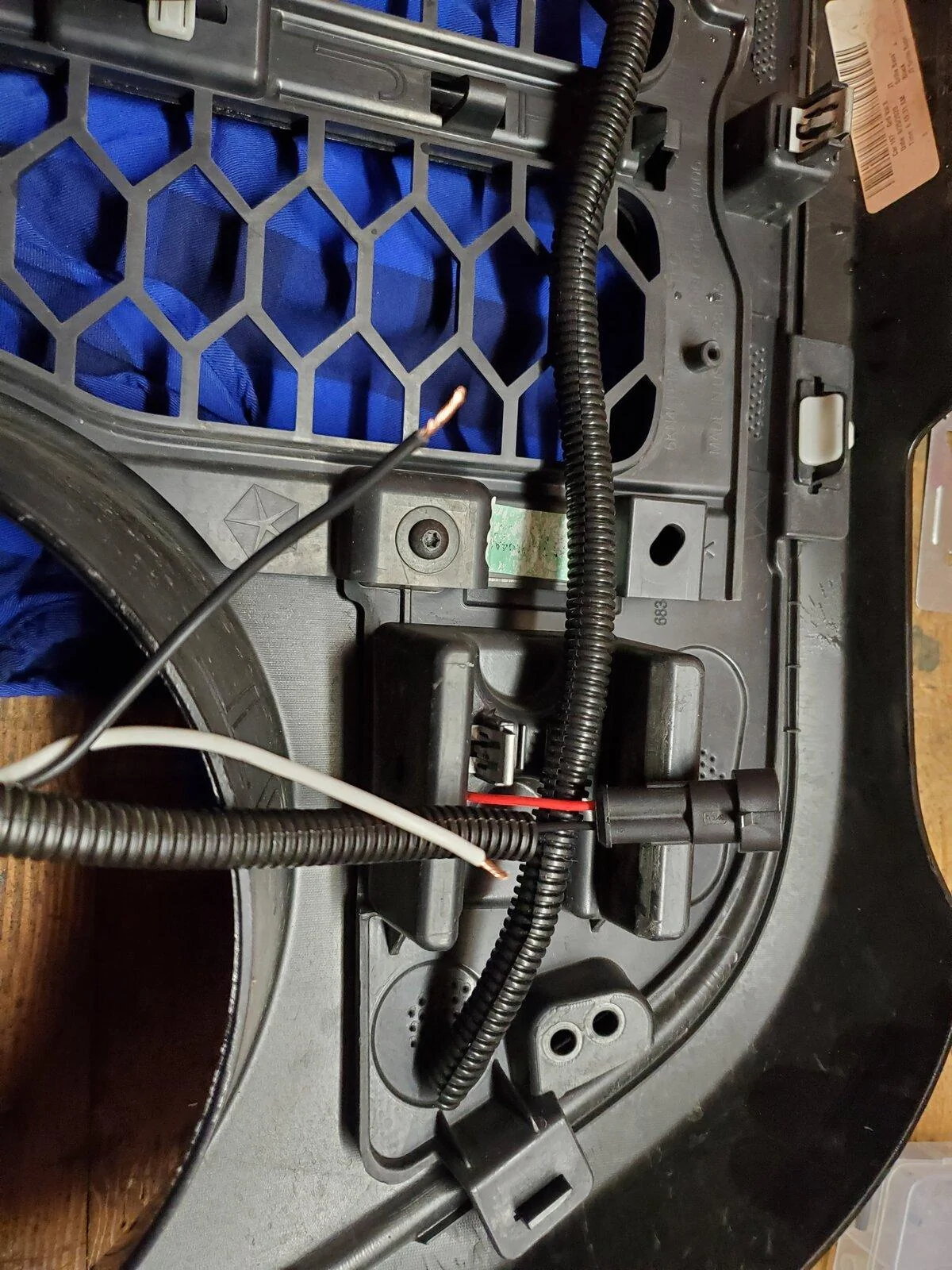

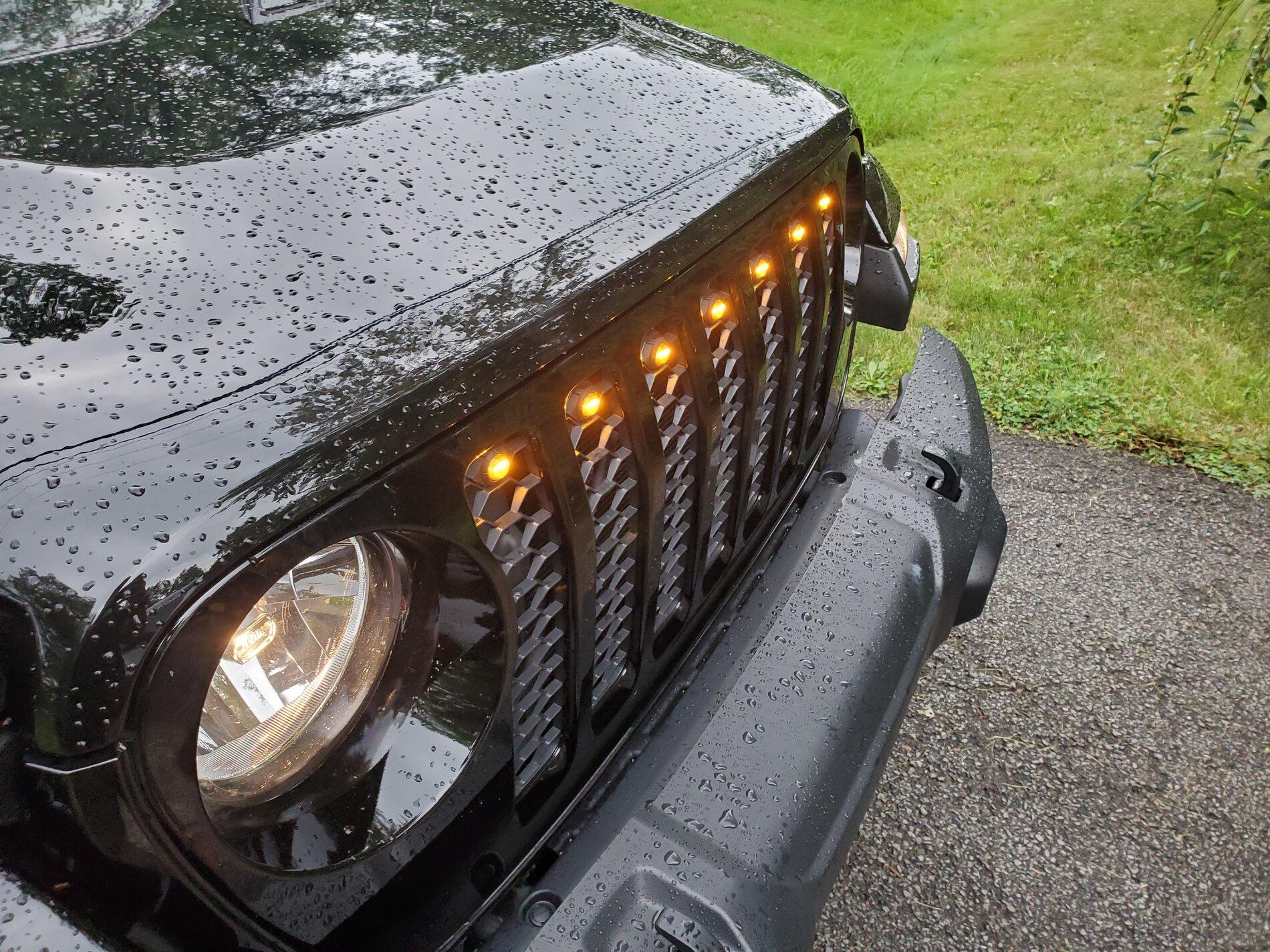

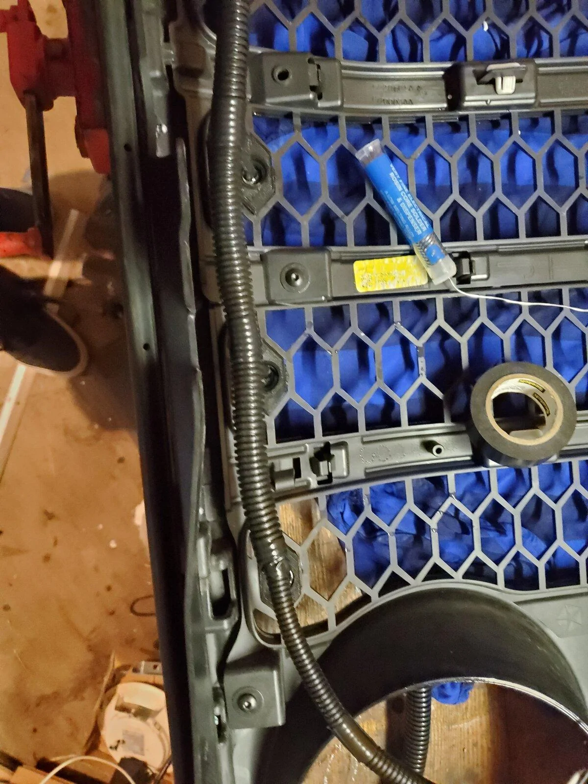

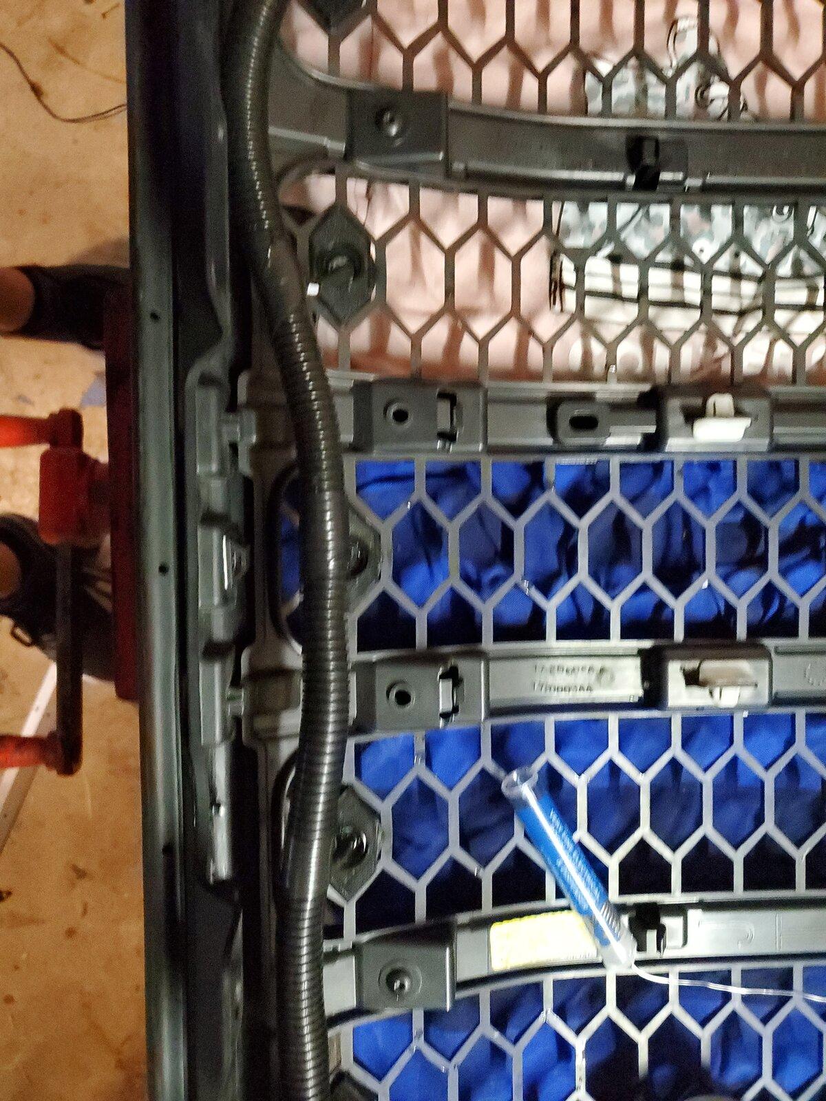

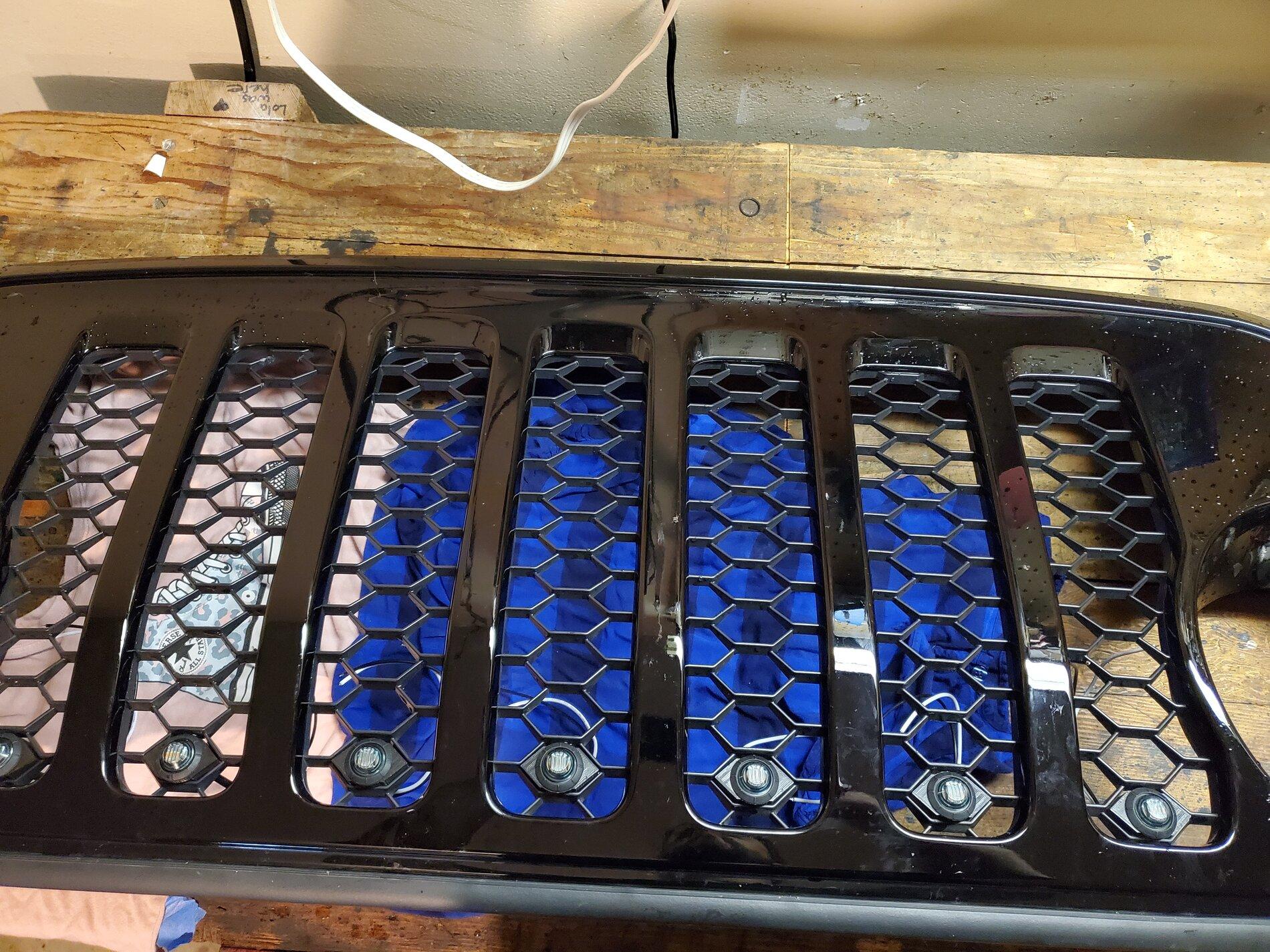

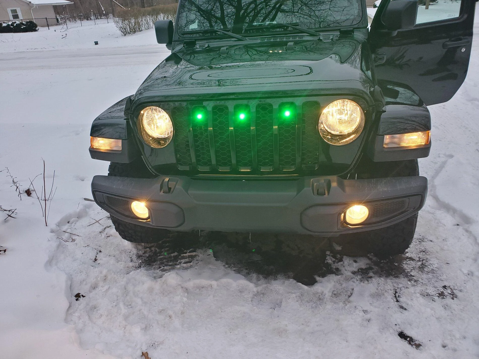

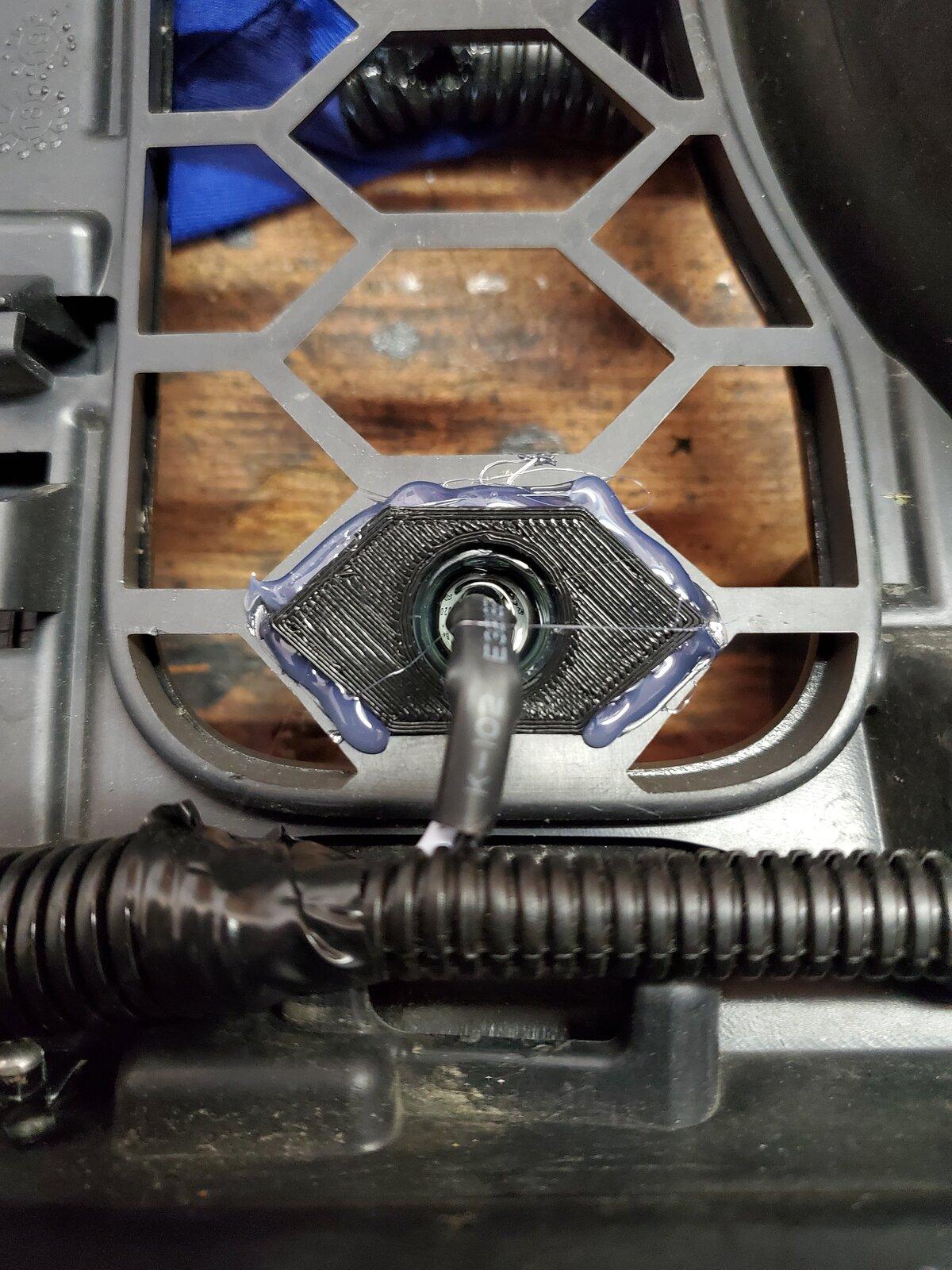

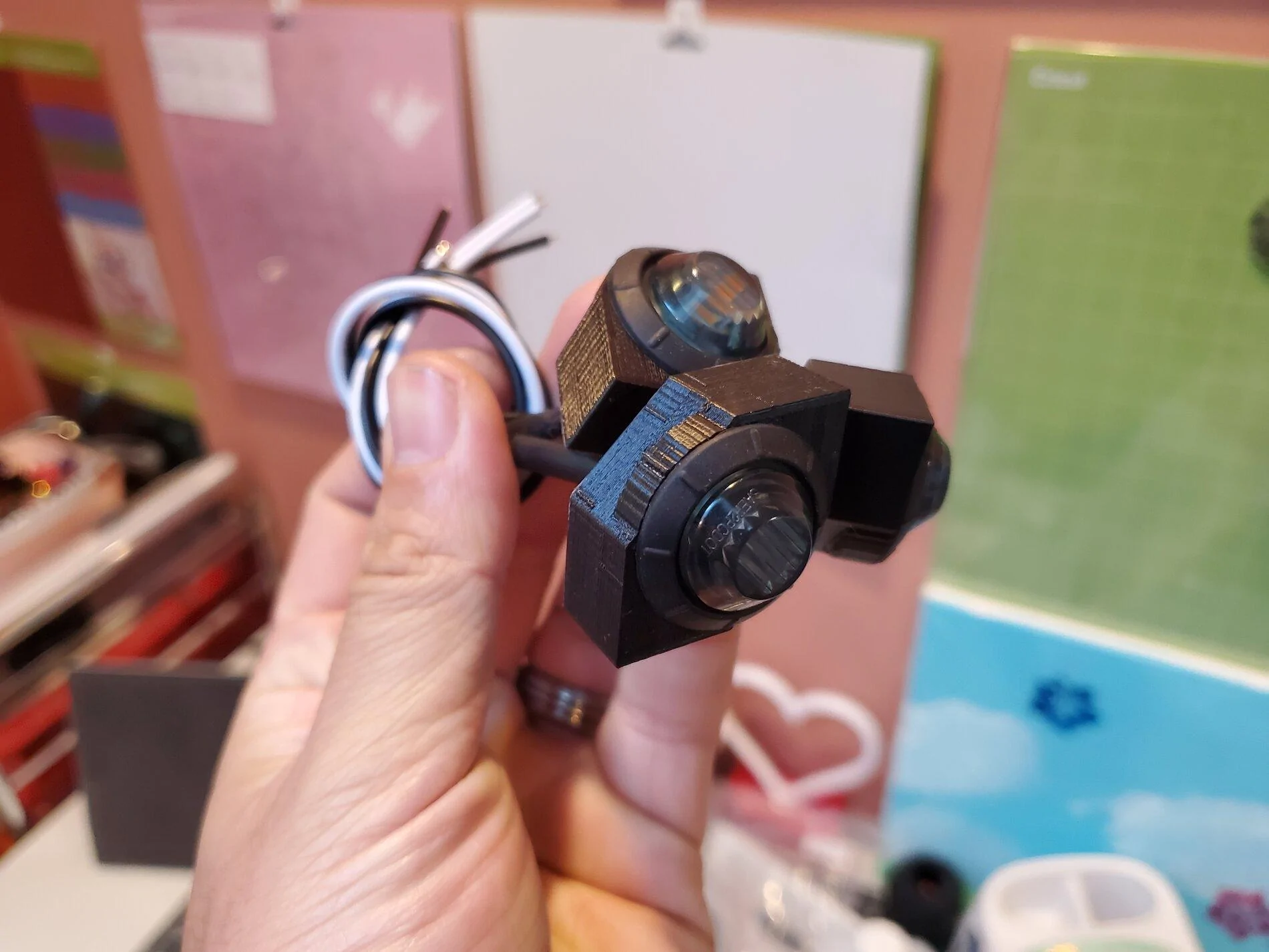

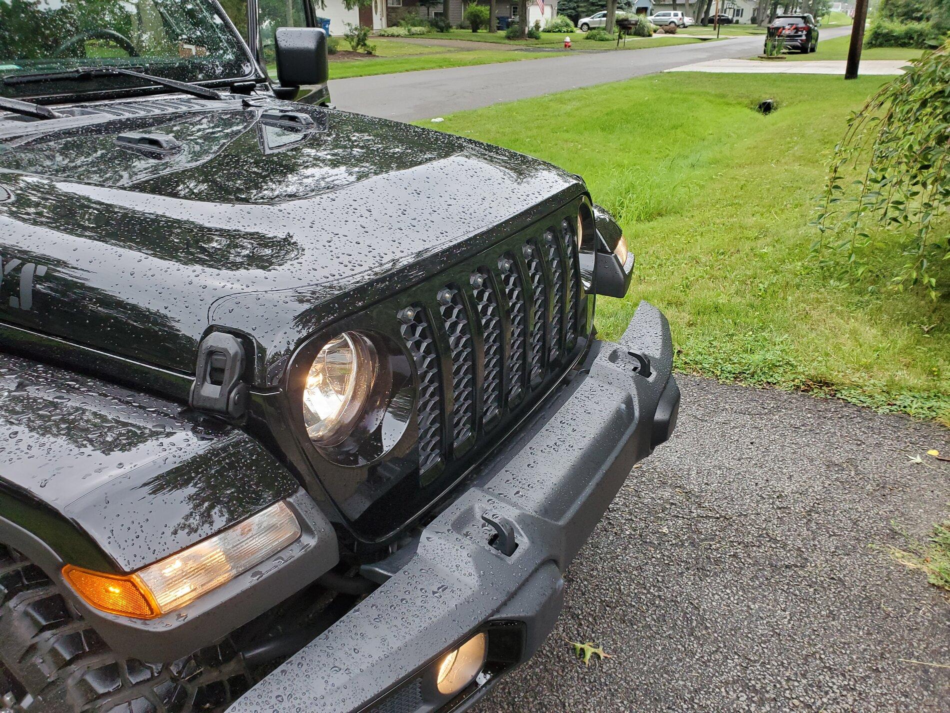

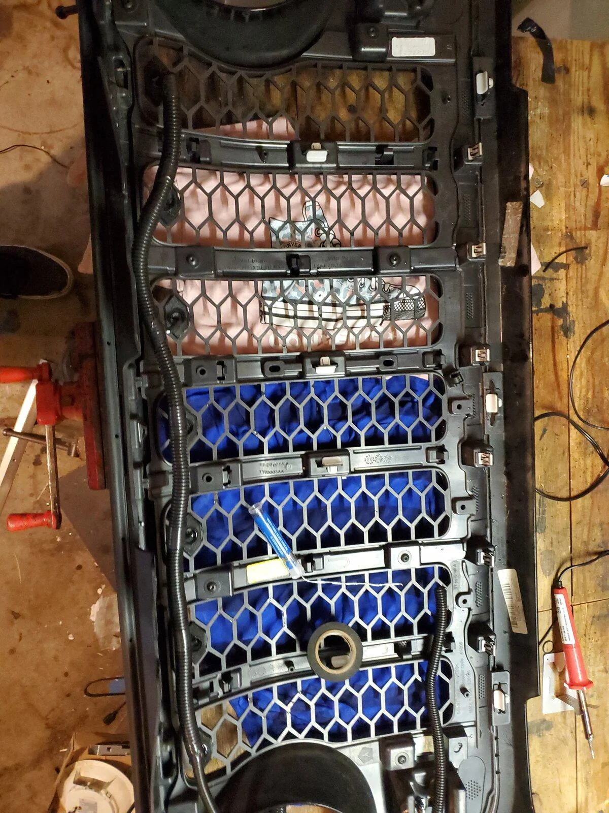

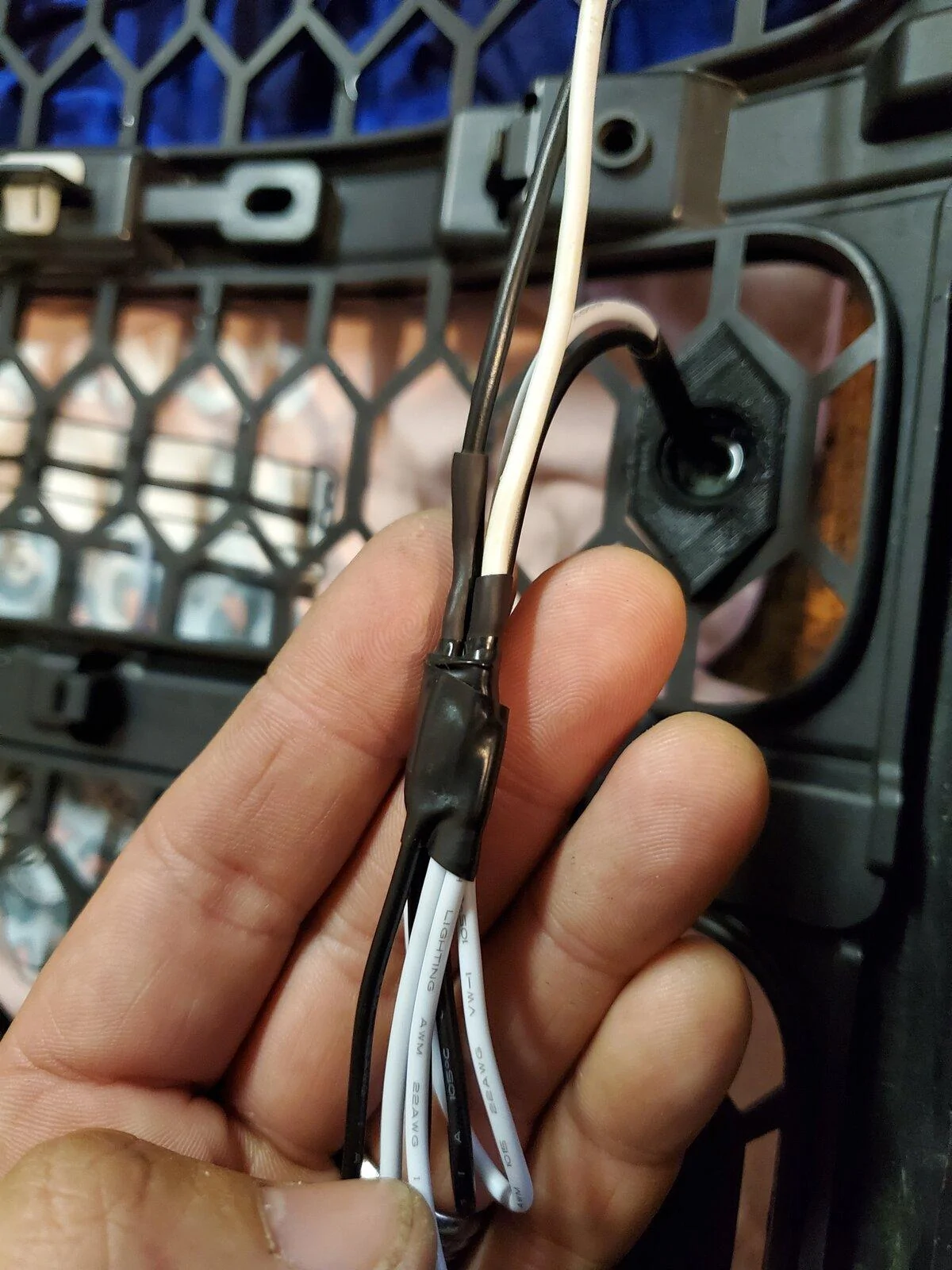

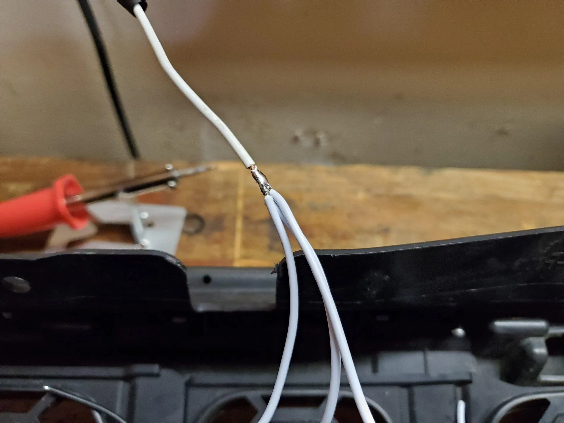

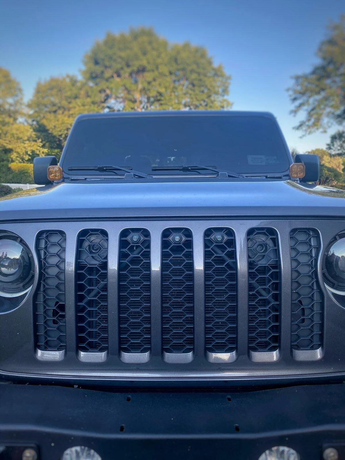

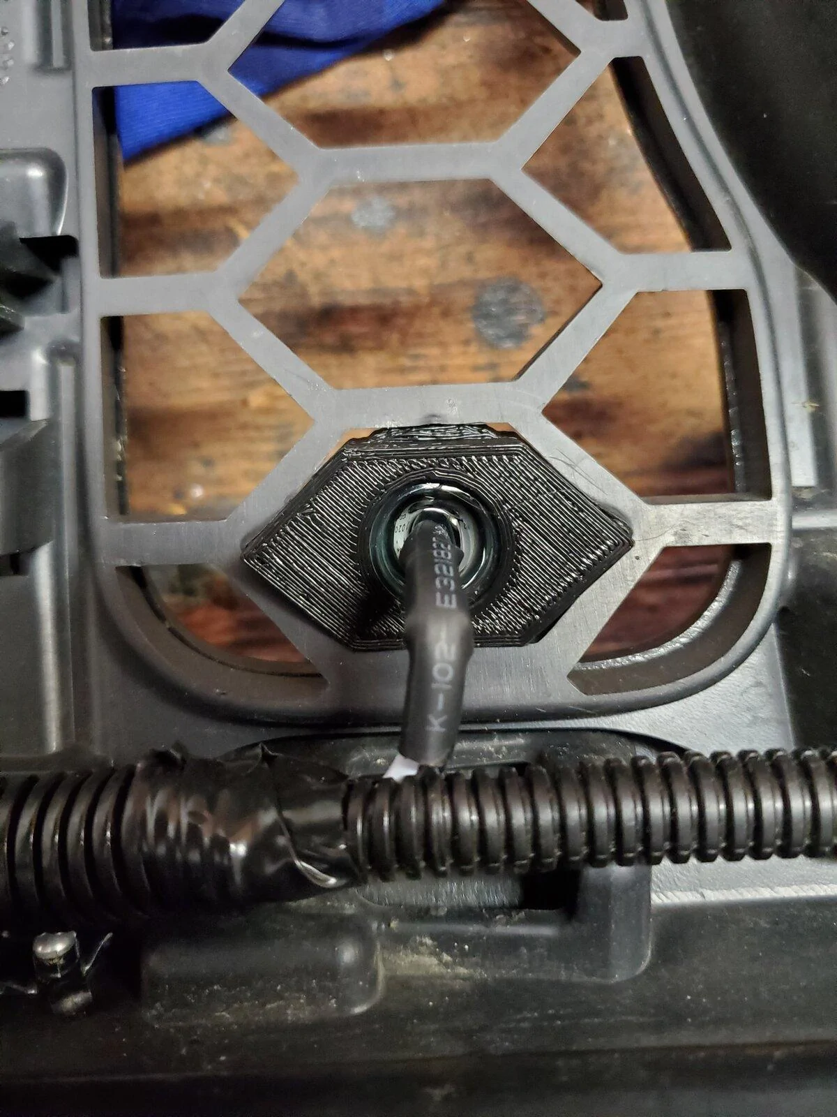

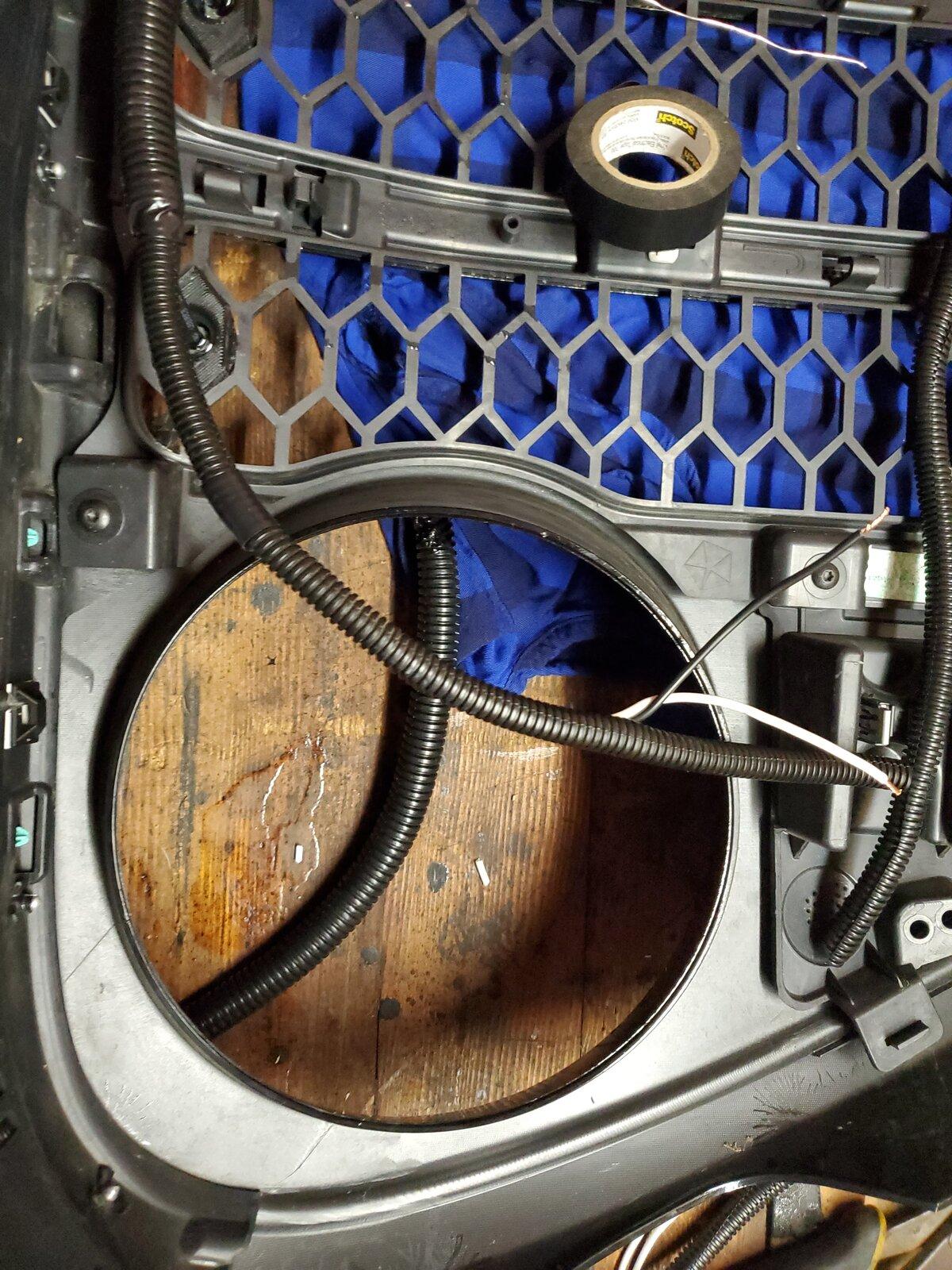

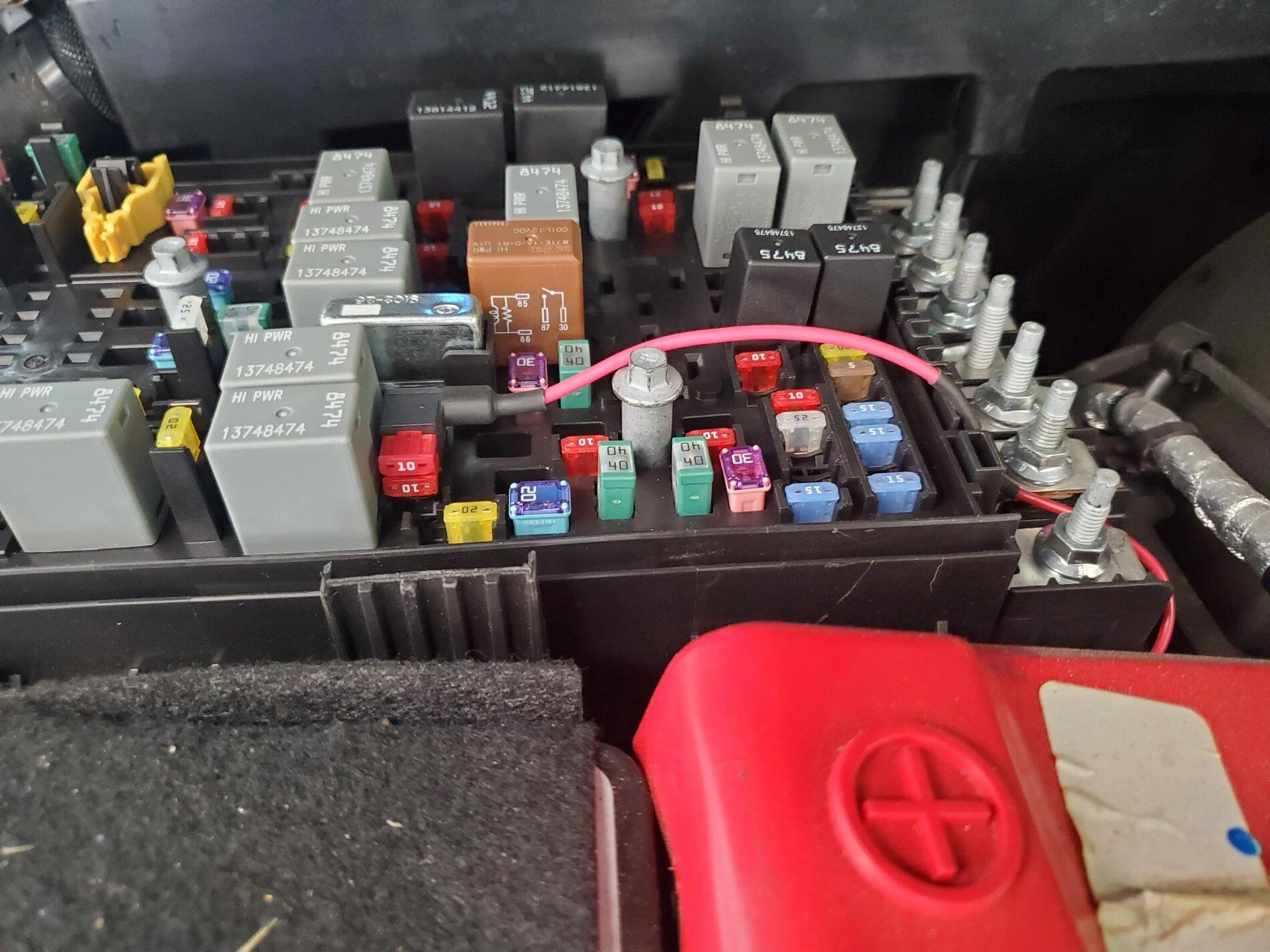

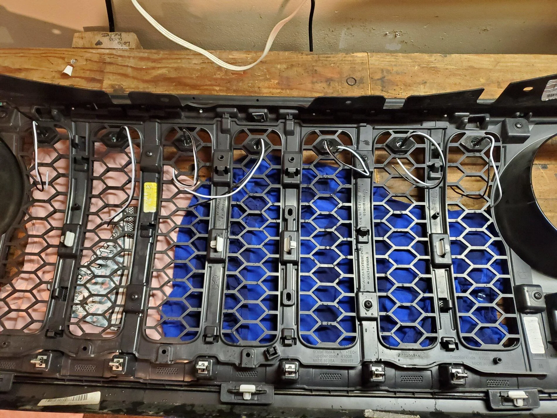

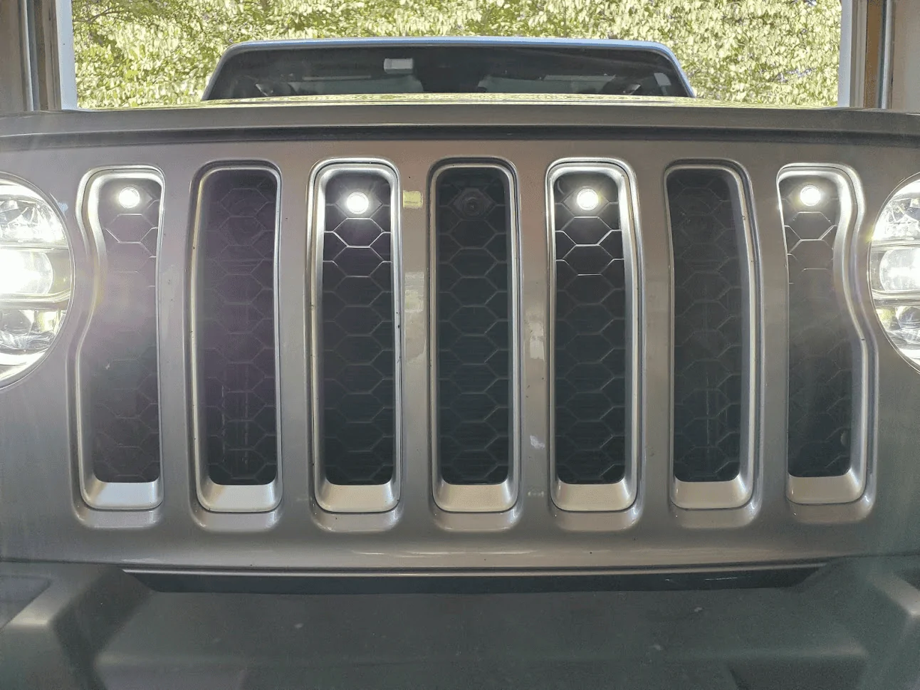

Jeep Gladiator marker lights. Easy to install and easy to wire up. Just grab 10 amp fuse piggy back from your local auto parts store and add them to a fuse that kicks on with the truck(f51 is what I use see image). D.O.T. approved, ip67 waterproof L.E.D lights included. The adapters are 3d printed. Pretty much just press in spot. I do recommend adding a little hot glue to help keep them in. Hot glue is easy to remove. But if you plan on never removing them use something more permanent.
Note:
On some of the lights (+) is the white wire, some (amber, green) it's the black. Just touch wires to battery to verify: 1 they work properly and 2 which way they should be connected. You won't hurt the light plugging them in backwards but they won't work in reverse. They will all match when you get them. Also this is for the honeycomb grill only. You need the one in all the pictures.
Available colors:
Red, white, blue, green, amber. The white ones are not smoked lenses but the rest are. Will make any combination you want of colors.

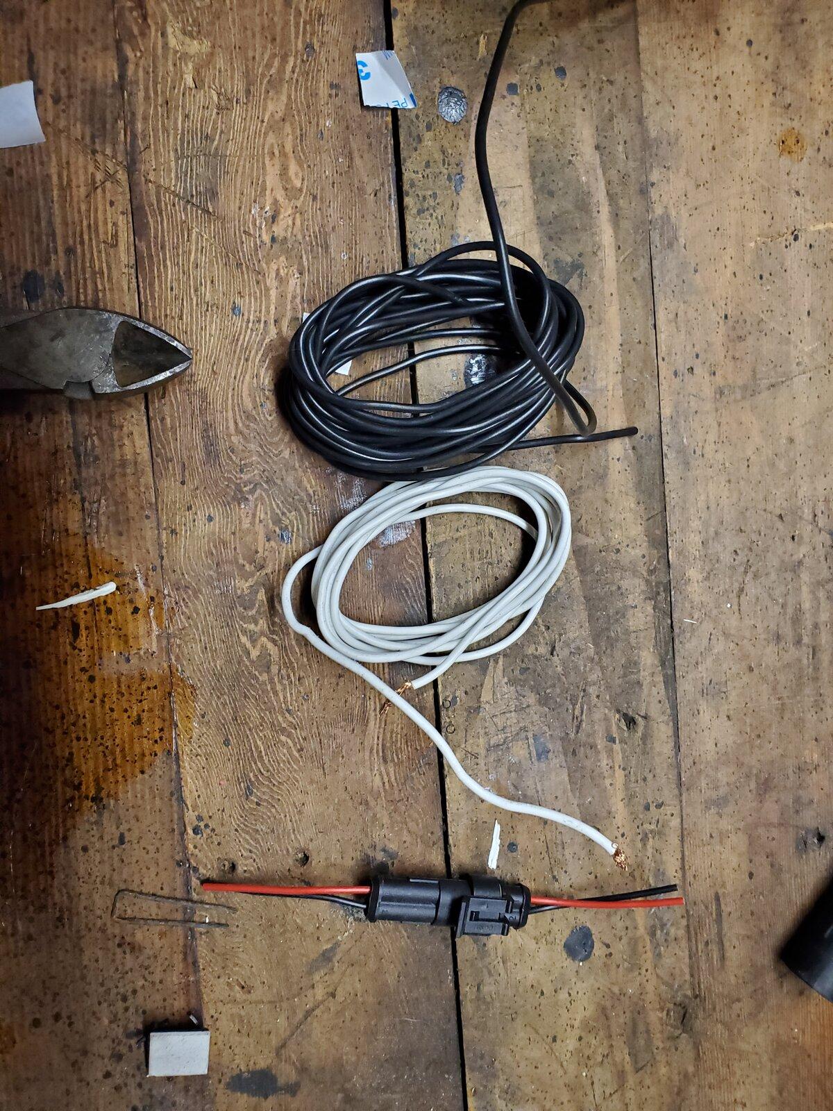

Stuff needed:
Wire (2 x about 3 feet)
solder or crimp connectors
electrical tape
Wire insulation (not mandatory)
fuse piggyback
2 wire connector (not mandatory)
Hot glue gun (not mandatory)

Jeep Gladiator Marker lights. 20210729_101502
Jeep Gladiator Marker lights. 20210729_101416
Jeep Gladiator Marker lights. 20210729_101549
Jeep Gladiator Marker lights. 20210729_101601
Jeep Gladiator Marker lights. 20210729_101545
Jeep Gladiator Marker lights. 20210729_101606
Jeep Gladiator Marker lights. 20210729_183543
Jeep Gladiator Marker lights. 20210908_171203

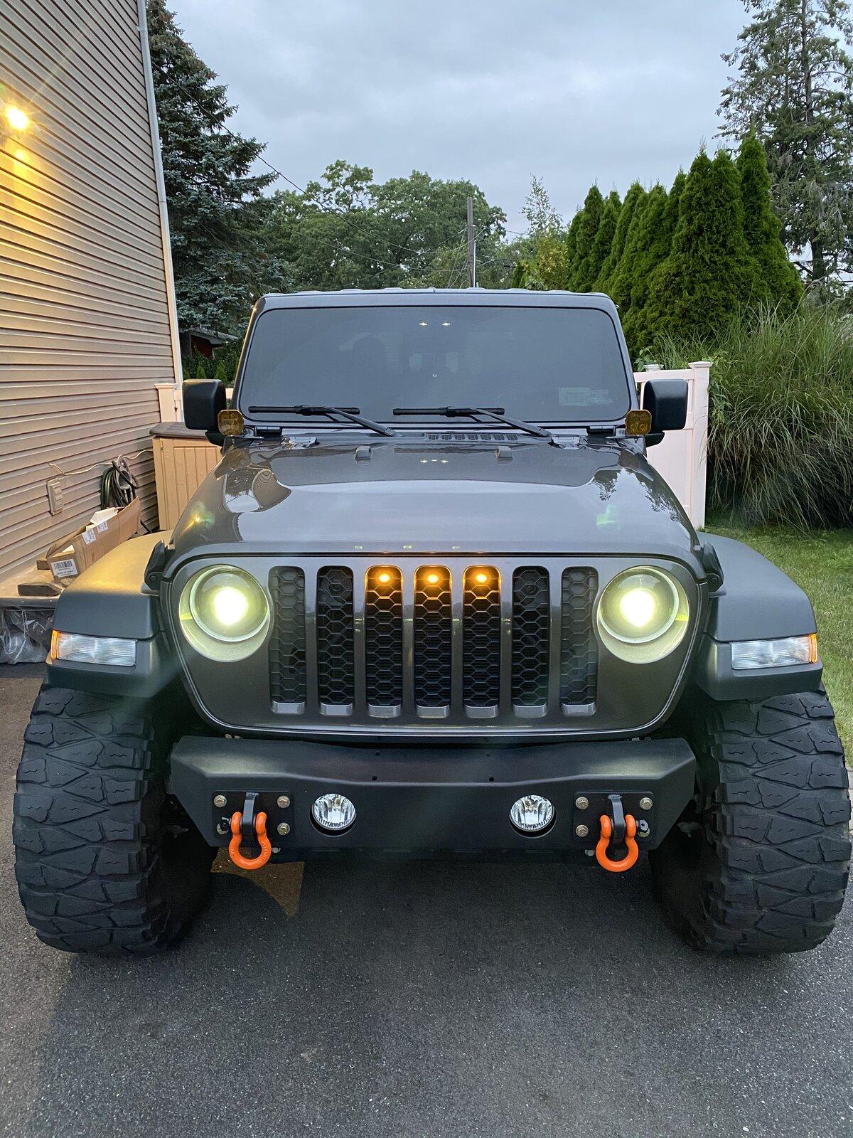

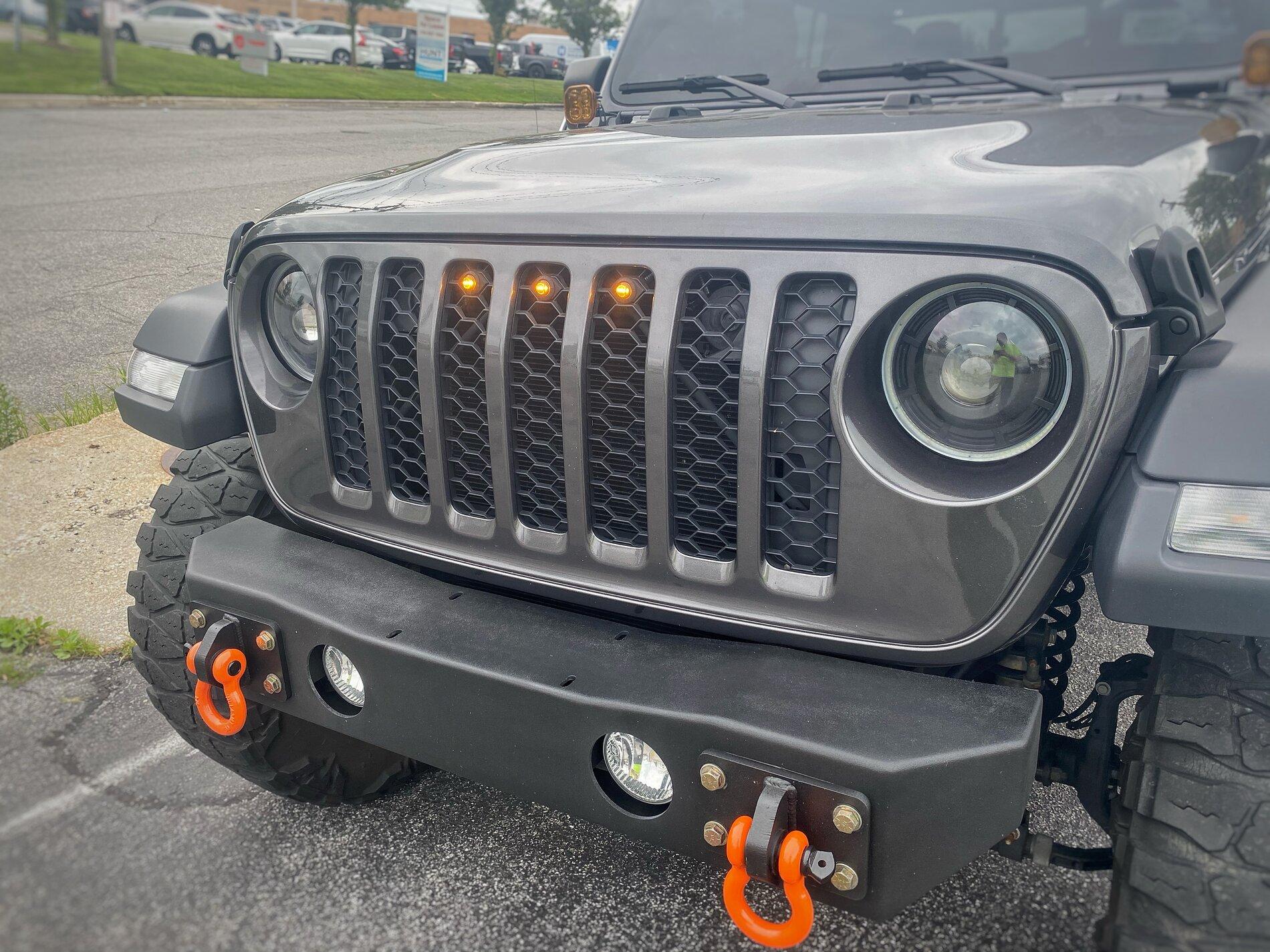

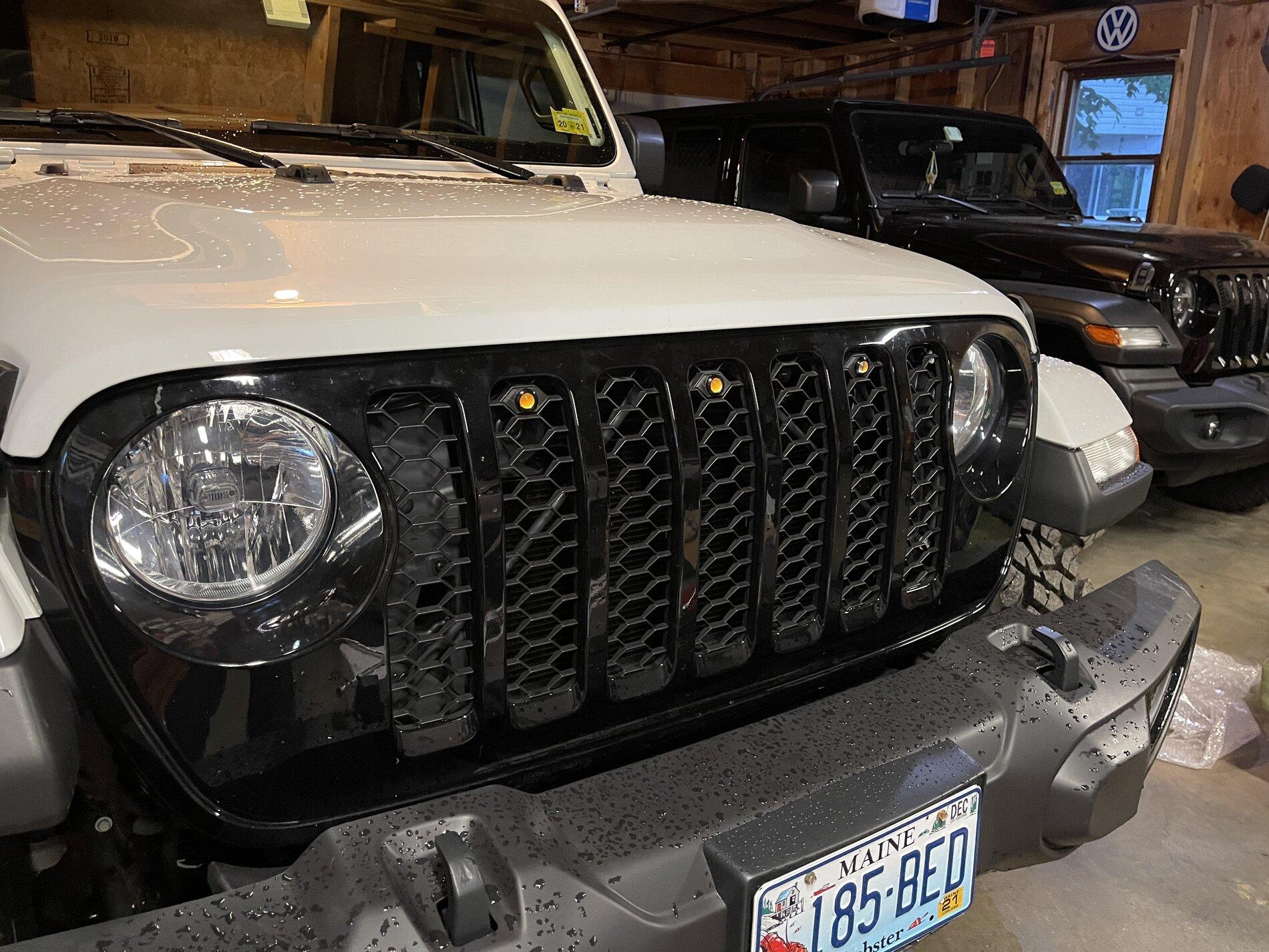

I also am quite happy with these lights on my Gladiator. Fits the larger hole grill perfectly.

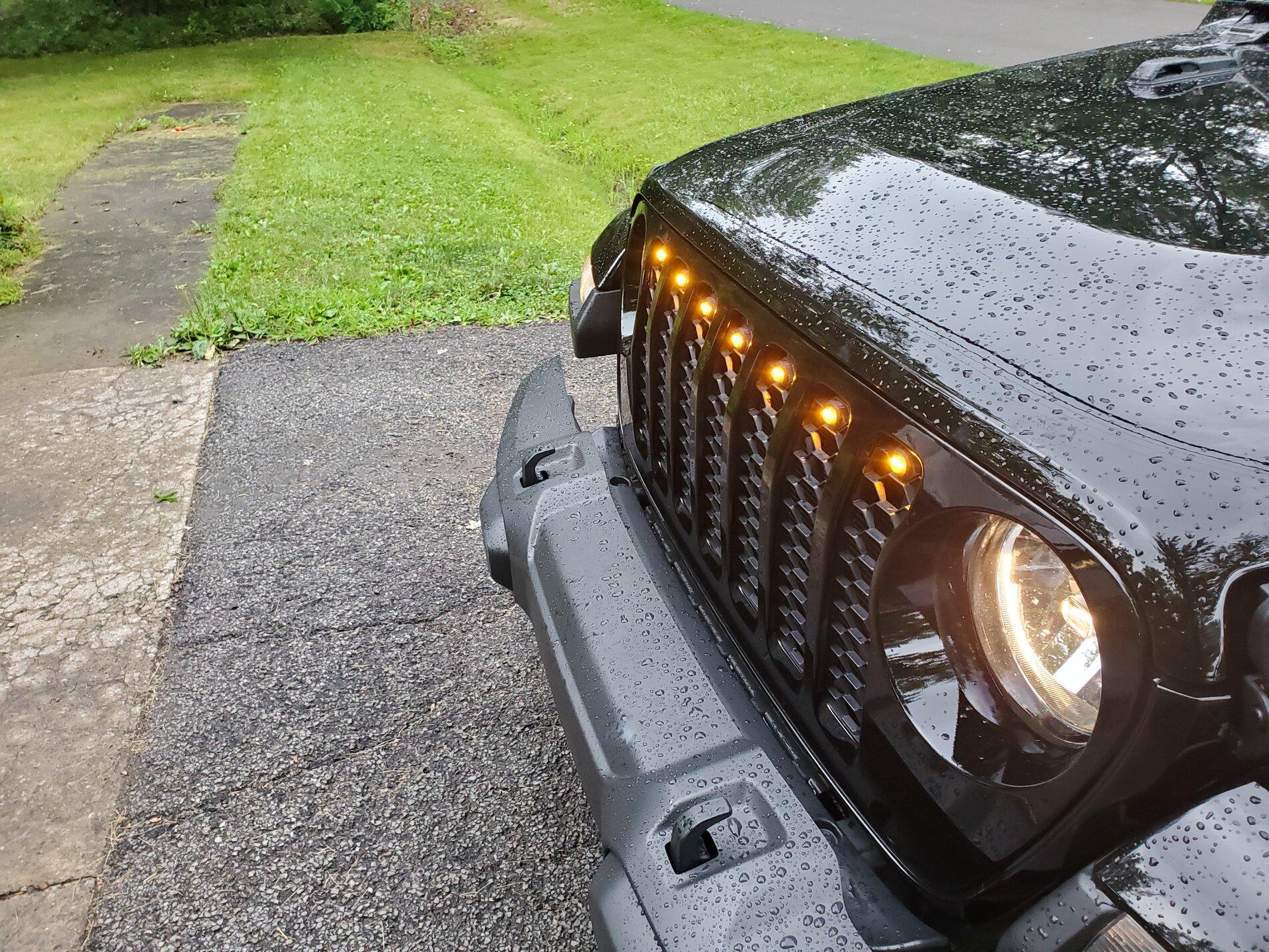

How do they hold up in bad weather?
What’s the difference between yours and Oracle’s runner lights?
The lights I use are the common 3/4" lights you find on semi trucks. They are ip67 rated I believe. The biggest difference is they are D.O.T. approved, so street legal unlike oracles. Plus my oracle lights didn't last long. If you ever have to replace a light it's much cheaper then oracle and can be found at autozone or really any parts store.
But also oracle uses giant washers to hold the lights in place. I was selling the 3d printed inserts without lights for the oracle ones but have stopped and now only sell these. I suppose I would sell a set for the oracle lights but I just don't think their lights are good quality.

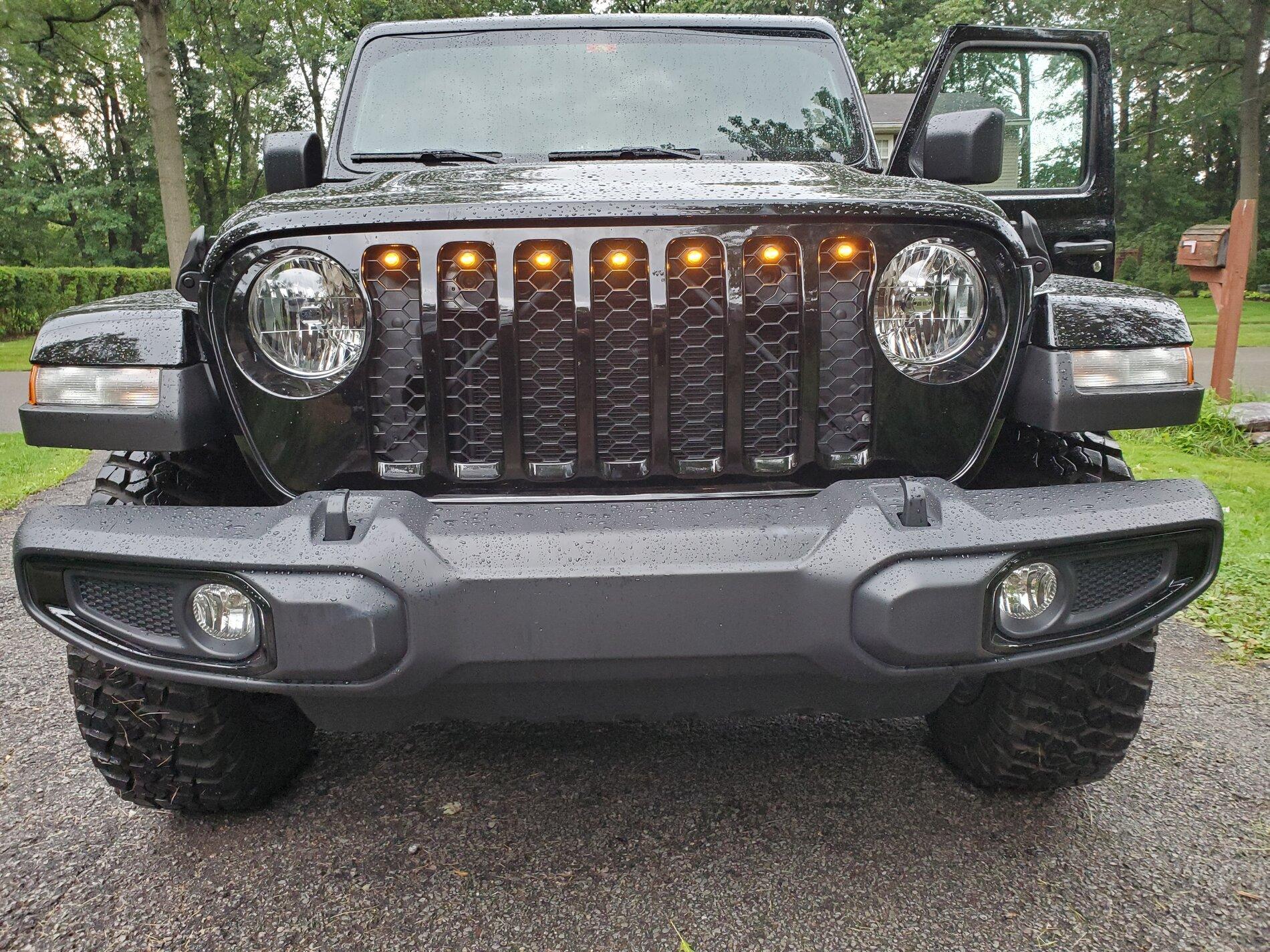

I also have nothing but good things to say about these! I love them. Fitment is factory like. Doesn’t look like every other cheap thrown together kit. If I had to I’d buy them again!

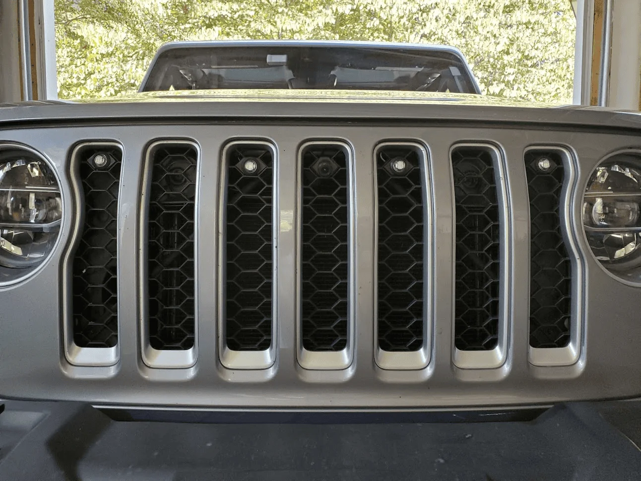

Just some more examples.
