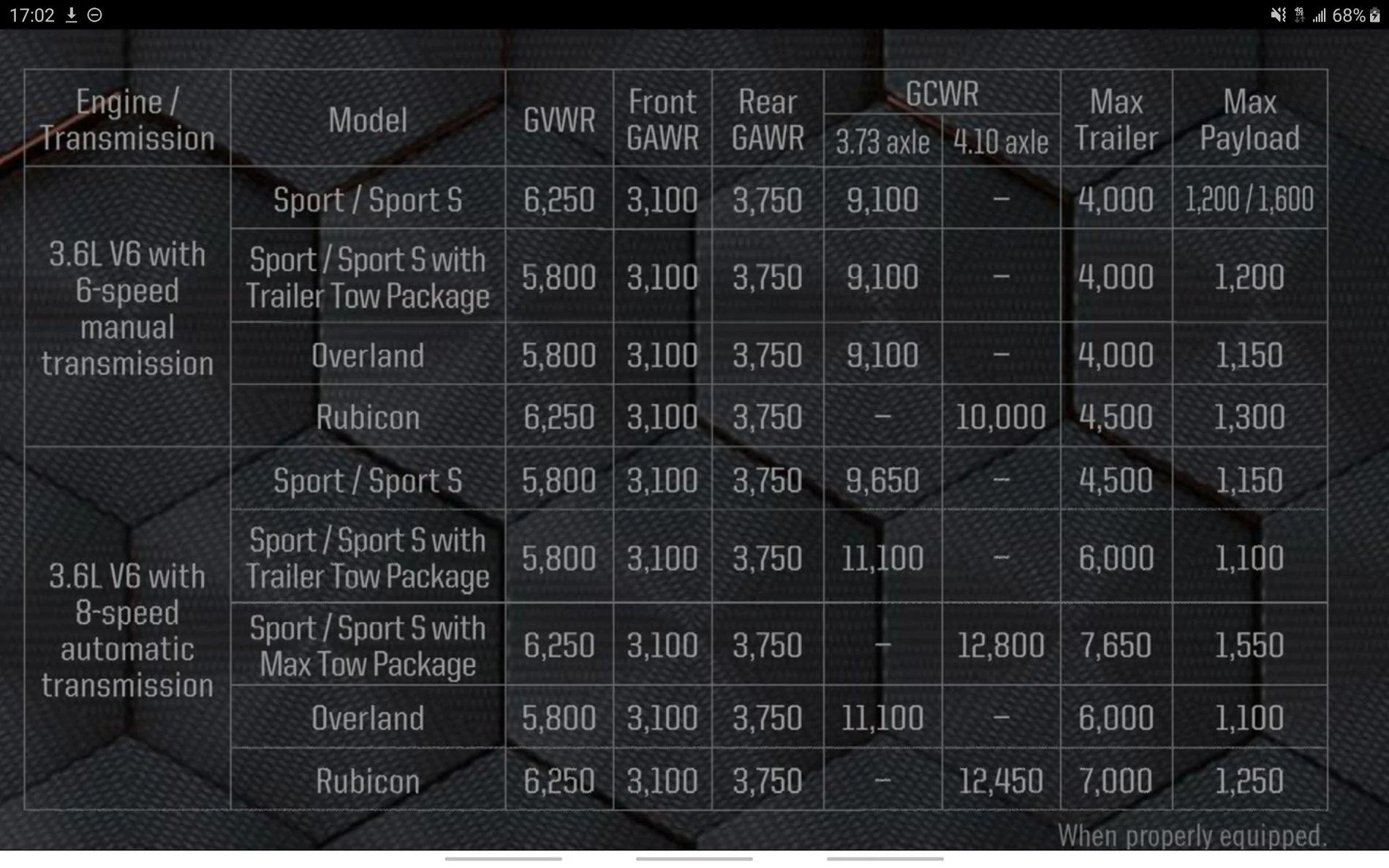

I've beed doing a bit of research yet I cannot find an answer. What configuration of Gladiator does it take to get the max payload? 1,600 LBS
The Manual only has the definition of payload on page 350... haven't been able to find an answer in here.
This dark screen shot is from the web based gladiator brochure and it seems like the base sport doesn't get the 1,600

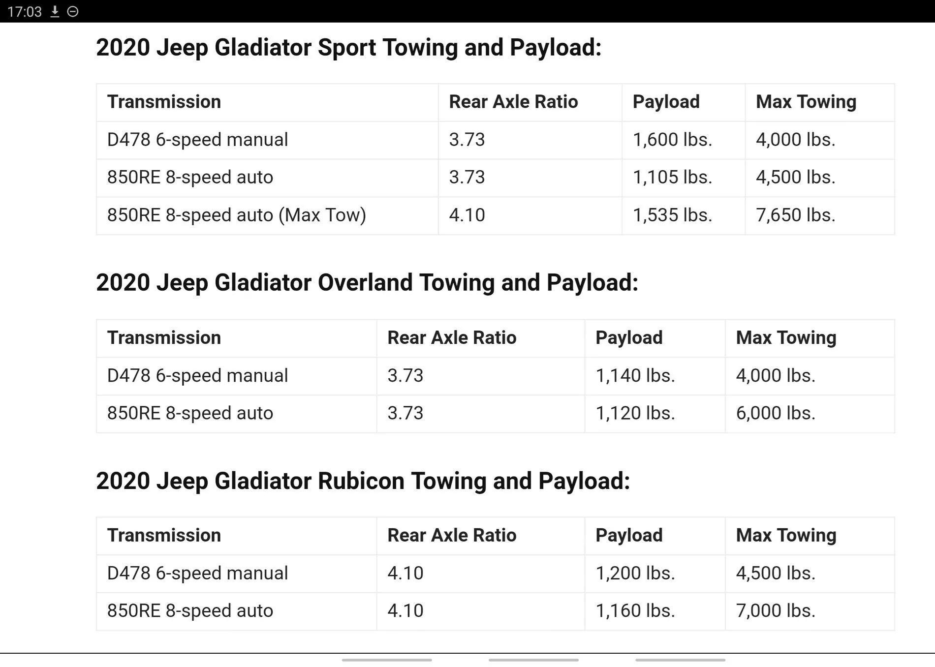

this light screen sot is from TFL Truck and they only say D478 Manual, that's what I first saw so I was hoping I could get the base sport and have the 1600 payload
anybody know what D478 stands for?

I've been puzzling over this as well. The brochure seems to indicate that max payload is only available on a Sport S with manual transmission and no tow package. The next line down shows a 450 lb drop in GVWR with the addition of the tow package (no idea why this would be). The TFL chart makes no mention of the base tow package, but implies that any Sport with the manual can haul 1600 lbs. I'd be very interested in some confirmation about how these options affect payload. It's not like those of us custom ordering one can look at the "official" placard on the door before making a decision.

Actually, no, both sources above indicate that max tow results in a slightly decreased payload. That makes sense since the wider axles, beefier components, and mandatory slushbox will add weight. Jeep has advertised from the beginning that max payload is 1600 lbs and both sources above indicate the same. The question is which build options give you that max payload.

Okay, stand corrected, payload of Sport S with max tow is 1550
The 1600 looks to be Sport S with Manual transmission according to the chart

I should have clarified that I can see that there are probably two sets of springs available - softer ones that give you a 5800 lb GVWR and stiffer ones that give you a 6250 lb GVWR. The Sport S manual, either Sport max tow, and Rubicon get the stiffer springs. The other trims get the softer ones. What I don't get is why a Sport or Sport S with the regular tow package would be downgraded to the softer springs. It's probably more wishful thinking that the minor differences in the two sources above indicate there's a chance a manual base Sport with regular tow package might actually get the stiffer springs :)
correct! which build/configuration gives max payload? manual transmission sport, sport s or both?
what is confusing me is the top row of this... " / " means "or" to me
Sport / Sport S = 1,200 / 1,600
so the base only has a 1200 pay load and you have to upgrade to sport s to get the 1600?
or does that top row mean both sport and sport s get 1600 without max tow and 1200 with max tow?
its interesting in the manual block (top half) they only specify trailer tow but in the automagical (bottom half) they specify both max tow and trailer tow package
Max tow requires the auto
What doesn't make any sense to me is the payload drops if you add the tow package. You would think the extra cooling would help. I don't get that
