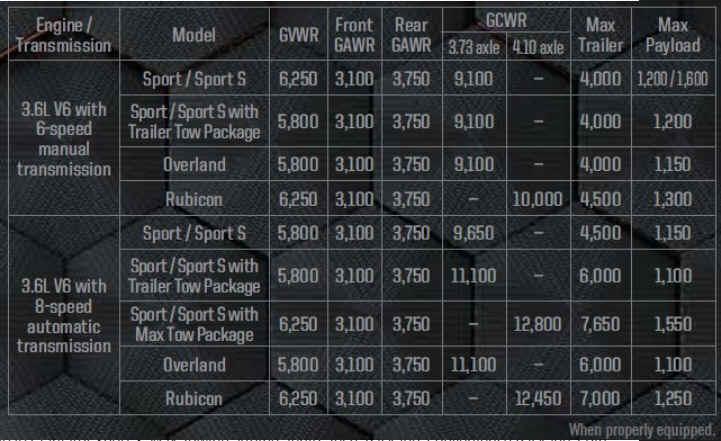

What are the max payloads of the different models? I looked online, and it conflicts with what’s on the door jam of my Overland w/Tow package.
Online I have see Max Payload of the Overland being 1,120.
https://www.tfltruck.com/2019/03/2020-jeep-gladiator-towing-specs/
The door jam says 1,045 if I am reading it right.

That's about right for an Overland. The one I test drove was listed at 1,053 lbs. payload. It's pretty miserable to try and use something like that as a truck. With a 200 lb. driver it immediately drops you to 853. Throw a wife in there and you're below 700 lbs. of remaining payload. Ouch.
Here's the best chart I had found up until the second edition of the owners' manual was released.
