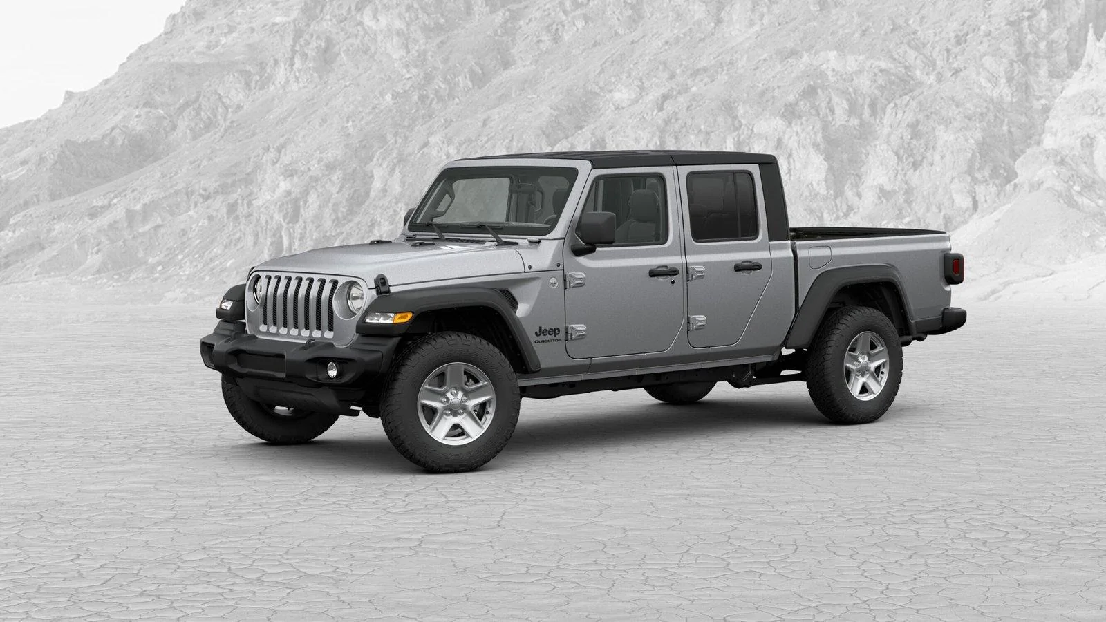

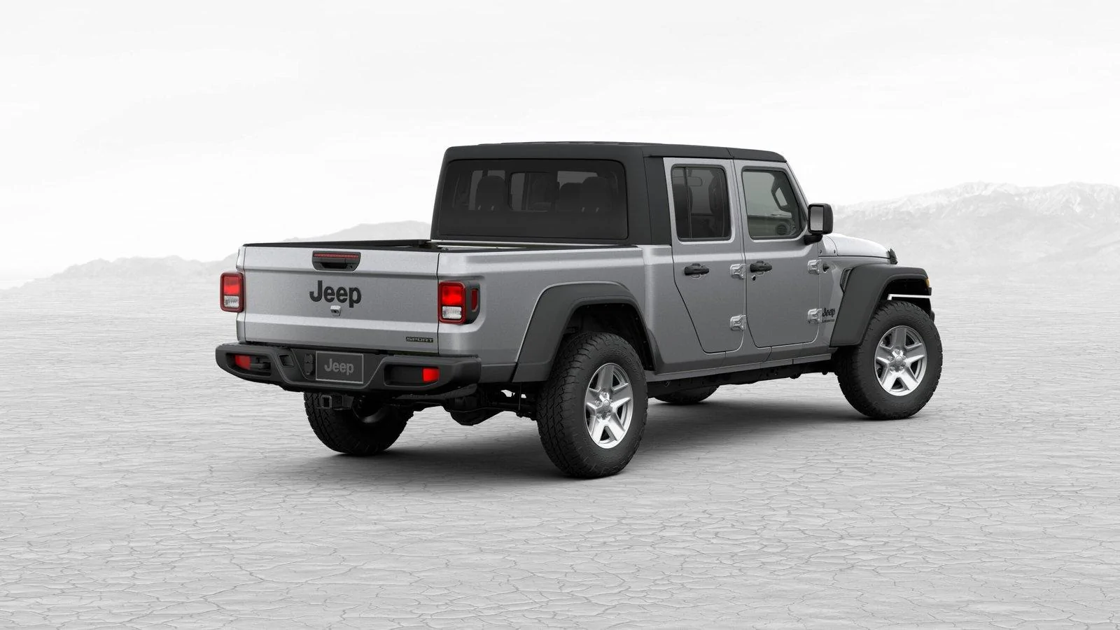

    Hey everyone, exciting news for those of us waiting for the Max Tow group to be available in the Build & Price tool for the Sport and Sport S packages. It is finally up and live on Jeep's website and here are the details from the package. Definitely seems like a great package all around even for those not looking to tow the maximum capacity. You can also add the Trac-Lok Anti-Spin rear differential to the group (sales code: DSA).
    Gear Ratios
    • 4.10 Rear Axle Ratio (Sales code: DMF)(Requires Max Tow Package)
    Max Tow Package (Sales code: AJQ)
    • 240-Amp Alternator
      • A numerically lower axle ratio results in lower engine rpm and better efficiency. A numerically higher ratio improves acceleration when climbing grades, carrying loads or pulling a trailer.
    • Anti-Lock 4-Wheel Disc HD Brakes
      • Heavy-duty four-wheel disc antilock brakes are equipped with electronic sensors that help prevent wheel lockup, offering improved steering control under extreme braking or slippery conditions.
    • Class IV Receiver Hitch
      • A frame-mounted Class IV hitch lets you connect a trailer for serious towing.
    • Heavy Duty Dana 44 Wide Front Axle
    • Heavy Duty Dana 44 Wide Rear Axle
    • Daytime Running Lamp System
    • GVW Rating - 6250#
    • Heavy Duty Engine Cooling
    • Molded-In-Color Fender Flares (2-Pc)
    • Trailer Hitch Zoom
      • The ParkView┬« Rear Back Up Camera[1] provides a wide angle view of the area immediately behind the vehicle when it is shifted into reverse. The display includes dynamic gridlines to aid the driver when maneuvering into parking spaces or narrow areas. It also aids in lining up a trailer to the vehicle's trailer hitch, when so equipped, by allowing the driver to toggle back and forth between the normal view and a 4x zoom mode. The zoom feature is available with the Trailer Tow Package.
        1. Always check entire surroundings visually before backing up.
    Included are two images of a configured Sport S Max Tow package Gladiator. Note the two piece fender flares and LED marker lamps.

    What is up with the piece between the bumper and the fender? I thought that was only on the European models? Does that come with the Max tow? Or the sport group? I have only really been looking at the Rubicon.

    Homerun that piece is on the Sport and Sport S models and carries over from the JL Wrangler lineup.

    What are the
    • Molded-In-Color Fender Flares (2-Pc) ?
    Does this mean the flares are not removable. In-Color??? This is not body colored?

    Marcram, the molded-in-color two piece fender flares are black textured style fender flares with a wider LED DRL light and a two piece design unlike the standard Sport/Sport S flares. They are not colored units like the Overland or Rubicon have/can be be optioned with. They are also likely wider like Rubicon flares to accommodate the wide track axle width change, but we have not received confirmation on that part yet. They are removable just like all of the other flares are but have a two piece design as mentioned earlier.
