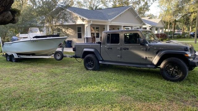

I bought my Gladiator knowing I was going to use it to tow a boat. A few months after getting my JT w/max tow, I found a great Key West 20’ center console. The trailer is factory matched to the boat and, according to the trailer title, the trailer weighs 850lbs with a max GVWR of 5250 lbs.
I wanted to write this post to let someone know - do not buy a JT for serious towing. I average 9.5 mpg on the highway at 68mph and the additional weight on the back of the Jeep makes the front end even lighter and the steering wander even worse. This is with only a max of 5k lbs behind the truck - I doubt it’s more than 4K realistically. Acceleration is poor and always noisy, since the engine has to rev so high for even the most meager of acceleration. Braking is decent, however, but nothing impressive. The mirrors are so narrow that I cannot see anything behind the boat while going straight, and they are largely useless for backing once the trailer gets to any sort of angle.
In short, towing with the JT is not comfortable and does not instill confidence. In windy conditions, or on uneven road surfaces or on narrow streets where steering precision is crucial, it feels downright dangerous. Coming from a full-size truck and having towed many trailers with it, I will be glad to return to a full-size truck again in a few years.

I'm sorry you don't like your truck. Many of us here have towed heavy loads with great success.
I towed over 6,000 lbs with mine last summer. Uhaul auto transport trailer plus car. Lots of tongue weight. Gladiator did a GREAT job and even maintained 55 MPH on a 6% grade. Braking was phenomenal and straight. Got 12.5 MPGs on a 160 mile trip which is amazing considering the load. Just a fantastic tow vehicle.
I also have a 7x14 enclosed trailer that is at the very maximum for frontal area (wind drag) per the owners manual. It tows just as well as my F-150 with the V8.
180
29,526
35,135
It may be the angle, I could be wrong, it's hard to tell from the pic, but it seems like a lot more than 10% tongue weight there........ the back of that max tow rig seems sort of low.
My Overland sagged that much or less with 450-500 pounds on the back. And I have a lot softer springs.
Don't know what to say other than others have had fine experiences. With more weight.

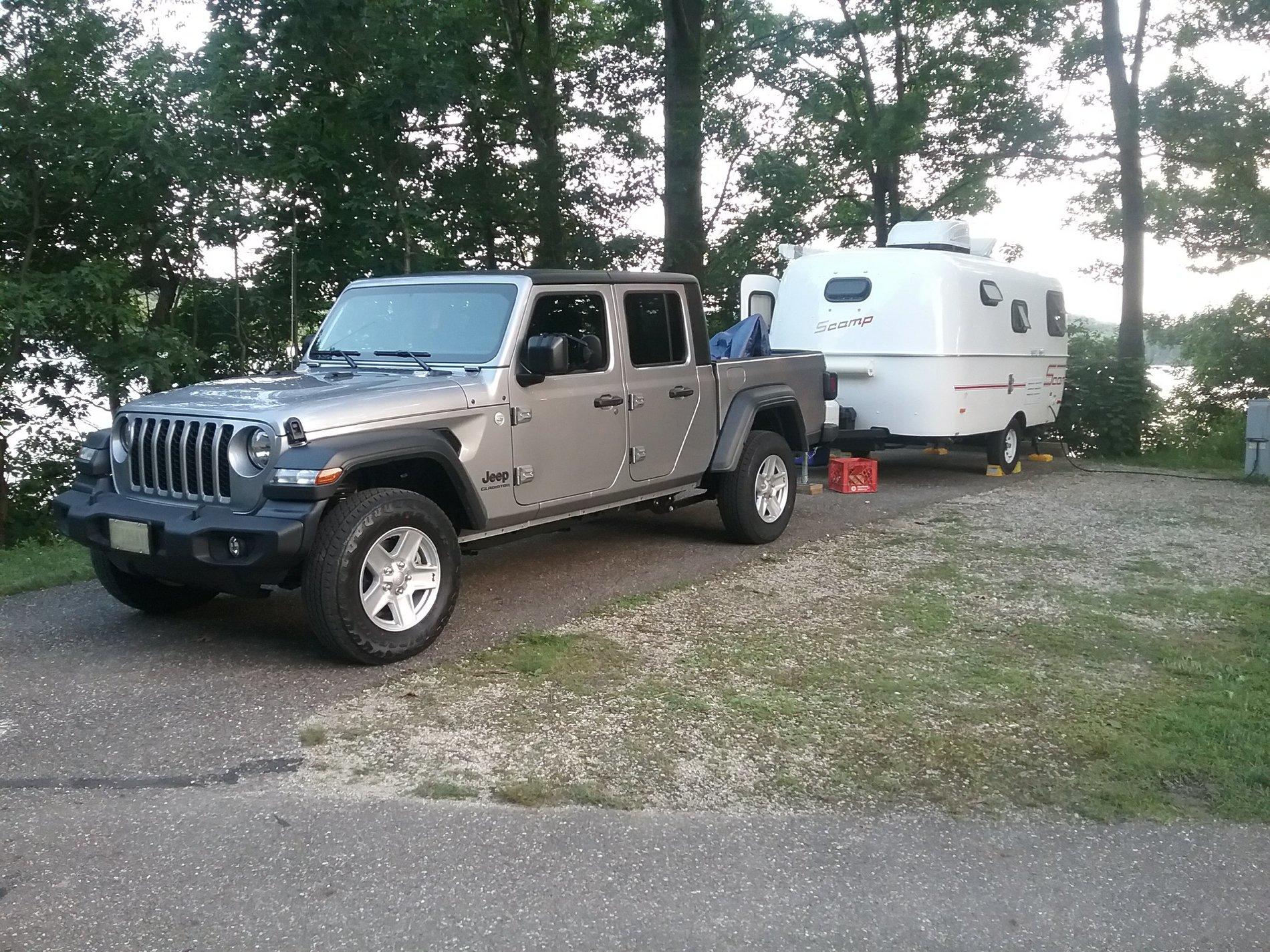

I pull a camper that weighs 2000# empty. I noticed a difference in power and gas mileage when I went to 285/70/17 KO2s from the stock tires. It dose not go into 8th gear as much. I see the OP added different tires and wheels as well. Here is a picture of the truck with stock tires. The trailer has some wind drag and as you can see I use a strap on tow mirror on the drivers side only, don't need it on the passenger side.
This picture was taken last summer when I first got the JT.

I would like to know the tongue weight on the set up pictured, I pulled a 20 foot boat with mine and had no issues after I increased the tongue weight to the 10% needed

Honestly, from that one picture it doesn't look like he's anywhere remotely close to maxing out the tongue weight. You can barely detect any sag at all.
If you want to see tongue weight, go rent a UHaul auto transport trailer and put a car on it. That'll make your safety chains drag the ground. Lol. But even still, this truck will hold 55 MPH no sweat.

How did you conclude the truck pictured has Max Tow?
Mr._Bill beat me to it, but -
It's not a Rubicon, the title of the post is
Max Tow Performance - 20ft Boat
Among other clues in the photo.......
Really? The gap between rear tire and fender is less - these have fair rake when not loaded. Also the line of the running board is a gradual slope down as it goes back. Should be at least an inch higher at the back. Not that it's maxed, but I'd expect a max tow to handle 4-500 pounds and sit level. To me, judging by the lines in the pick and the tire clearance, it looks to have dropped a fair bit.
I have my own trailer so I can set the load over the axles and control tongue weight - would never rent a u-haul trailer. They are also heavier than my trailer by a fair amount. I'm at least 6-700 pounds lighter than a u-haul.

The rear and fron fender flairs on the Max Tow package have an extra flair ext. bit that extends the fender flair acout 1/2 inch. Look at rye photo of the JT with the Scamp, and you can see the flair difference. Stock Spirt S has one small ext bit sticking out, not two as shown in the Maxtow. The Scamp has a 120 lbs dry tounge weight, so yiu are not going to feel that trailer except in a head wind.
My TaB 400 has around 400 lbs tounge weight, with water tank 1/2 and holding tanks empty, and my Sport S with standard two package, the rear drops 1.25 inches, butting the rear running board 1/4 inch lower than level. Anyone with a MaxTow that can report what 400-450 lbs tounge weight drop is?
