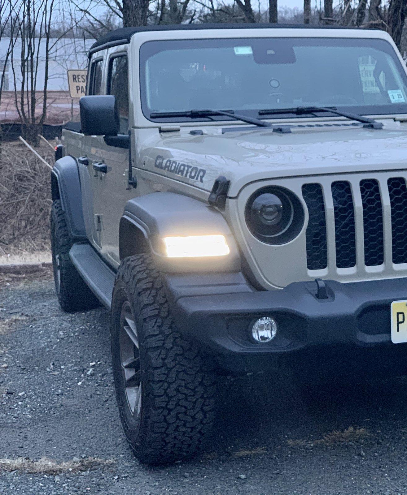

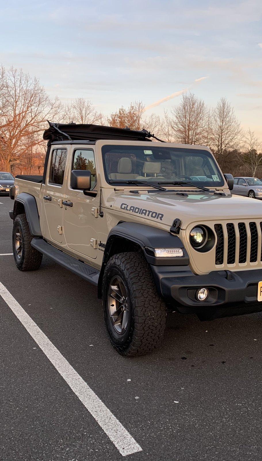

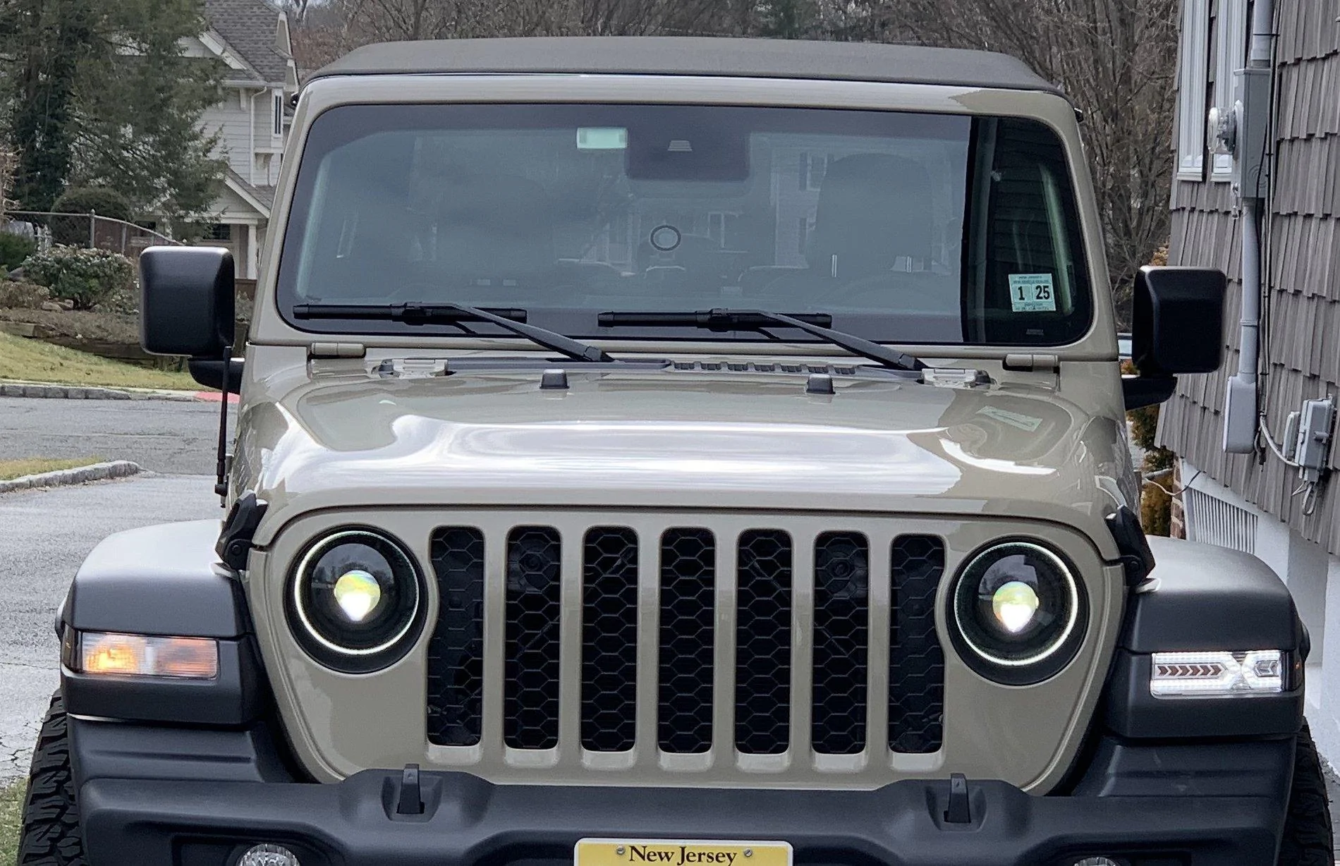

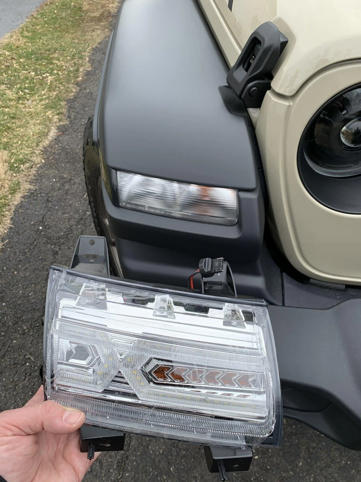

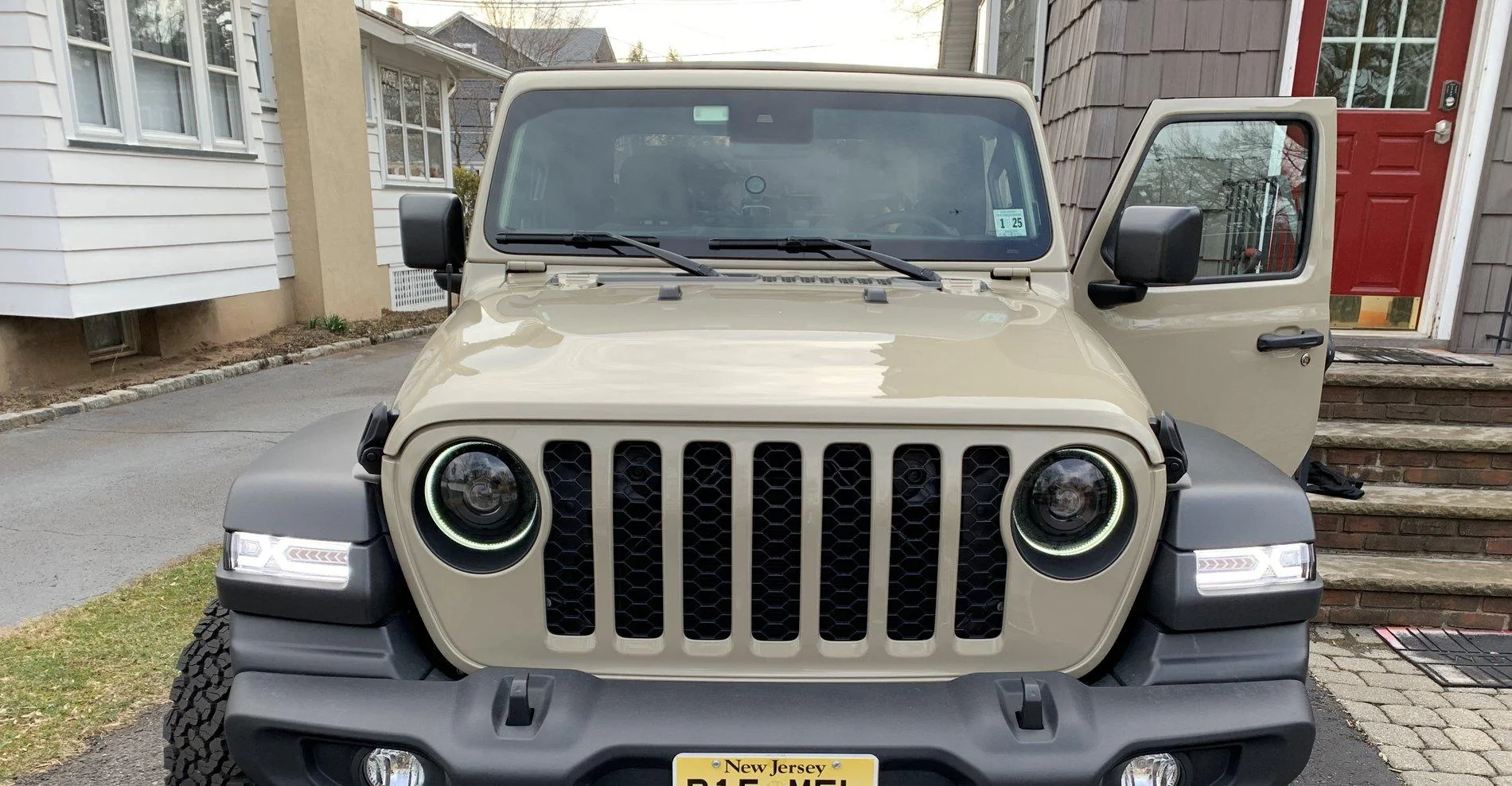

I just upgraded my Sport S Max Tow Turn Signals and DRL with an item from Winjet that said it was only compatible with the Rubicon and Overland/Sahara... So far so good! Very pleased with the look! Came with built in hyper flash eliminators that don’t seem to get very hot which is a plus! I could not find many options out there, but these did the trick! Matches my Oracle Oculus headlights pretty well!

Love the look of these! how is the blinker on these, is it pretty bright? any chance you could post a video of the blinker?

I think if I did it again I would go this route. I spent way more to get the factory led DRLs in, after buying the programmer to get it to work.

I just ordered these off Amazon, and should get here on Monday. How did you go about installing these? Did you remove the fenders themselves? Or just the fender liner around the assembly?

It can be done either way, I have done both and it’s about the same either way.

Forgive me, but I’m not super mechanically inclined so I’m a bit out of my depths on this. The resistors come with what I can only describe as metal zip ties. Where did you mount your transistors?

You should really try to zip-tie them to a metal surface as they get very hot in operation and the metal will act as a heat sink.
Gregj
ETA which is why I don't like to use them as they can melt plastic.
