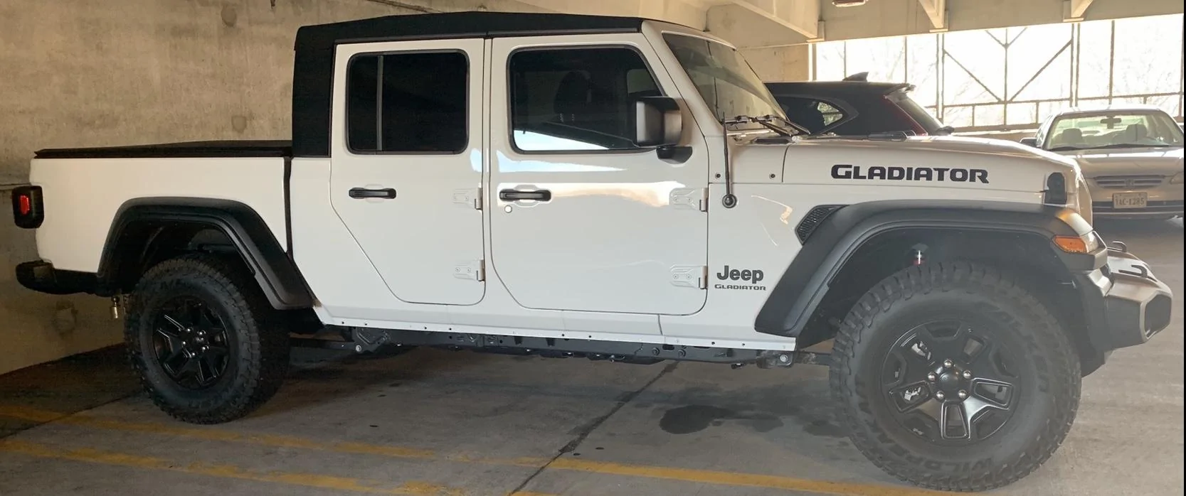

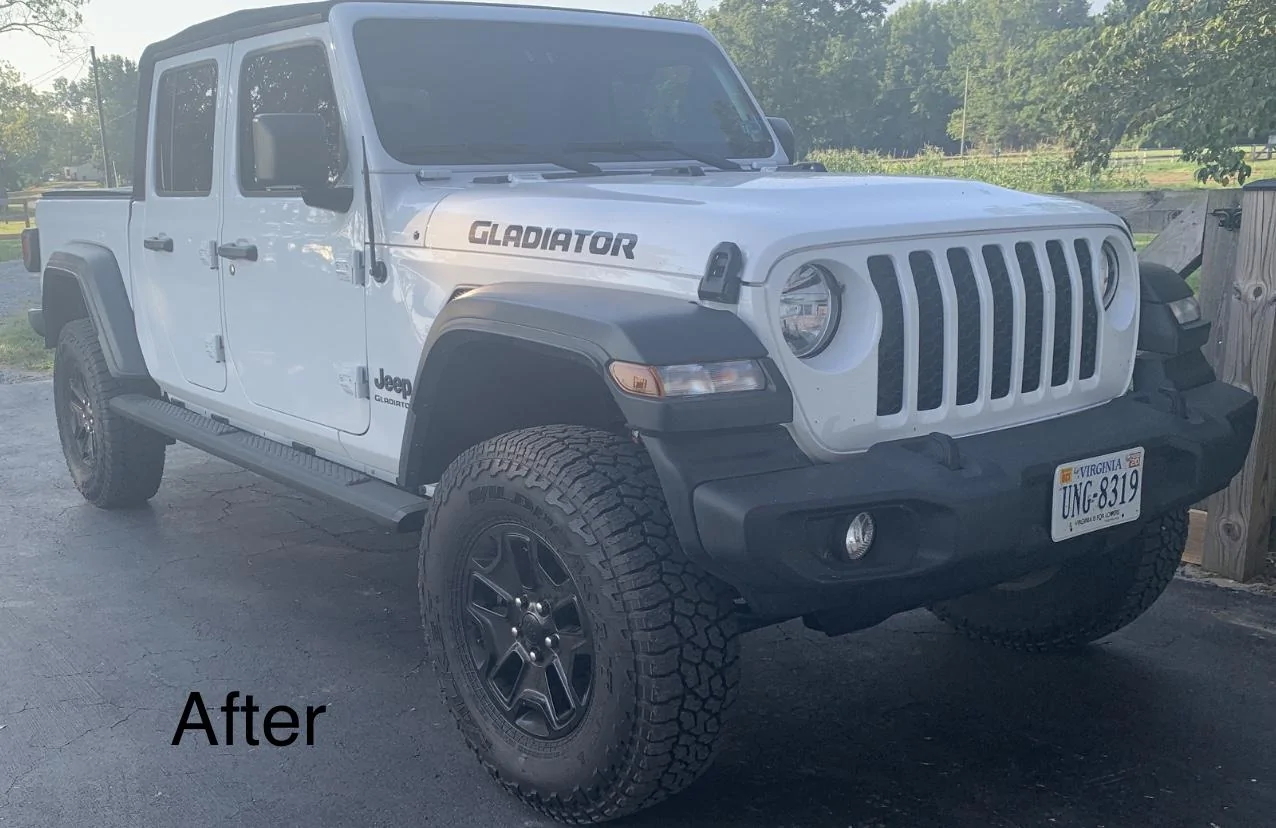

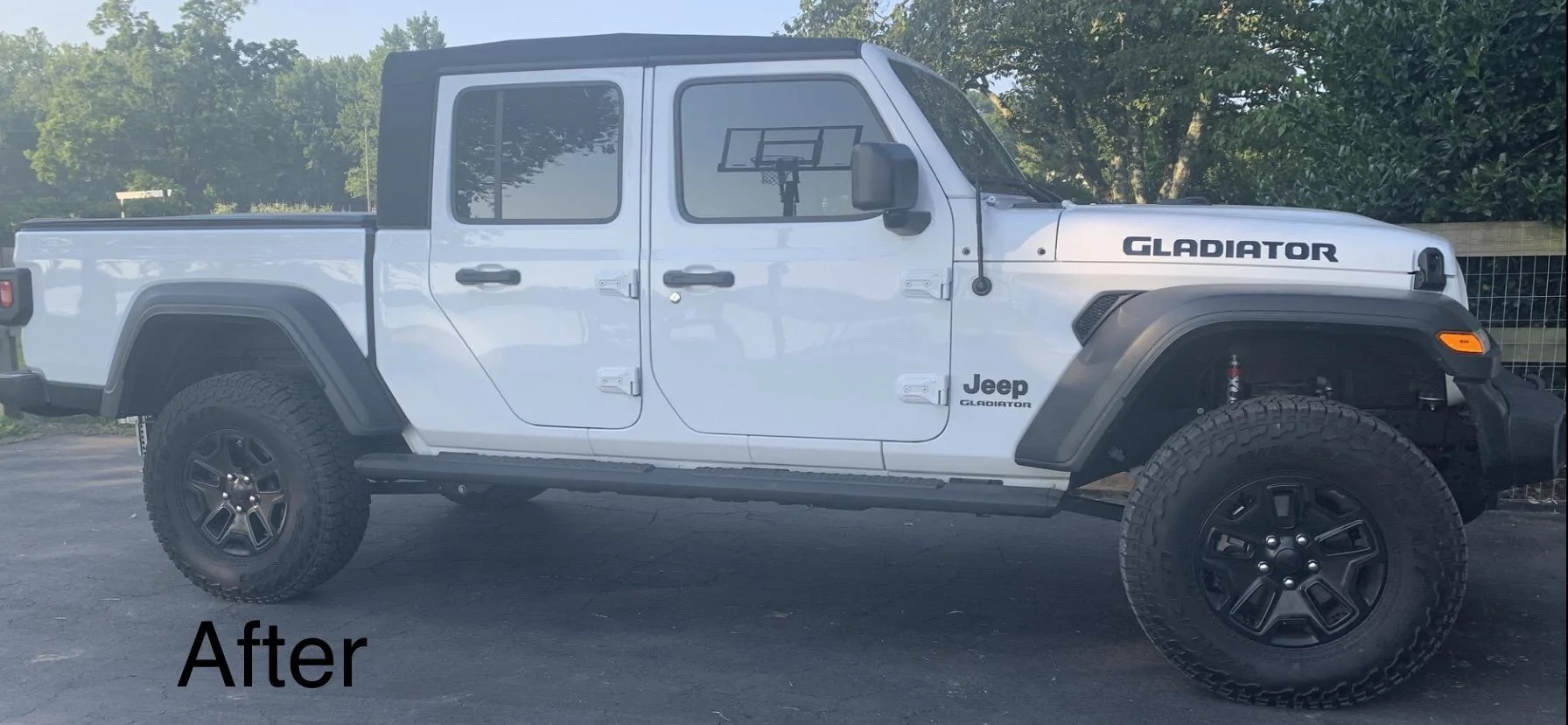

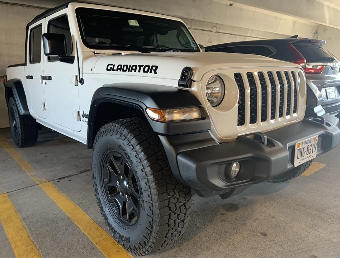

Just installed the iron rock 2” spacer lift on my max tow. When I installed the new spacers I decided to go ahead and throw on the front rubi take off springs.
The front springs took out much of the rake, so that front end is close to 3” higher total. About 2.8 inches.
Took me about 3 hours to do it all my self with jacks and jack stands. The quality of the iron rock stuff is definitely good quality. Overall pleased with the results!

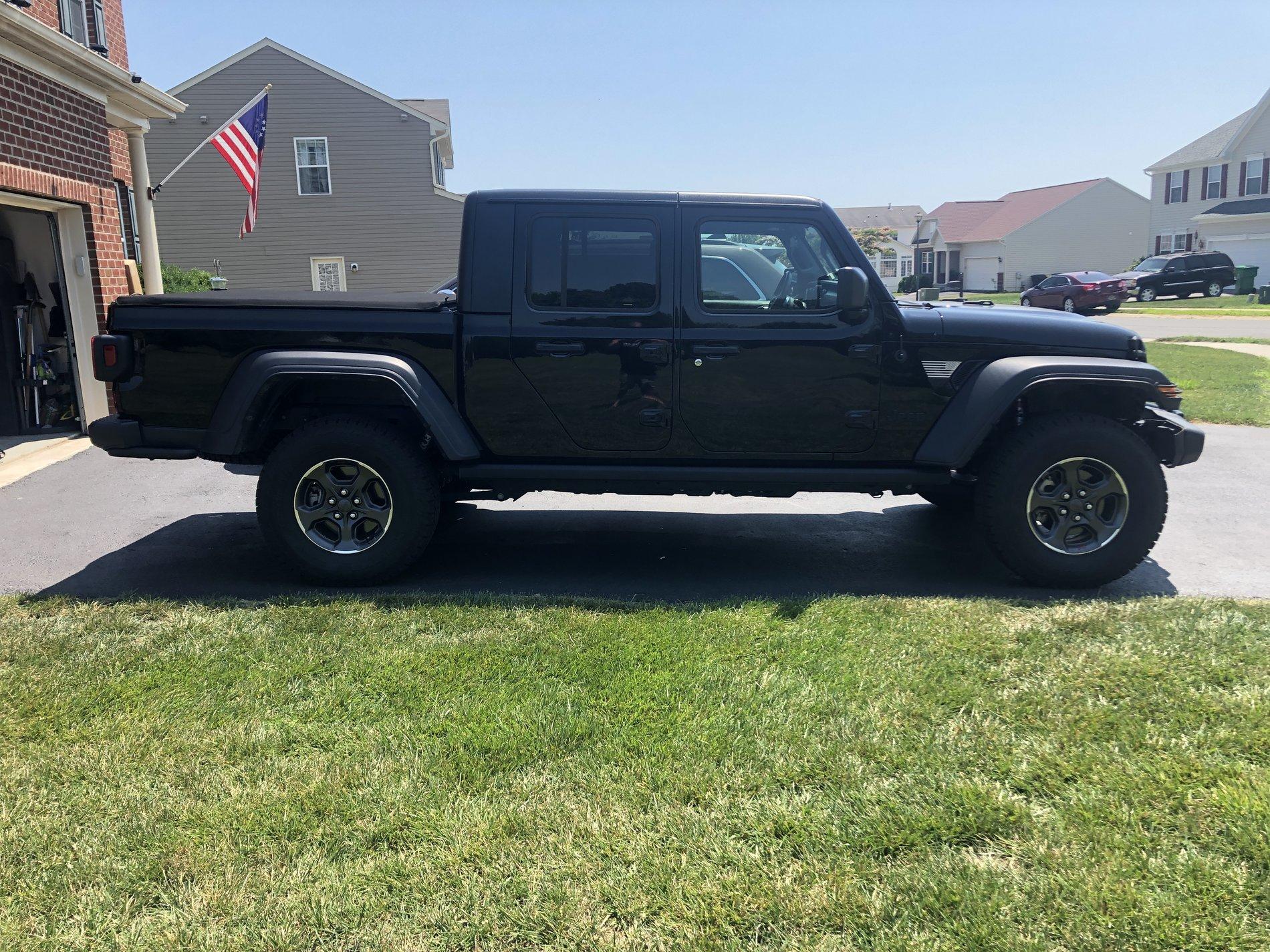

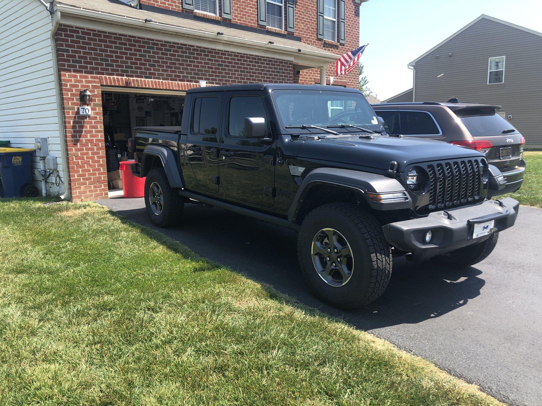

Very nice! I’ve also been absolutely pleased with my iron rock lift. All I did was ad an additional 1/4in spacer above the front steel one to bring the font end a little higher but leave some rake since I’ll be towing. Over all very happy with it.

i kept all my oem max tow springs and am absolutely pleased. The op opted to swap in rubi fronts which is fine, just not my cup of tea.

2in iron rock spacer
1/4in additional front spacer
285/75/17 tires in rubi take off rims
