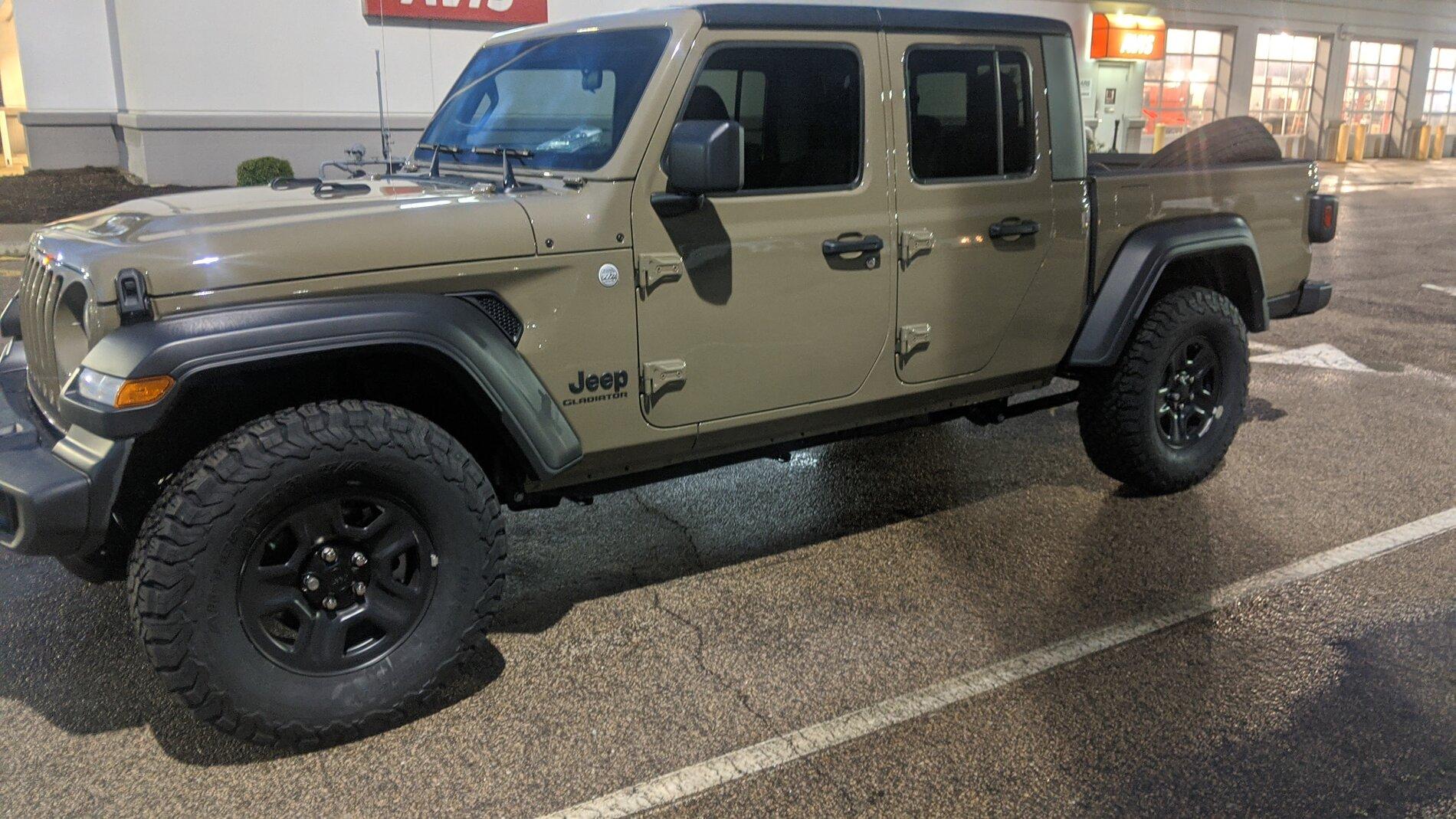

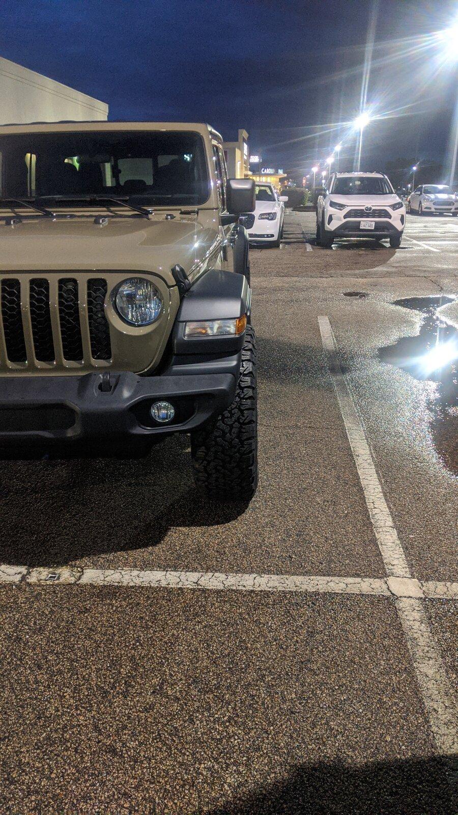

You can fit 35's on a Max Tow with no lift at all and be fine. I had 315 70 17 BFG KO2S mine before I lifted it and there was plenty of room and no rubbing. Pictures for references, stock wheels and sitting stock
Jeep Gladiator Max towing and lifts IMG_20200213_183121
Jeep Gladiator Max towing and lifts IMG_20200213_182855
Jeep Gladiator Max towing and lifts IMG_20200213_183153

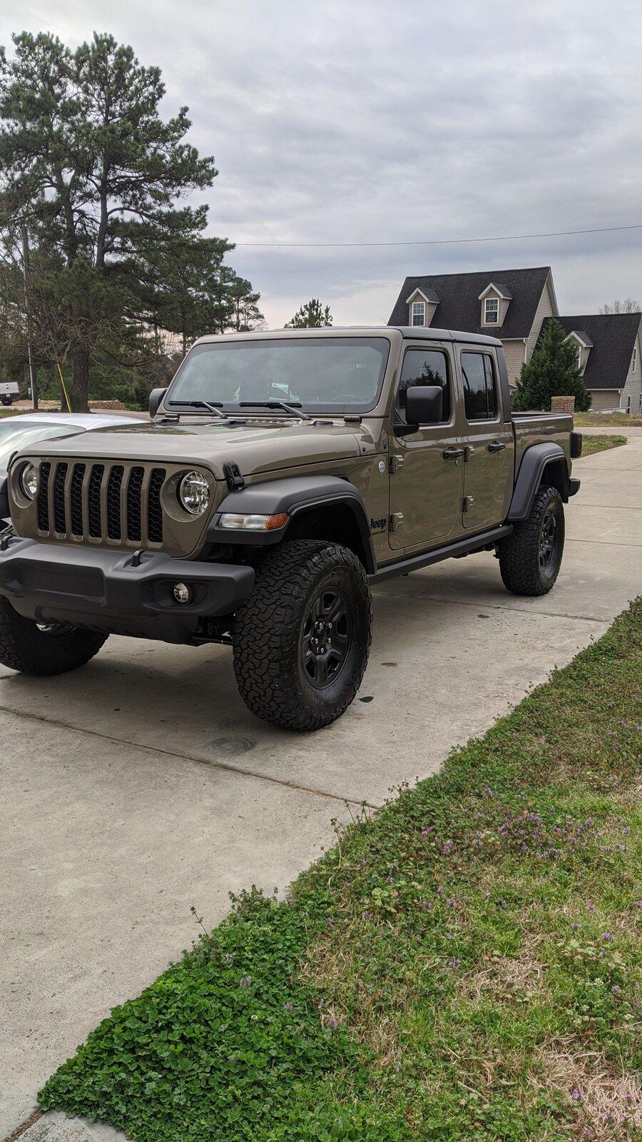

Later on I added a Rubicon Suspension, just the front springs and the Fox Shocks and kept the 2.5" Readylift installed and the rear max tow springs, stock wheels and I added 1.5" wheel spacers to push the wheels out a little more. It looked like this after that
Jeep Gladiator Max towing and lifts IMG_20200801_160223

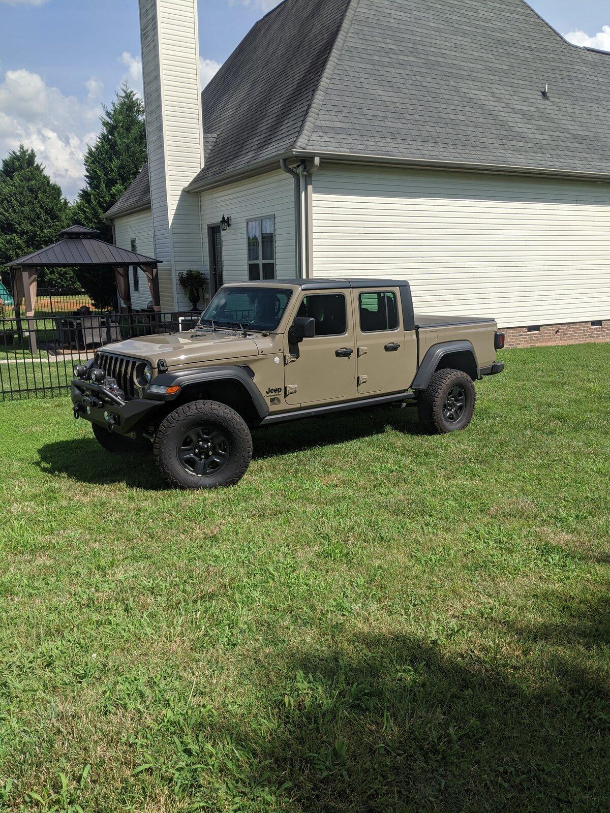

I'm now running the same above setup but with 37 12.5 17 Goodyear Kevlar's installed. I towed about 4,000lbs with that a few weeks back, boat trailer combo and had no issues. I pulled it like a boss about 30 minutes up the road. Looks like this now. Only other thing I have added since adding the 37's are drop down brackets for the control arms. Still have the stock track bar installed.
Jeep Gladiator Max towing and lifts PXL_20210328_233737820.PORTRAIT~2

Absolutely love this look! How is the ride with the SST? I know the Silverado world I just came from everyone warns you to stay away readylift.. but that looks really good

With the Readylift spacers installed it rides as good as it did stock. I'll change out the stock track bar when I get new 37's in about 4 or 5 months. The Goodyear Kevlar mtr 37's made the ride a little rougher than before but going from a A/T KO2 to a MTR that was expected. The spacers have been on the JT for about a year and a half and it still rides great.
I still got stock 4.10 gears and still see over 17mpgs, we got 18.3 on our trip to Boone NC the weeks ago and 18.5 in May on our trip to wrightsville Beach. I want consider a regear unless I decide to go bigger on tires but honestly I love the look of the 37's. It gives me plenty of clearance and the JT still offers enough power for me.
