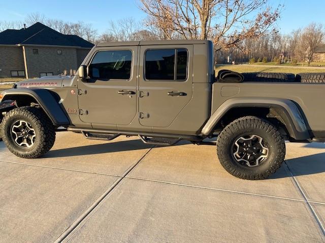

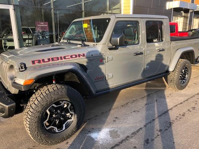

Aahnold's a 2020 Sting Grey Rubicon and this is his first b-day picture (Nov 11)

Aahnold wanted a few things for his b-day, namely tinted windows, Teraflex 1.5" leveling kit, N-fab podium steps, a Fox stabilizer and a stubby antenna. Now he wants new tires and wheels. Aahnold is becoming very needy.

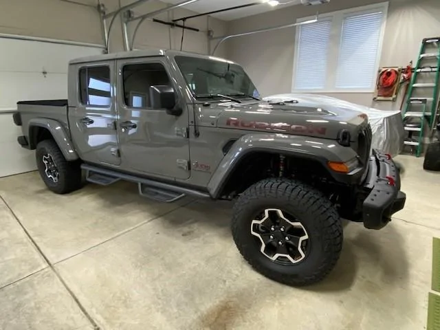

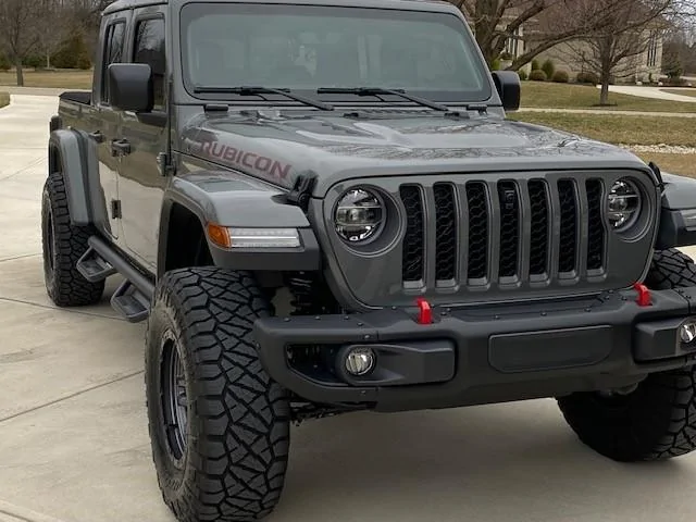

....and lastly, new tires. Wheels are ordered but I couldn't wait. 315-70-17 Nitto Ridge Grapplers on stock Rubi rims running 40 PSI. No rubbing even at full lock-lock. Ride's more smoothly than I imagined too. I'll post better pics of them tomorrow.

Nicely done.
have you noticed any change in youre highway driving gears with the 315’s?

Thanks Gren71. I haven't noticed any real difference in shift patterns overall and I drive 32 highway miles each day. Not sure I'll re-calibrate the speedo either since it's only off by about 1 MPH after the change.

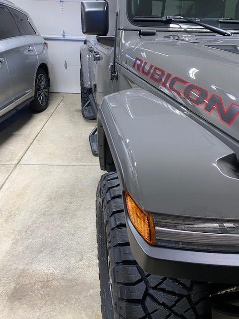

one last question..do they stick out of the wheel wells like true 35’s do? Couldnt tell in your pics

No, they don't stick out at all (I actually want them to slightly). I'll post some better pics from different angles.

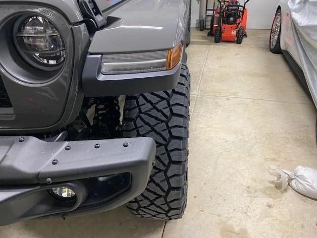

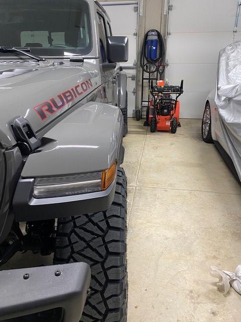

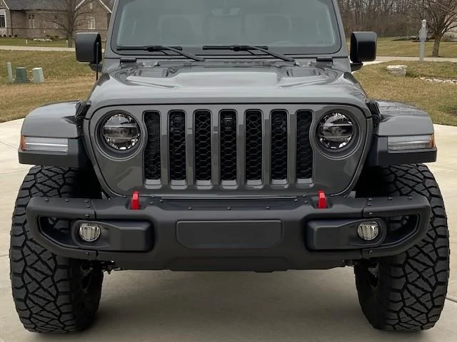

Here are a couple more pics showing the how far the tires stick-out. As far as ride vs the Falkens, I actually find the Nittos to be smoother. They seem to soak up bumps better and I swear, the steering is better (tighter) than with the Falkens. These are AT vs MT tires and I've not noticed any increase in noise at all. Overall, I'm very pleased with them so far.

Looks real good ! I also like the way the tires bulge out, saving the stock rims, and allowing you to really air down. I really like the setup with those rims. I am thinking of doing the same thing with the stock Rubicon rims like you have now. I noticed you said you are buying new wider rims, Any reason you can see, or feel, why you would not stick with these stock rims ? Thanks for any info.

That looks outstanding! When ever i need new tires ill be upping to 315’s

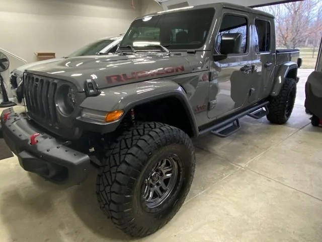

Finally got the new wheels. Fuel Ammo's, 17 x 9, +1mm off-set. Sit outside the fender 2 inches more than when same tires were mounted on stock rubi rims. Love the stance now! Drives and handles no differently than before.
