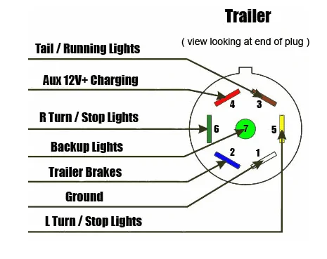

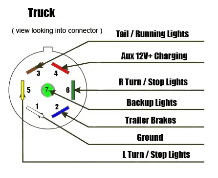

Thanks for the diagrams. Here's what I'm seeing when I take reading on the trailer plug, using the above diagram for a reference.
Any 2 pins, except for Pin 4 (Aux) - 0V
Pin4 (Aux) - Pin1 (Ground) - 13.7V
Pin4 (Aux) - Pin2 (Brakes) - 13.7V
Pin4 (Aux) - Pin 3 (Tail Lights) - 11.8 V
Pin4 (Aux) - Pin5 or Pin6 (Turn Lights) - 8.6V
Pin4 (Aux) - Pin 7 (Backup Lights) - 0V
I also got up under the jeep with better lighting and found that it was the ground wire in the harness that seemed to bear the brunt of the load. It melted its way out of the outer insulation as far back as I could trace it ('till it went above the spare), damaging other wires near it close to the connector.

Whatever you do, don't feed any voltage into any of the truck's connector slots! You don't want to have + voltage introduced into the lighting circuits. These won't appreciate that.
Not sure why you are using the AUX 12v + at all for anything as far as testing.
You should have 12 volts (12.6 tops) on the aux connector because it goes to the trailer's battery + terminal.
That should read 12.6-12.8 fully charged depending on the battery.
13.7 is telling me you have something connected to that trailer.
Make sure camper is not connected to the house or 110v
Make sure the camper is NOT connected to the truck.
before doing any testing.
You should have 12.6-12.8 volts at the aux (between aux at the trailer's plug and the trailer's ground)
Checking AUX to the brakes will try to engage the trailer brakes and of course, it's a ground point due to the low resistance of the coils in the electric brakes. So all you are doing there is saying there's a ground path. But since you likely have a volt meter between the AUX and trailer brake terminal, there's not enough power to engage the brakes, you are simply using the trailer brakes as a ground for the volt meter and measuring voltage at the aux terminal
As far as the lighting - all you are doing is connecting the trailer's battery + to each of those lights in turn.
Assuming a normal "12 volt" battery in that camper, we'll see what others say, but that's high. It's telling me something else is powering it up to that voltage. A camper not connected to the truck and not connected to the house (or garage) 110v should only read normal battery voltage of about 12.6 fully charged.
Does that camper have ONE battery? Just one, and it's 12 volts?

That would take some serious trying as those connectors are recessed in the slots a bit, you'd have to tip and wiggle it, but it would send that trailer 12 volts to the truck ground, melting the truck ground wire. The truck's 12v aux would go to trailer ground but that would blow the truck's aux fuse.
That's the only thing that works, other than a mis-wired camper pigtail.
power and ground positions would be reversed if the connector was 180 off.
The other connections wouldn't be a big deal - lighting, usually without power to them.
