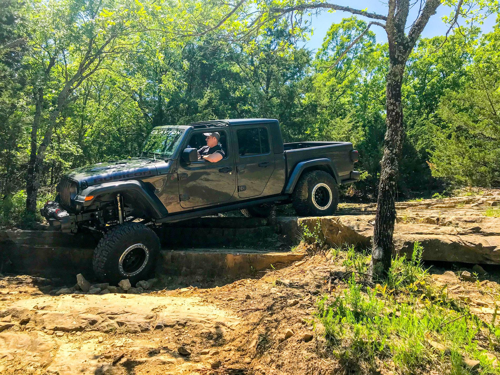

We have two options in terms of joints. The Premium kit comes with Johnny Joints on one side of the control arms which do provide a little bit more flex and misalignment, while our Overland kit uses Giiro joints on both ends of the control arms that still provide a great amount of flex off-road, while also helping to isolate road noise and vibration on road. You really can't go wrong with either kit, as they both perform great both on and off road. Also, when it comes to short arm lift kits, shocks are your biggest limiting factor in terms of flex anyway, so as long as you pair these kits with a nice set of shocks you'll be good to go either way!
I'll include a picture one of our customers recently sent to us using our 3.5" Overland Plus Kit that uses the Giiro bushings, it really shows off the flex these kits are capable of!
