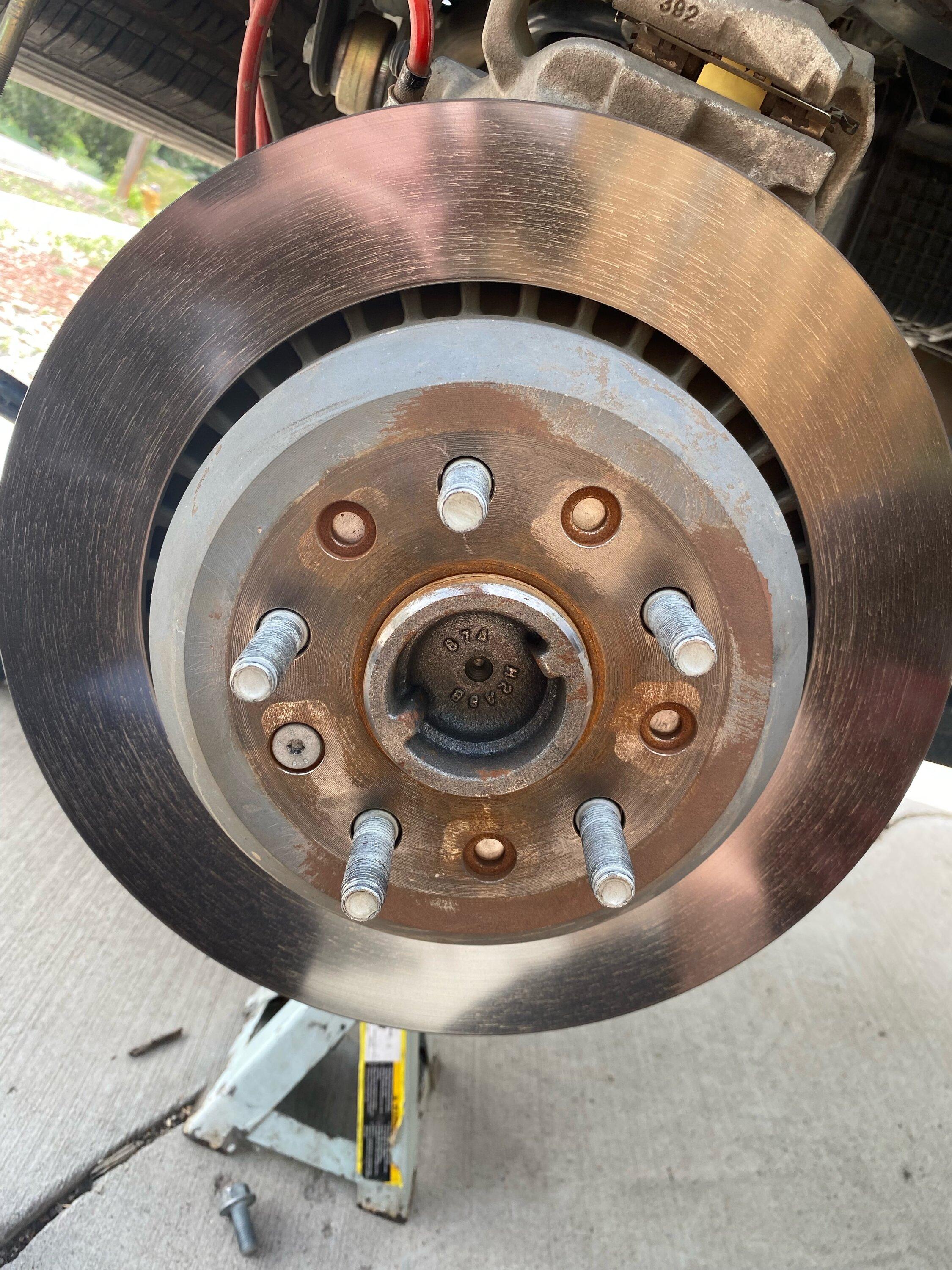

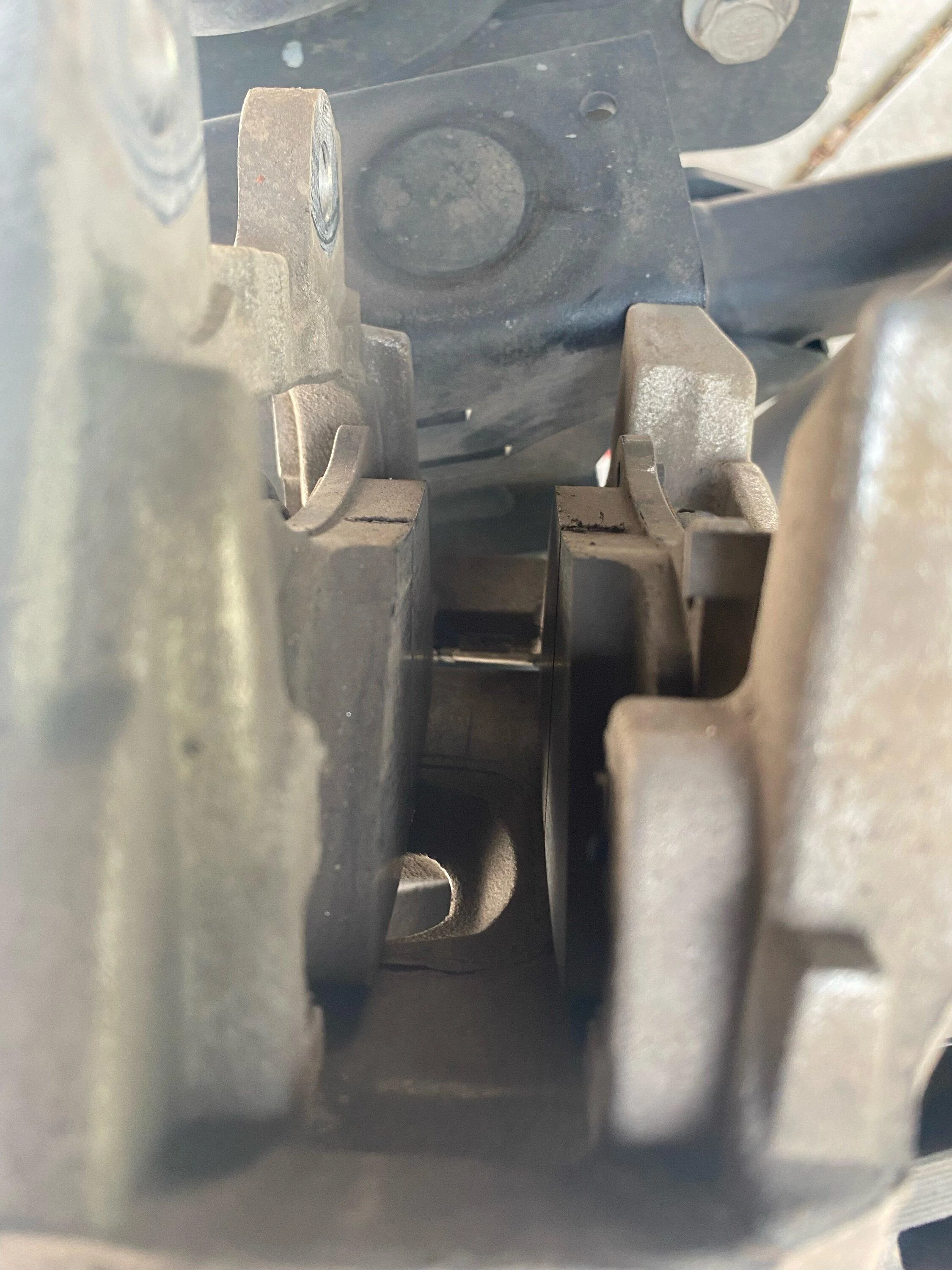

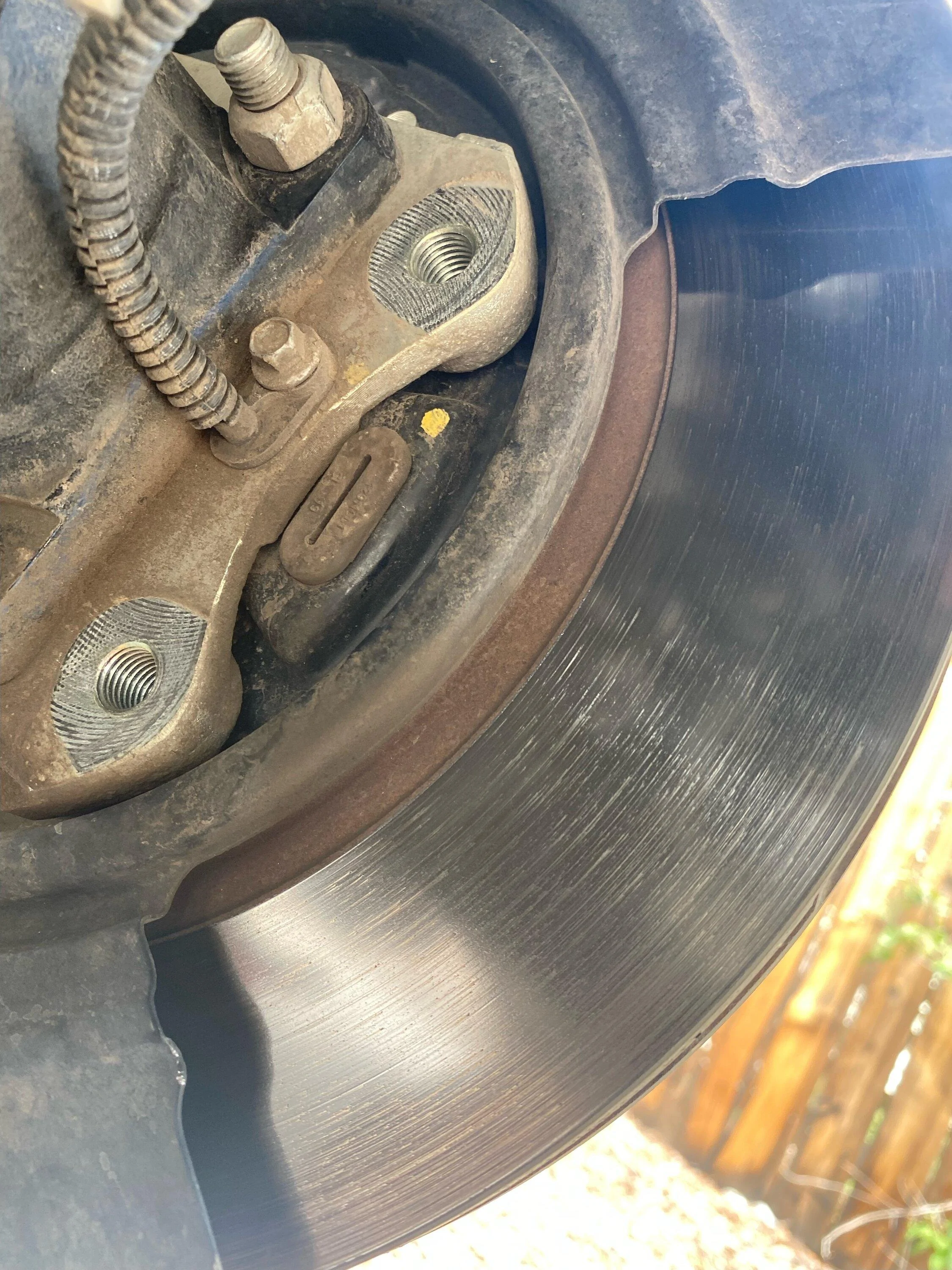

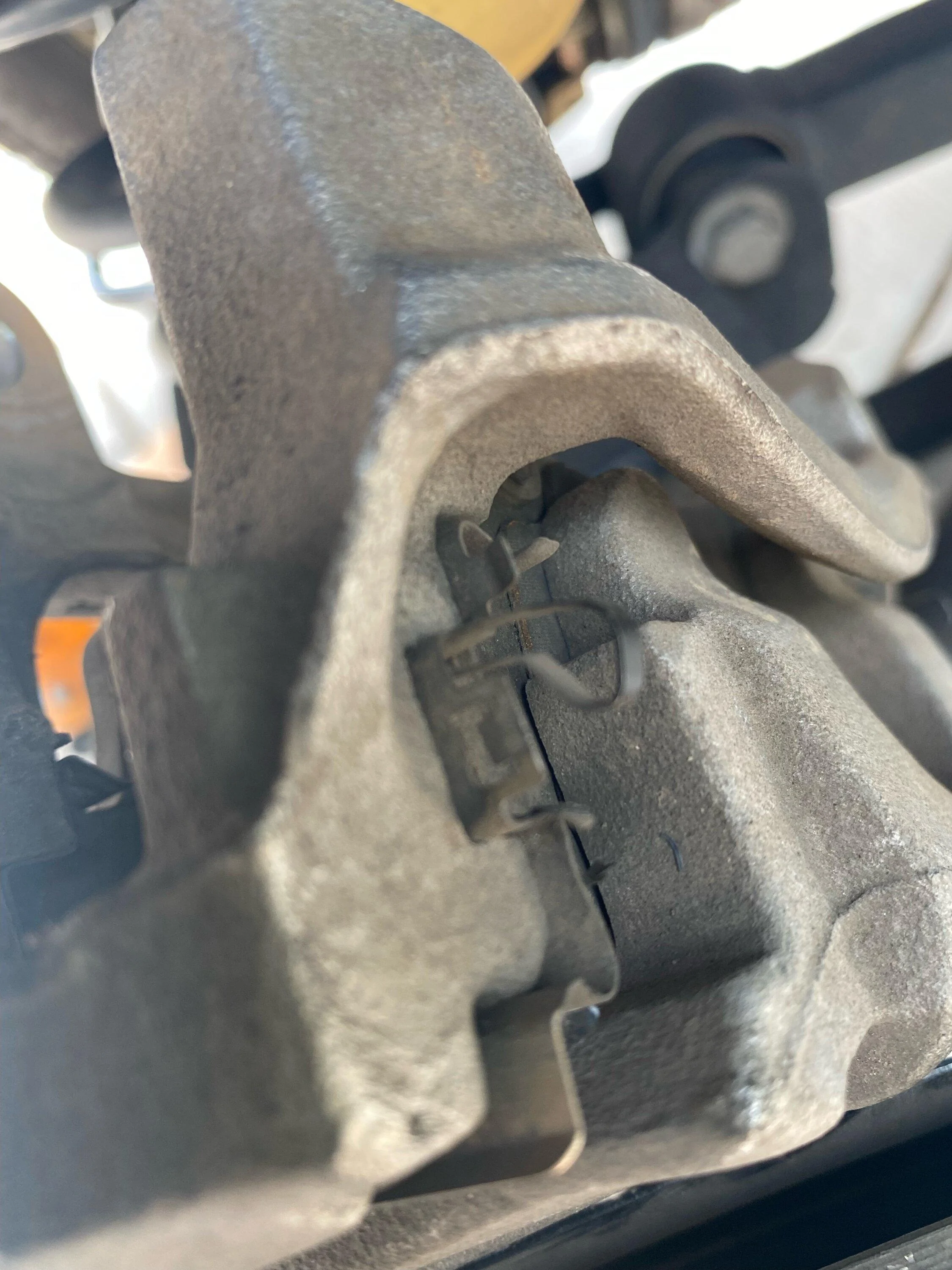

Pulled wheel off. No rocks in between dust shield and rotor. Spun again slight rubbing from brake pad.
No signs of scoring on rotor.

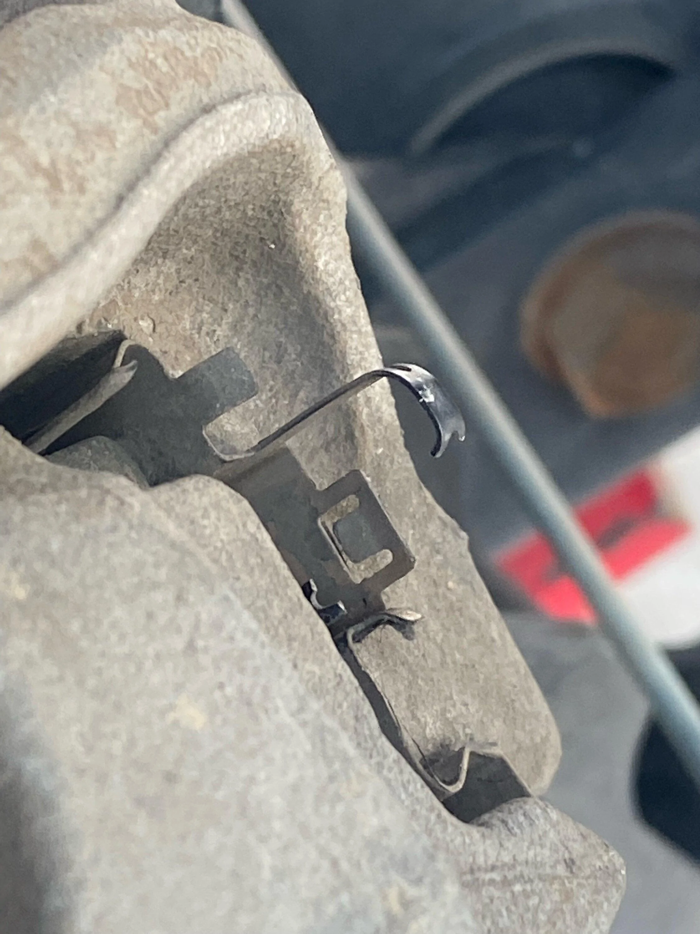

Discovered busted retainer clip.
See pics. pulled a rather large chunk out of the pad thinking that is the culprit.
Going to try to source a new clip tomorrow.
Noise still persistent.
Did I diagnose it or any other ideas? It's loud when driving and quiet when elevated.

Plan for tomorrow is to get that replacement clip and then look into a potentially bad wheel bearing. Not sure where else to head at this point.

I took it to Perkins Jeep as I could not find the clips.
Their tech suggested it was brake retention clips.
However they are on backorder. So his solution was to wait, replace the clips and see if the noise went away.
I was told I could drive on the noise to Tennessee.
Not feeling that I called a few brake shops. Sure enough. They had the parts. Cost me like $60 to get it fixed.
Done.

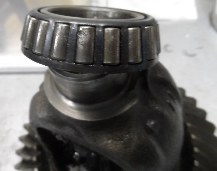

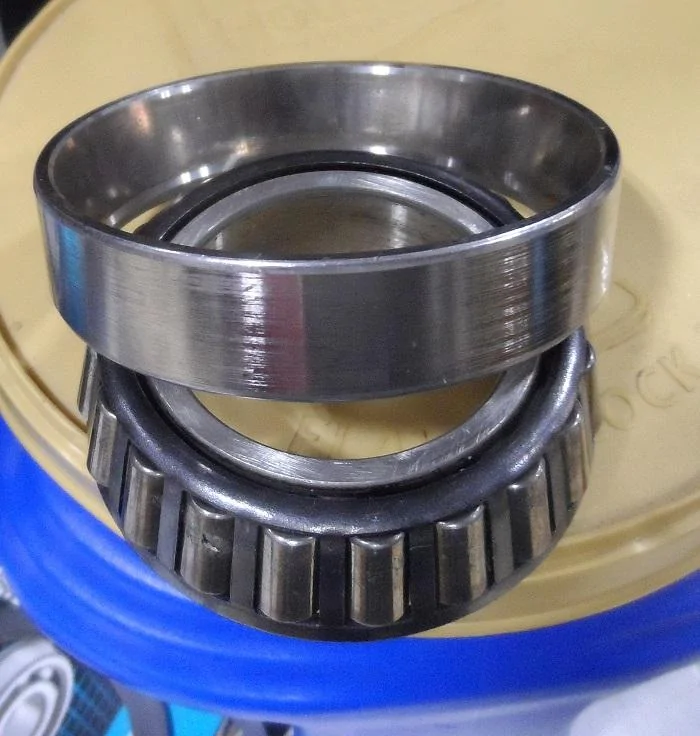

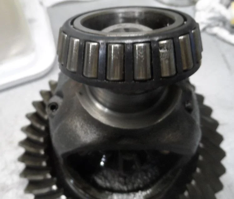

And yet these bearings made no noise at all........ I only found them because I decided to check pinion bearings when replacing a pinion seal. To get the pinion out to replace the bearings, you have to remove the carrier -
Jeep Gladiator Metallic Grinding From Rear End:  Speed Sensitive sx4-carrier-brng_3654 (1)
Jeep Gladiator Metallic Grinding From Rear End:  Speed Sensitive sx4-carrier-brng_3655 (1)
Jeep Gladiator Metallic Grinding From Rear End:  Speed Sensitive sx4-carrier-brng_3678 (1)

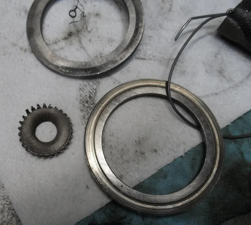

Oh, but wait, there's more!
I found one of the cups had been spinning in the housing and cut grooves in this shim -
Jeep Gladiator Metallic Grinding From Rear End:  Speed Sensitive sx4-diff_3656
And when using my hand to scoop out the rest of the lube still in the differential housing, that small piece fell out with the lube - that's about 1/4" off the end of the right axle. How the XXXX that could even happen we'll never know.
