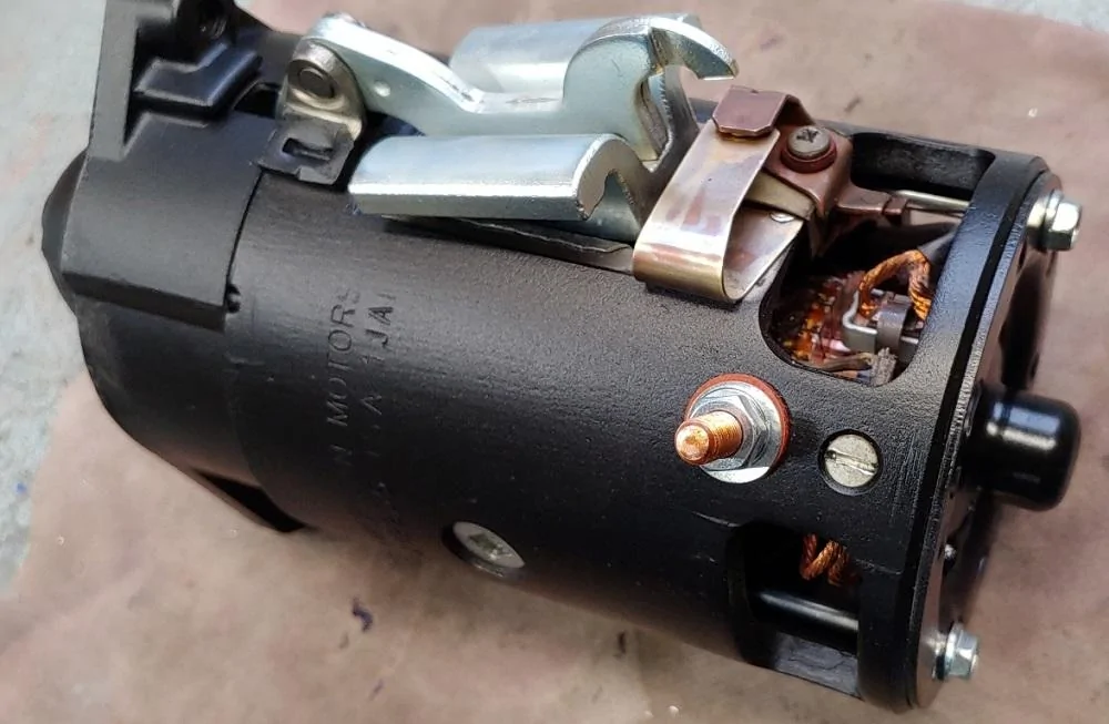

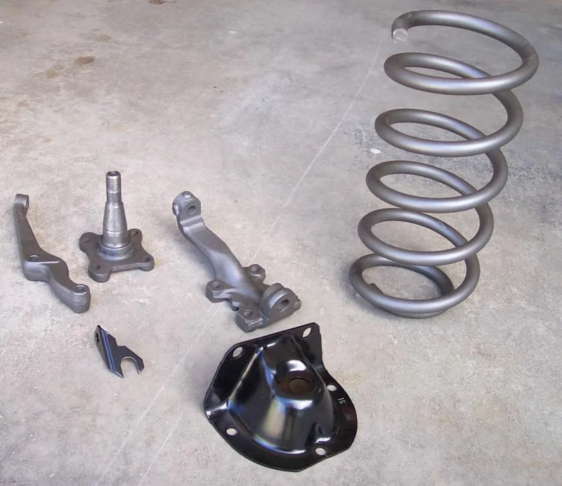

I powder coated the frame and drive end housing of this starter, and the suspension parts below.
I also power coated the aluminum parts of an attachment for my wife's quilting machine in translucent raspberry, you can do almost any color, any sheen, you want.
More flexible than paint, chemical resistant, resists gouging and chipping.....
Otherwise, my guess is that hot processes will be your best bet.
