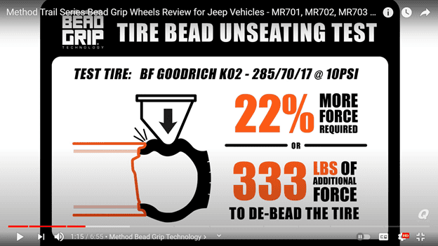

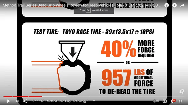

Here is what I found from a Quadratec Video regarding the advantages of Bead Grip and the testing that Method has done.
Jeep Gladiator Method Wheels MR313 or MR703? 1610117296616
Jeep Gladiator Method Wheels MR313 or MR703? 1610117370331
