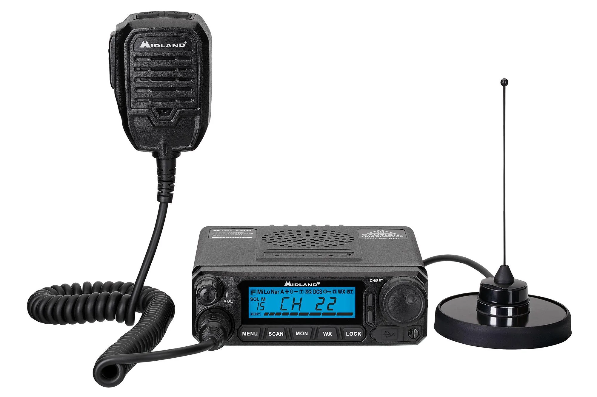

Midland's MXT500 - More Range, Power, and Clarity Than Ever Before
The highest powered radio allowed by law comes packed with superior features like quick USB-C charging, split tone and repeater capabilities, and IP66 waterproof/dustproof. This 50-watt radio brings you unbeatable range sure to take your communication to unprecedented levels.

How long realistically will that thing get you? If both radios are 50 watts?
Are we talking 30 miles?
On GMRS with that antenna? Absolutely not. You might be able to stretch that out if you can get a clear line of sight with their 6dB antenna and proper mounting on a metal roof or something but I'd expect range to be around 8-10 miles in ideal conditions.
I know nothing about this. I was just asking.
My guess was based on the fact that I can get about 1.5 miles at a ski area (not urban) out of a set of decent but not expensive GMRS handhelds.
Sorry if that sounded aggressive but yeah scaling isn't linear so going from 5W to 50W isn't a 10x increase in distance. You get roughly 3dB gain each time you double power so 5W > 10W > 20W > 40W would be approximately a 9dB gain and roughly 10dB getting up to 50W.
All else equal you'll see a fair bit of extra range going from a 5W handheld or a 15W base unit but the reality is a good 5W handheld with a good antenna on a good mount will likely compete if not beat that 50W unit in raw range with that dinky little antenna. Where the little antenna excels is in heavy woods, hilly terrain, and urban environments which I think is the target market of this unit.
IMO the MXT275 is still the unit to beat. You can hide the body away and all the controls are on the mic so it's a super easy unit to use and 15W has never let me down in trail rides. I keep the 6dB antenna handy for when we're out in the desert and use their fat little black antenna when we're in the mountains and the wider signal angle is more usable.
