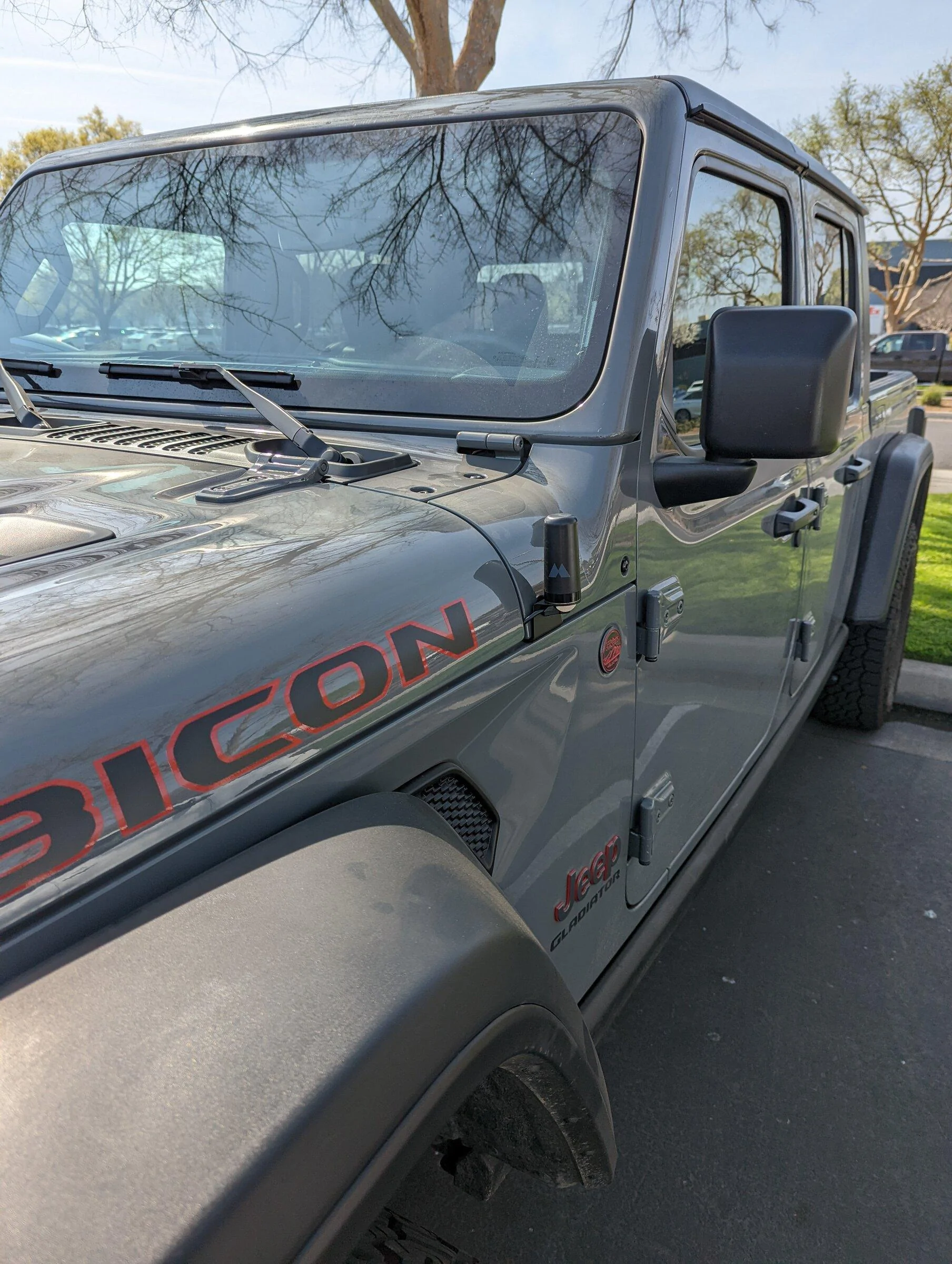

I chose to upgrade to the midland with the ghost antenna, mount, and NMO extension cable.
Ghost antenna was installed on drivers side cowl using cool tech mount.
Antenna extension cable was routed through clutch pedal plug to cowl mount.

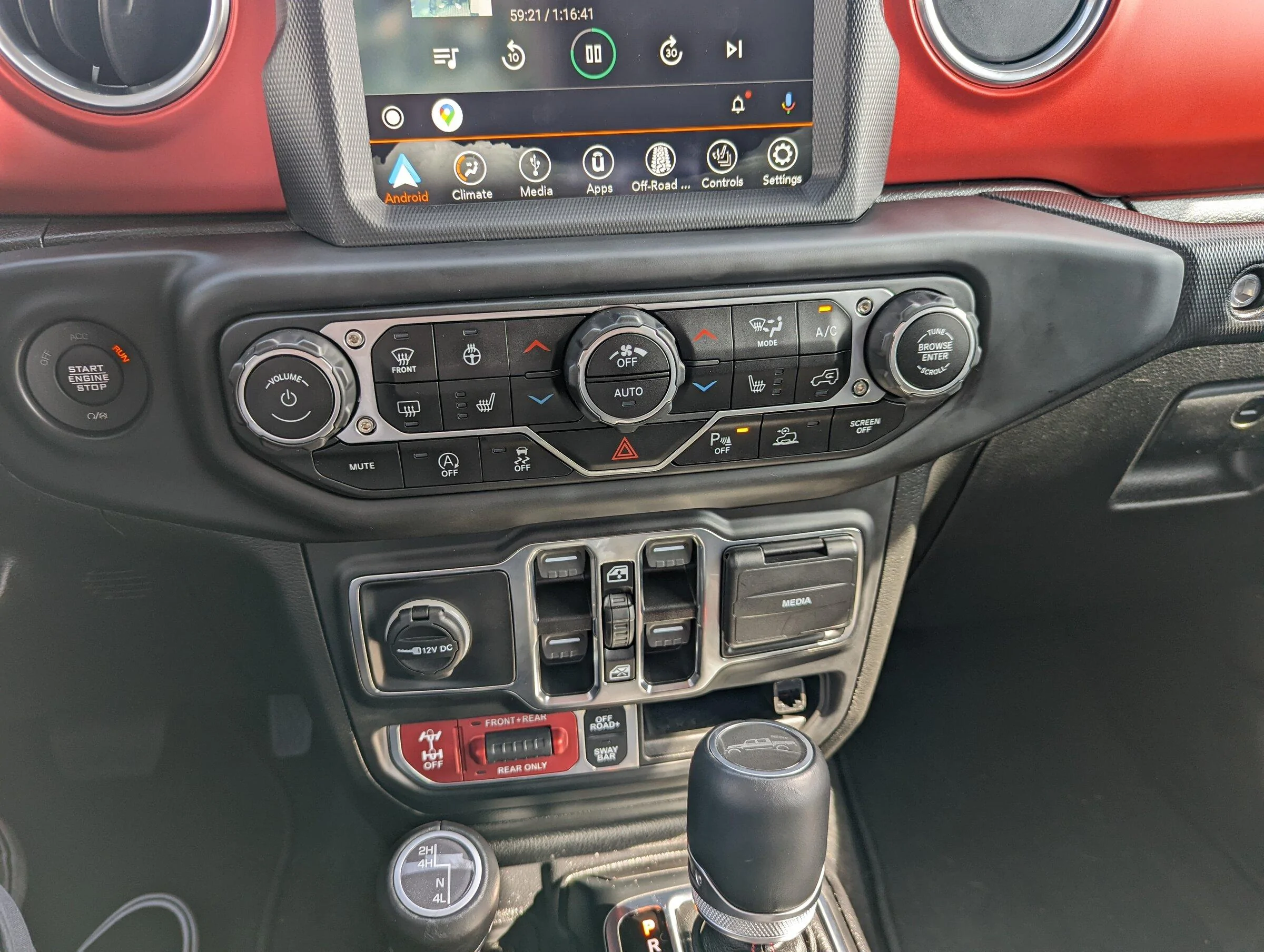

Unfortunately my truck did not come optioned with Aux buttons and a cubby takes it's place.
In that cubby i installed the rj45 extension to just peak out.

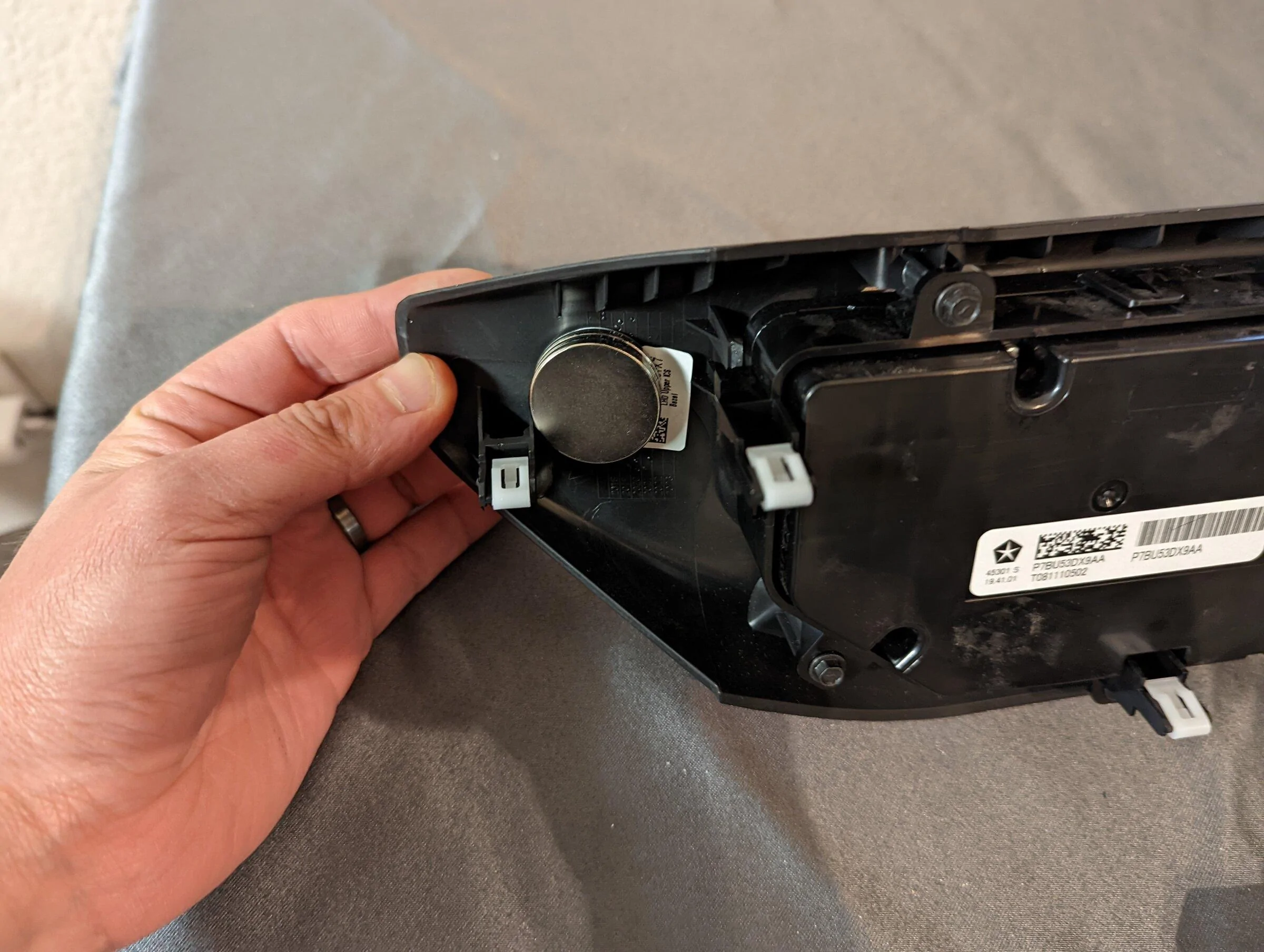

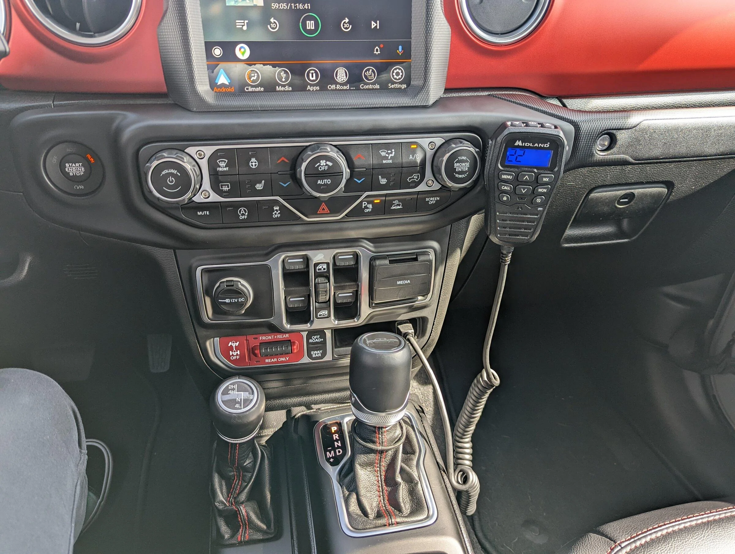

Instead i put together an non-visible magnet mount.

I managed to get it to work using these magnets (1.26 inch D x 1/8 inch H)
The area to the right of the scroll wheel provides the perfect amount of space to mount the magnets.
I stacked 3 magnets onto the trim and one magnet onto the mic/handset for extra hold.
It feels very secured, but i have not tested off road to determine if magnets will hold.

I have not tested to see if/how magnet could affect the functionality of the radio.
Although i have seen that you can buy standard mic magnetic mounts and did not see mention of complaints.

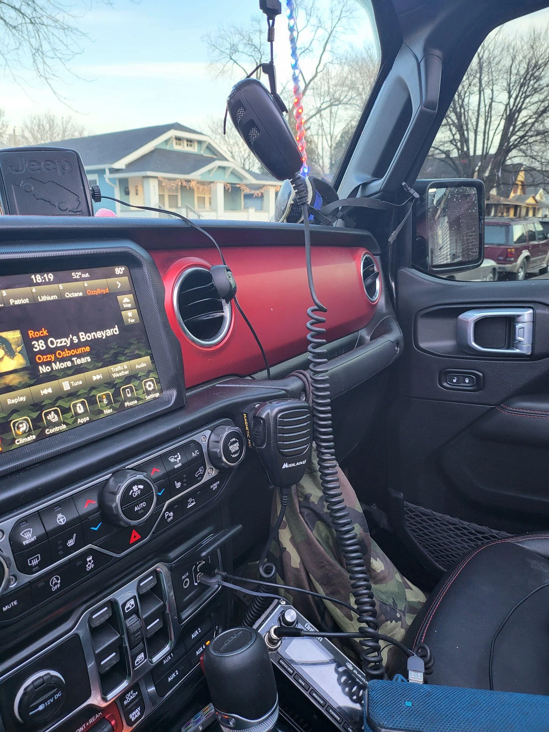

I run an MXT400 on a mag mount there.

No issues so far. Finally got a chance to test the"mount" off road and no issues as well. Never fell off lol.

I'm curious if you did any modification to the back of the mxt275 mic to get magnet to stick aside from removing screw for standard mic clip? the back surface is not totally flat since it has some grooves for the mic holder and the diameter of the circle is smaller than the magnet you showed.
i ask bc i tried to basically use a cell phone mount https://amzn.to/3Dl5gq4 and the back plate would not stay on with adhesive double side tape included or with VHB tape since it doesn't have much surface area to grip onto. i'm debit dremeling out those notches and/or just using JB weld

No. I didn't modify the back of the mic/handset. Yes the grooves we're in the way, but i didn't have to dremel or modify and the magnet did stick with the included double sided adhesive. You can potentially modify/cut the standard mic clip to be flat rather than the handset it self. Another idea would be to try using the VHB tape again but cut it so it sits flush around the grooves rather than on top.
