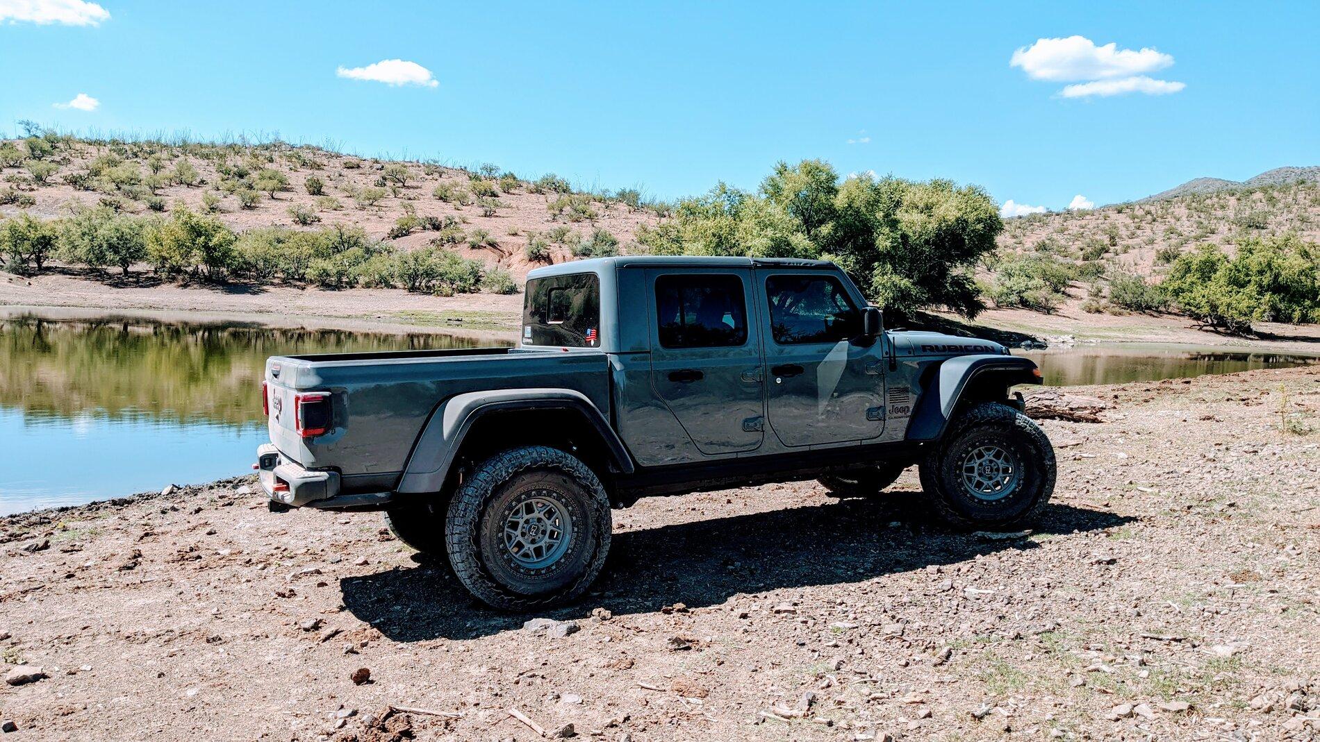

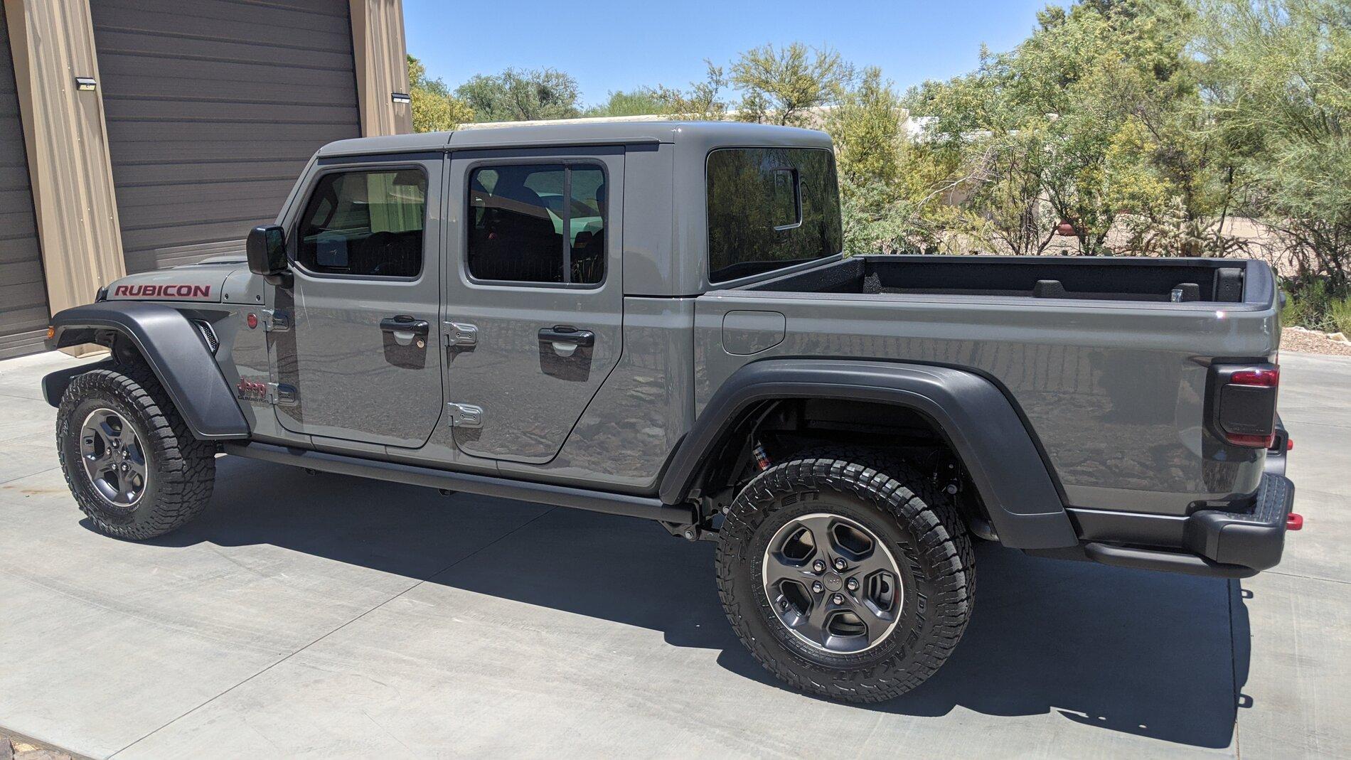

About two years ago I was going to purchase my "dream car" a C8 Corvette but when it came down to pulling the trigger I just couldn't do it. Having owned Jeeps in the past I decided to get something I would actually use...I wanted an ADULT STOMPER (Those who grew up in the 70's-80's will know what I'm talking about) My 2020 JT Rubicon:
Jeep Gladiator Midlife Crisis? Hemi Conversion IMG_20200522_124958

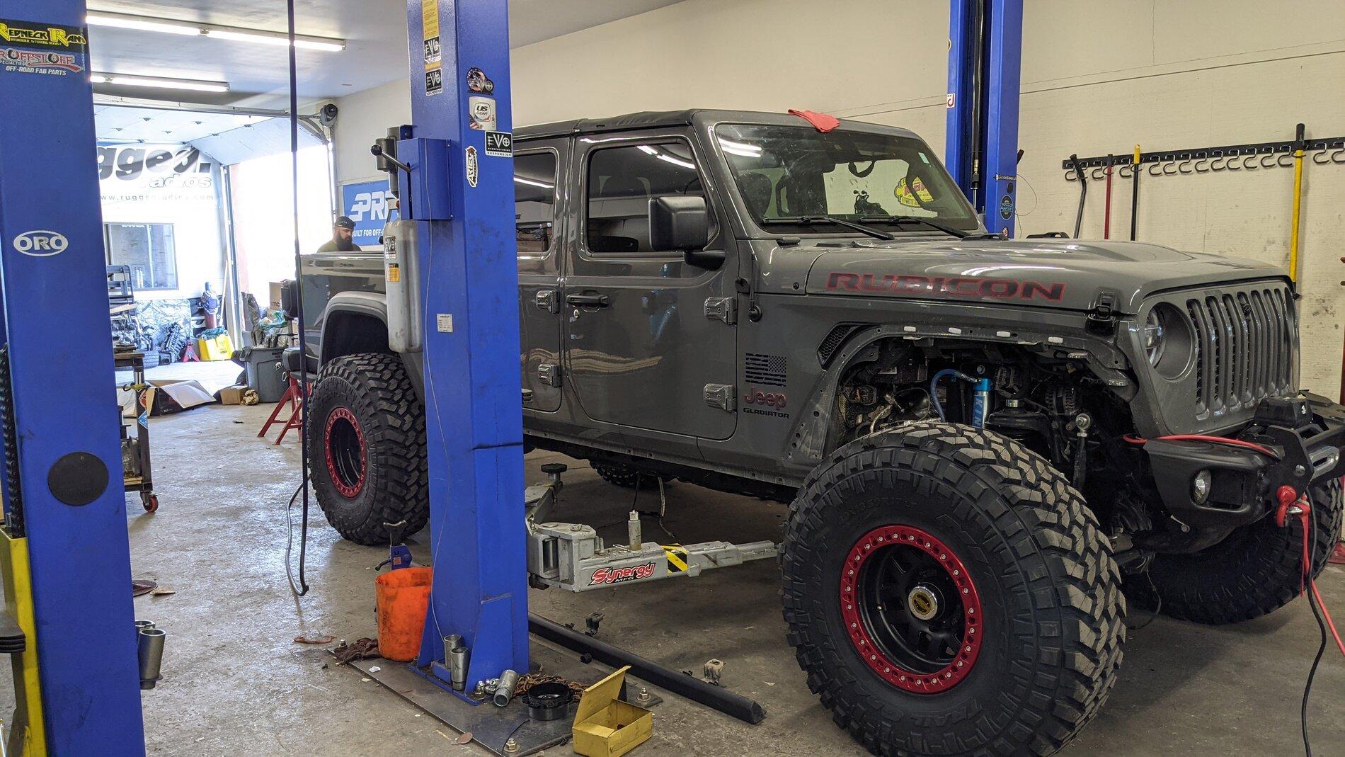

From day one I realized it didn't have the power to make me smile but it got me out and in the mountains again. So I started with the mods.. first was installing a Rock Krawler Lift and some 37's:
Jeep Gladiator Midlife Crisis? Hemi Conversion IMG_20200715_173337
Jeep Gladiator Midlife Crisis? Hemi Conversion IMG_20200726_095149_2

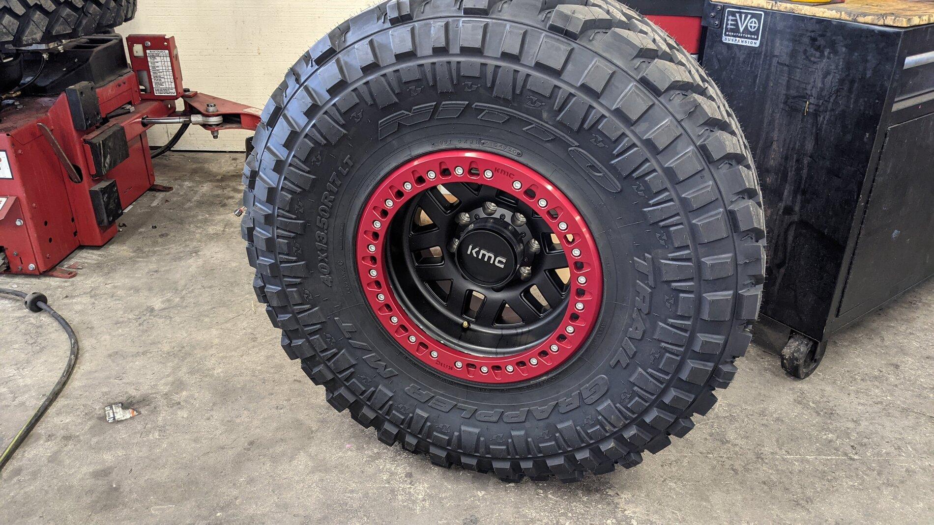

While adding the lift and tires made a huge difference in the off-road abilities but the power was still anemic. Even though 99.9% of my usage of this vehicle is off road I wanted to fill the void that I felt going to a from the trail. Superchargers looked tempting but as any red blooded American knows there is no replacement for displacement. After a bunch of research I decided to do a hemi swap and began to shop around. After talking with @JTPatriot on here in March I decided to talk to Bubba at Exodus 4x4 and was sold. After speaking with Bubba, and looking at several options I opted for the following build:
6.4 Hemi
Dana 60's
Adams Driveshafts F/R
KMC 8 Lug Wheels
40" Trail Grapplers
Synergy Steering
PSC Hydraulic Assist
4.5" Lift Springs

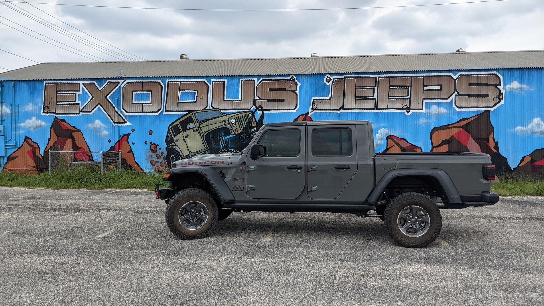

Which leads me to this weekend. I threw on the factory wheels and tires and headed East to TX. Stopped in Fort Stockton for the evening last night and met another Gladiator owner from Arkansas who had a very good choice in color.
Jeep Gladiator Midlife Crisis? Hemi Conversion PXL_20210509_144659642
And after 1.5 days of driving I've arrived

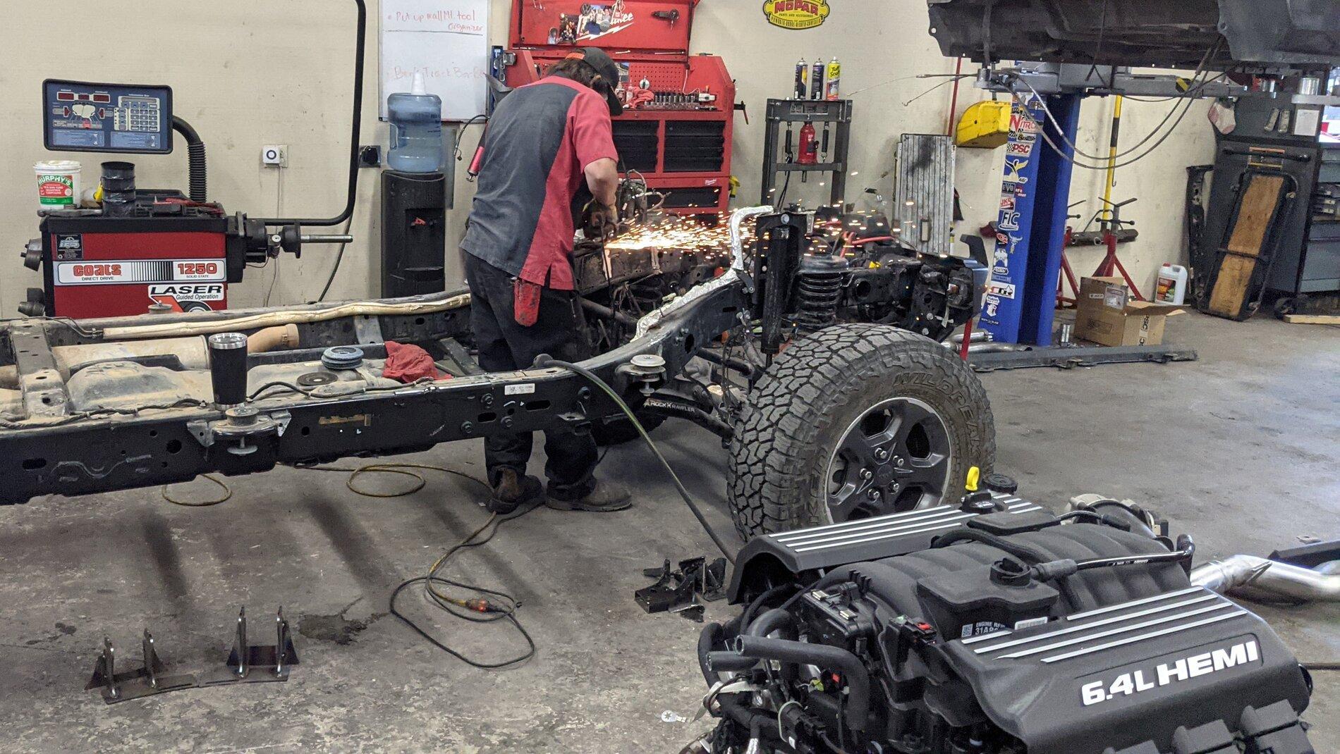

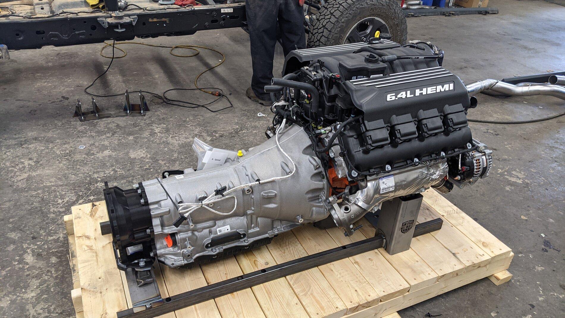

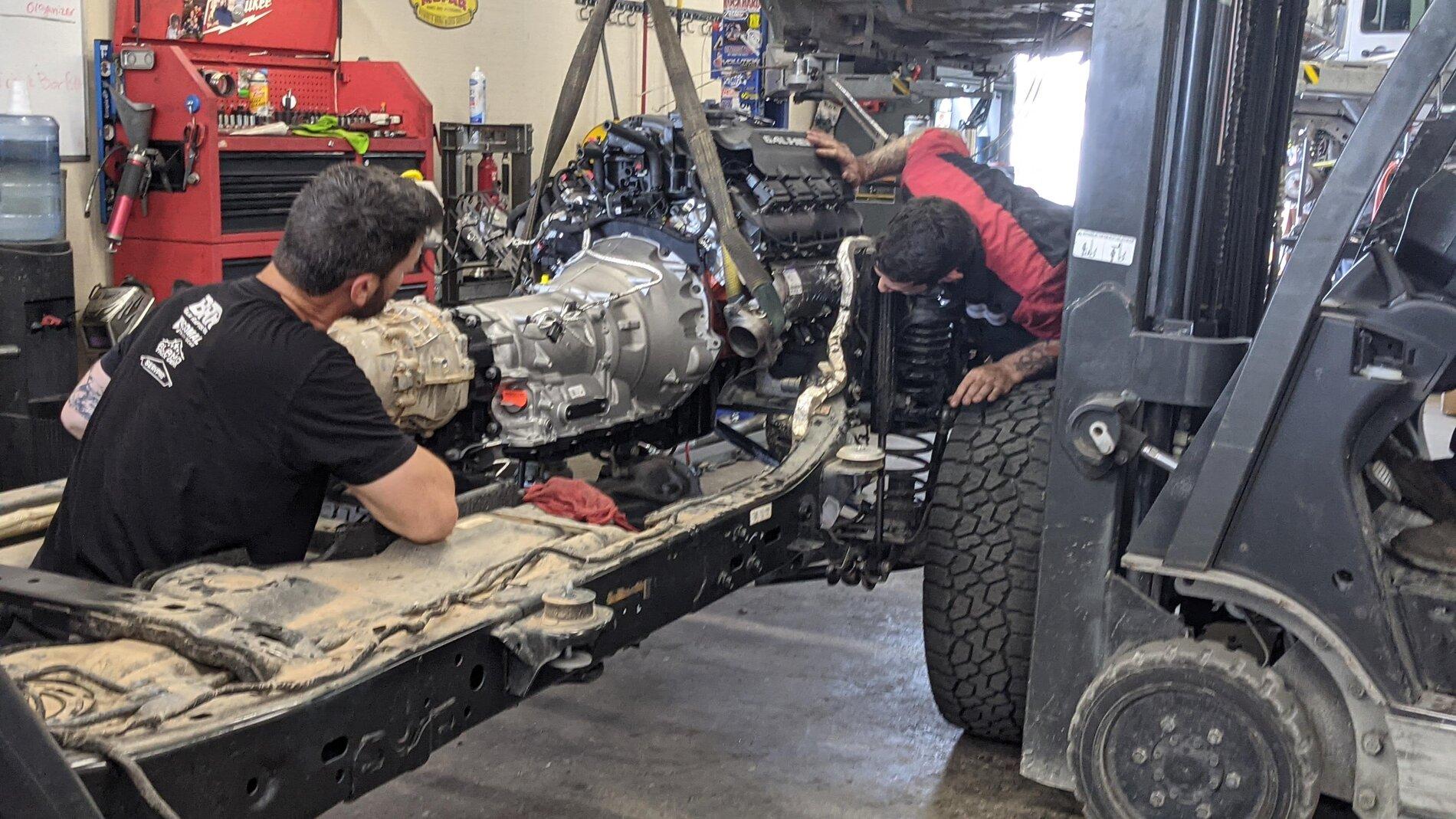

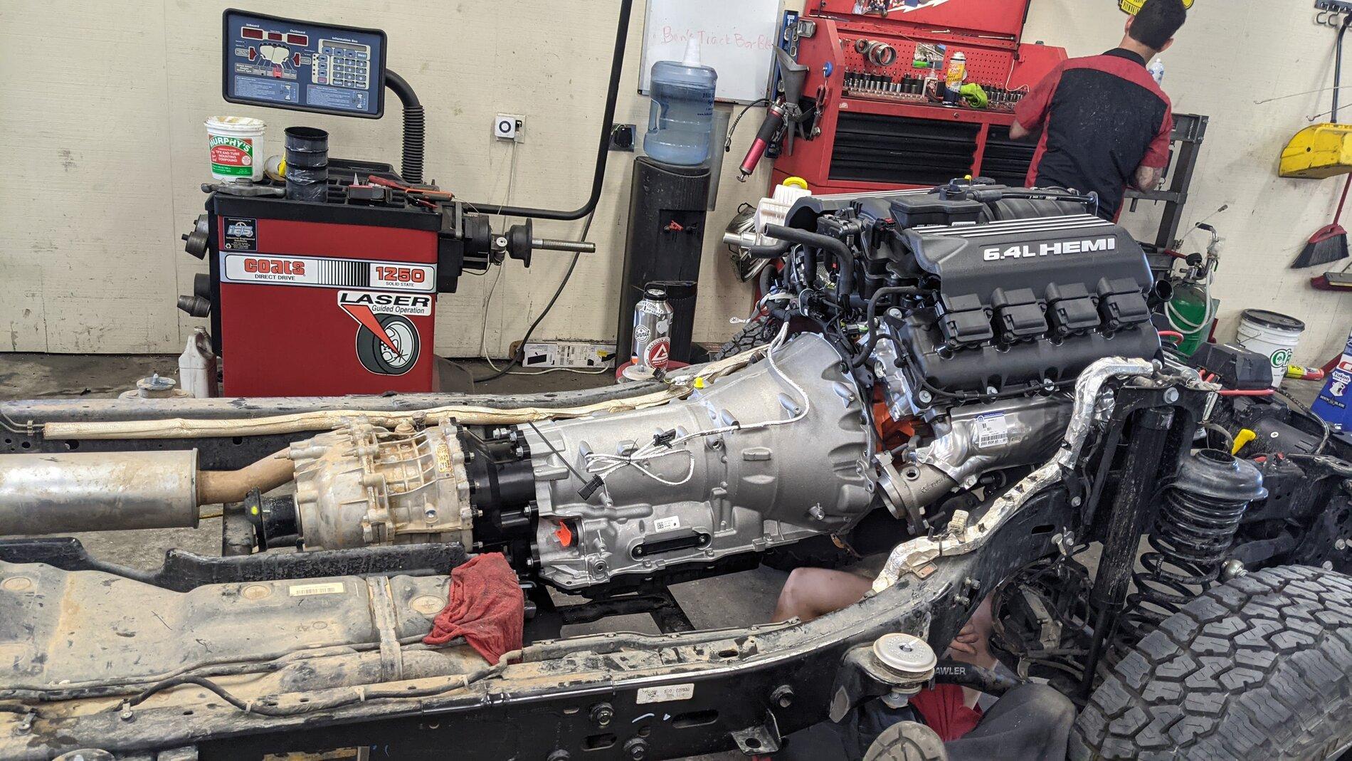

Trying not to hover too much I know how much I enjoy it when customers are watching me while working on their stuff but I had to be there as much as I could today again. :CWL: Today I finally got to see the main event...That big beautiful 6.4 Hemi in all its glory.
Jeep Gladiator Midlife Crisis? Hemi Conversion PXL_20210511_141347220
A little fab work before burning the new motor mounts in place.
Jeep Gladiator Midlife Crisis? Hemi Conversion PXL_20210511_142457787

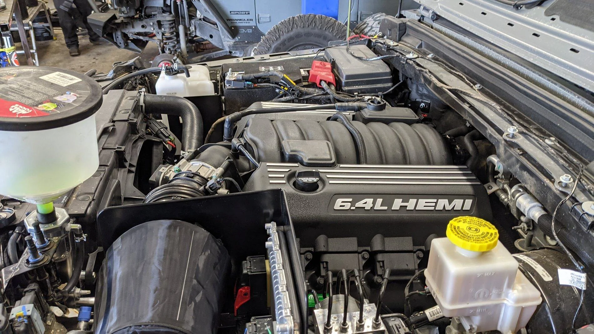

A little maneuvering to drop the hemi in place.
Jeep Gladiator Midlife Crisis? Hemi Conversion PXL_20210511_200007482.PORTRAIT
And its in its new home
Jeep Gladiator Midlife Crisis? Hemi Conversion PXL_20210511_200758488.MP
Tomorrow they will be setting the cab back on before moving on to the axles. Hopefully the boys at AMW4X4 turn my ECU around quick so they can fire it off before the end of the week. Going to "try" not to hover too much but I will be dropping in to snap a few photos so I can continue to document the build.

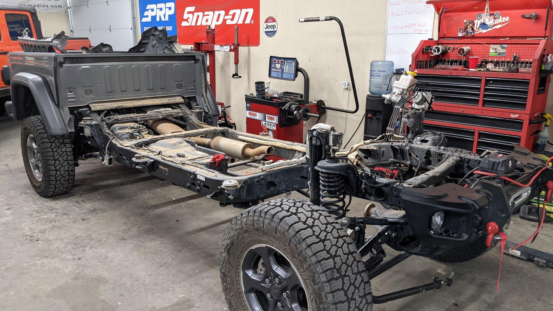

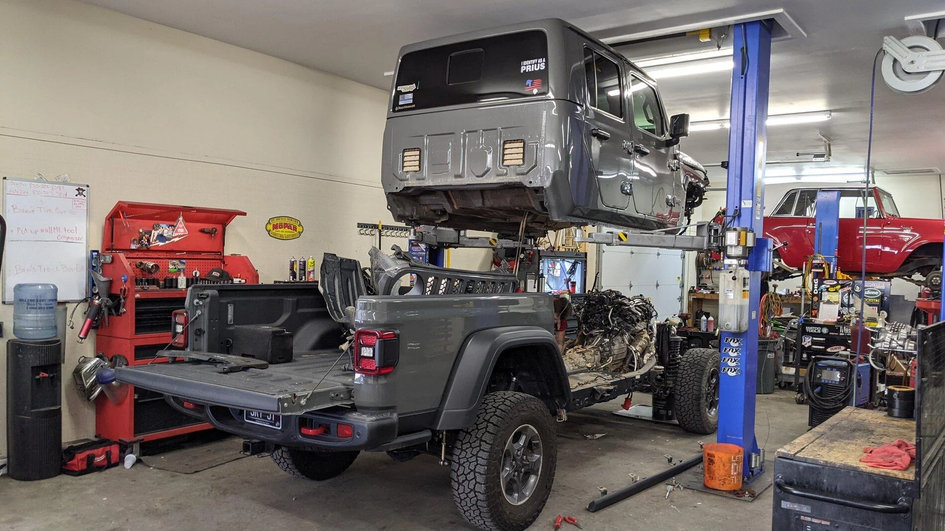

Yesterday was a day of putting things back together. After getting the cab back on Blake started buttoning things back up.
Jeep Gladiator Midlife Crisis? Hemi Conversion PXL_20210513_170145101.MP
Then it was time for the first fire which is always nerve racking. Only Idle for now unfortunately. Click here for youtube video

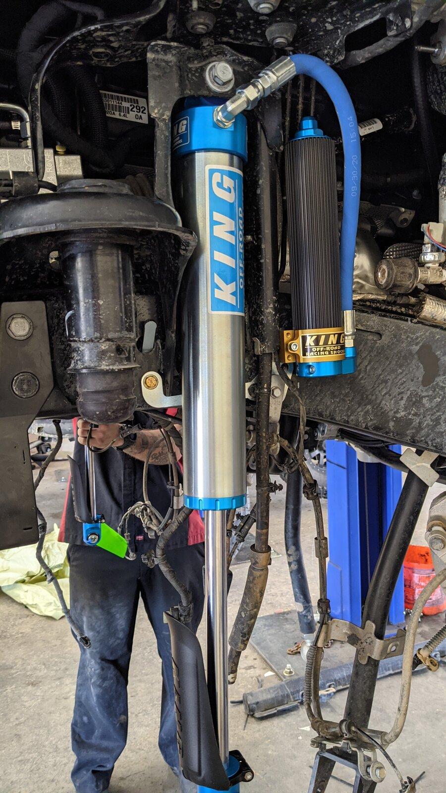

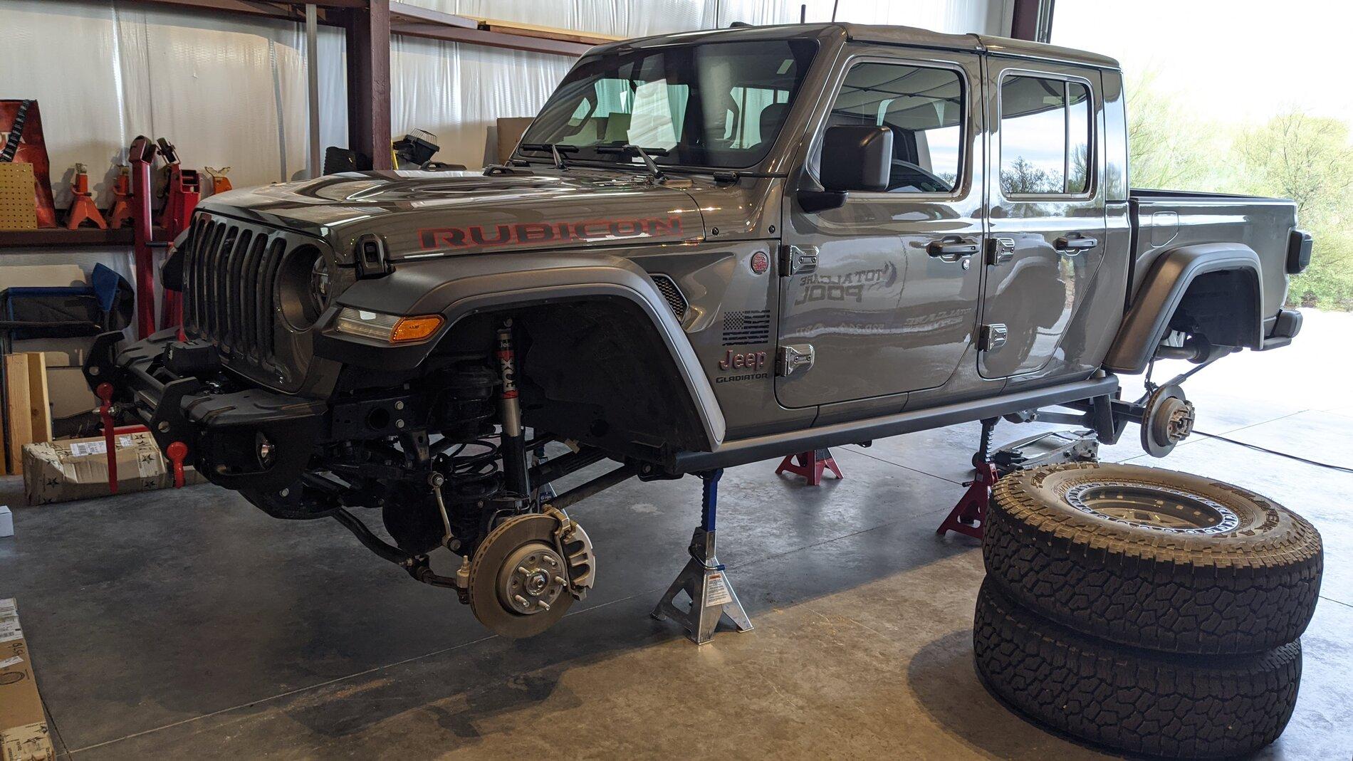

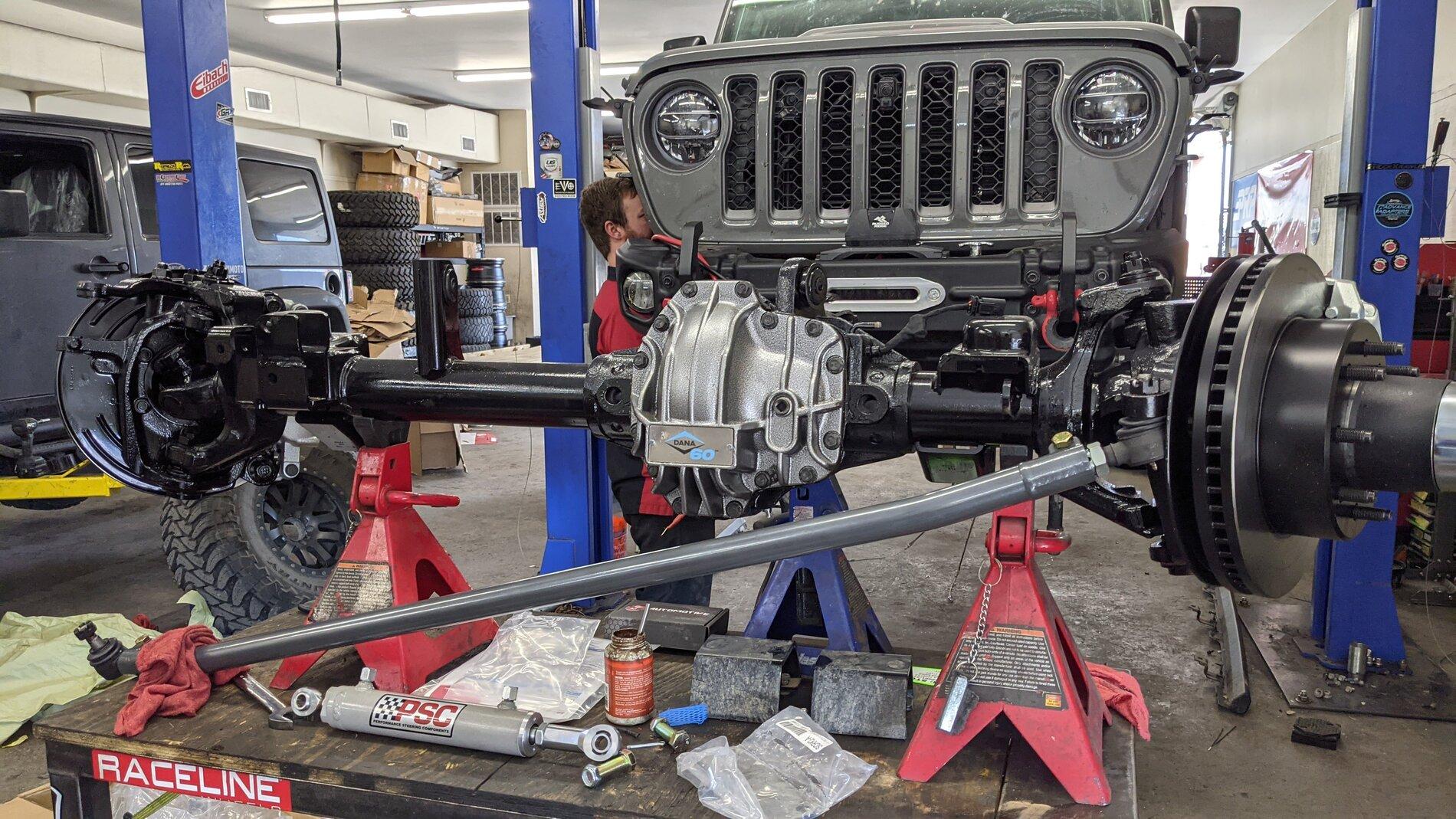

Today its all about the axles and suspension.
Jeep Gladiator Midlife Crisis? Hemi Conversion PXL_20210514_143807246 (1)
Jeep Gladiator Midlife Crisis? Hemi Conversion PXL_20210514_143603754 (1)
Jeep Gladiator Midlife Crisis? Hemi Conversion PXL_20210513_221409272 (1)
Hopefully by this evening its back on the ground and ready for driveshafts. I'll keep snapping photos in the mean time!

Wells its back on all fours waiting for driveshafts and finishing up!
Jeep Gladiator Midlife Crisis? Hemi Conversion PXL_20210514_223705493
So I didn't dig all the way into the thread so what axles are you running? Dynatrac or Currie or ??
