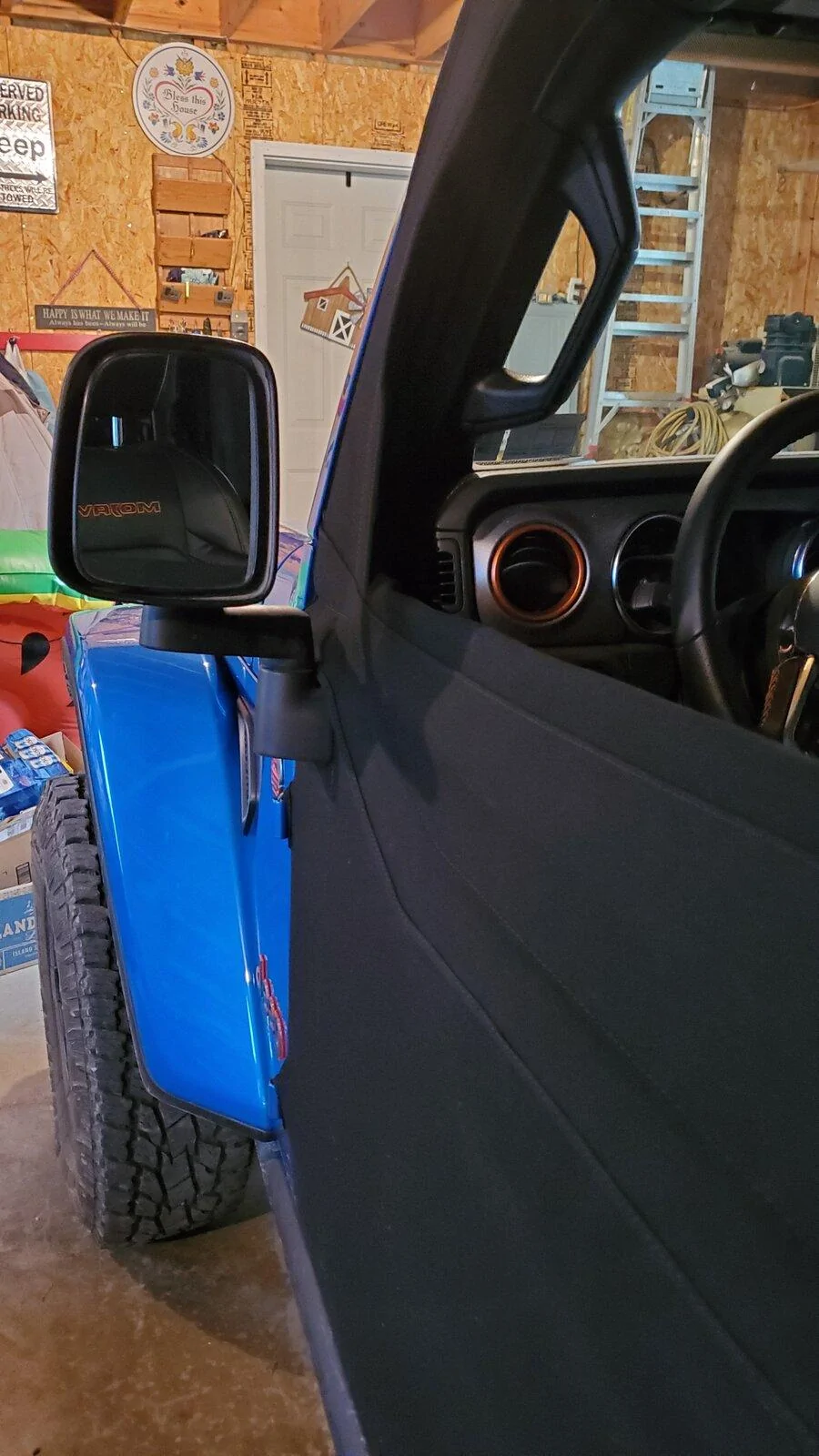

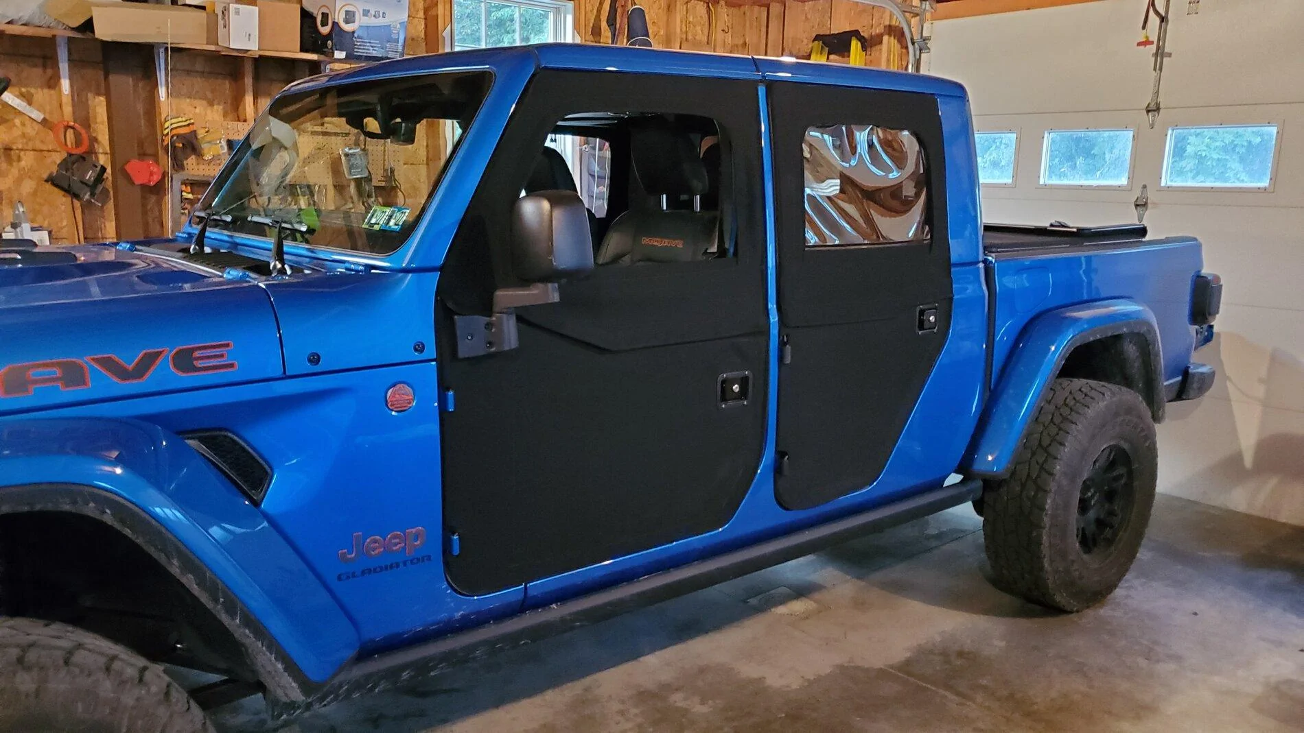

What soft doors do you have? I was struggling with the same problem. I have a set of American Outlaw mirrors that are great with doors completely off, but interfere with soft and / or tube doors since they mount over the hinge. I was concerned that any mirrors mounted to the windshield hinge or body bolts would interfere with opening the doors. Then I noticed that my Bestop soft lowers have a plate inside with predrilled holes that line up perfectly with most TJ -style mirrors, which I happened to have lying around. This is the result.

That looks pretty good. I could probably just remove the Lange mirrors when the door is on which is not very often any way. Do any TJ mirror will fit? There appear to be many out there including a Bestop one for $100.

Absolutely! There are basically 2 generations of TJ mirrors. The 97-02 version is metal (slotted) and weighs a bit on the soft door. The 03-06 version is plastic (solid) which is the best fit for the 2 piece soft doors.
